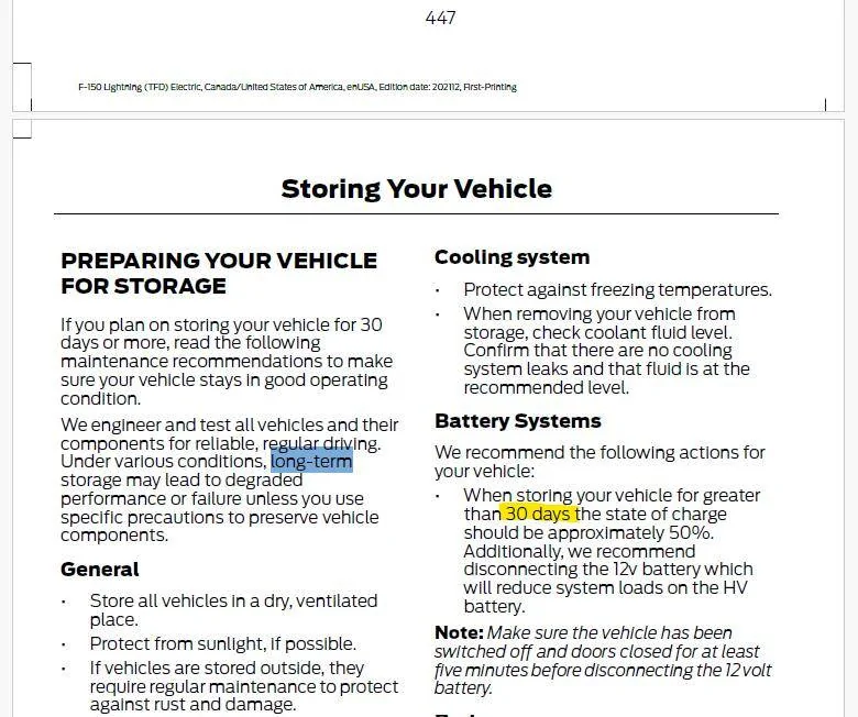

Per the manual, disconnect the the 12V battery when storing for longer than 30 days.

So I go to Georgia and Florida from my home in CA for 6 weeks. In preparation I leave my Lightning at 80% (yes, should have run it down to 50% but didn't have time) and set my 120v level one charger at 50% so, if somehow it drops it will never get below 50% as it would start charging again. Additionally I put an AGM trickle charger on the 12v battery downstream of the module as recommended. Well, 4 weeks into my trip, j
Long term is considered 30+ days.

OK, thanks....you're correct indeed. However, it's strange that the deep sleep started after just 2 weeks and, what the heck, we're "trying to reduce the loads on the HVB?" What loads? The LVB is fully charged and on trickle charge and the HVB is at 80% and plugged into a level 1 charger set to automatically charge the HVB if, somehow, its level drops below 50%. It seems odd that the app essentially locks me out under these conditions. Shouldn't the software be looking at actual voltages and conditions? Shouldn't the system just auto charge the LVB if necessary, but always save, say 20% of the HVB if conditions are extreme? I've never seen such a system where you need to disconnect the battery, and/or put it on a charger. I mean, if your LVB goes dead, you're dead in the water anyway....regardless of what the HVB is doing. JUST CHARGE THE LVB IF IT NEEDS IT! This shouldn't be so complicated. Sorry....I'm just used to better software.
