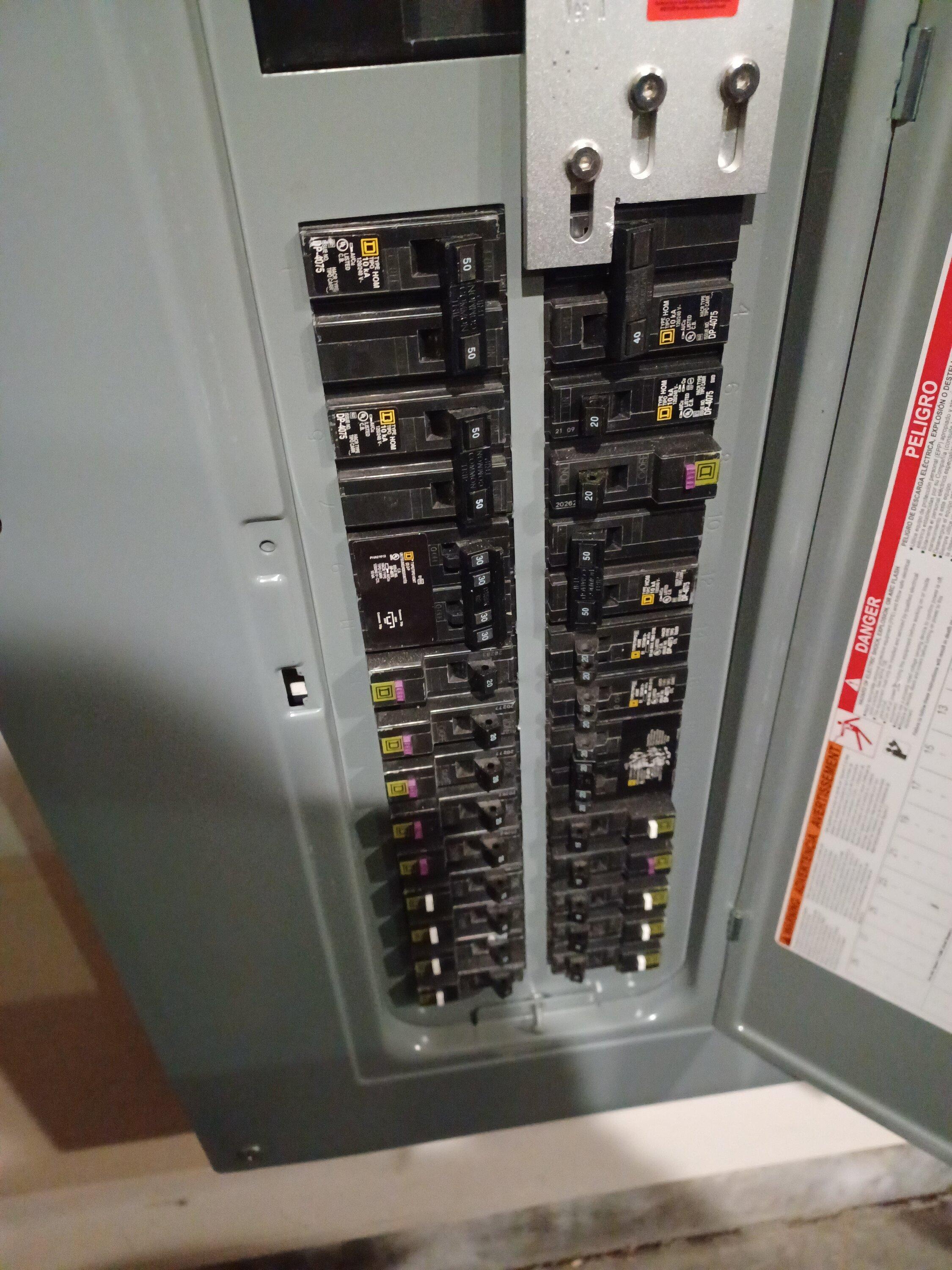

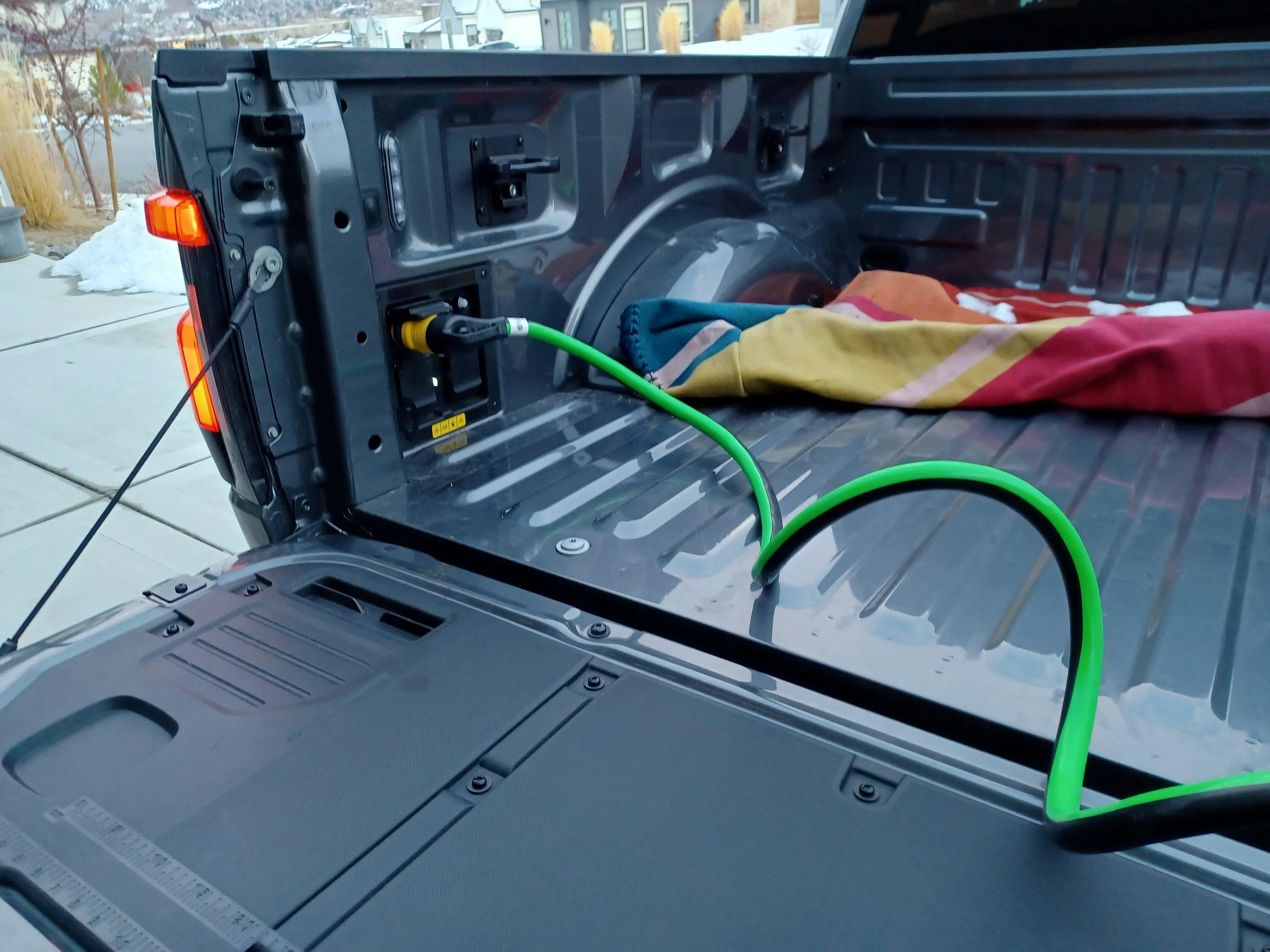

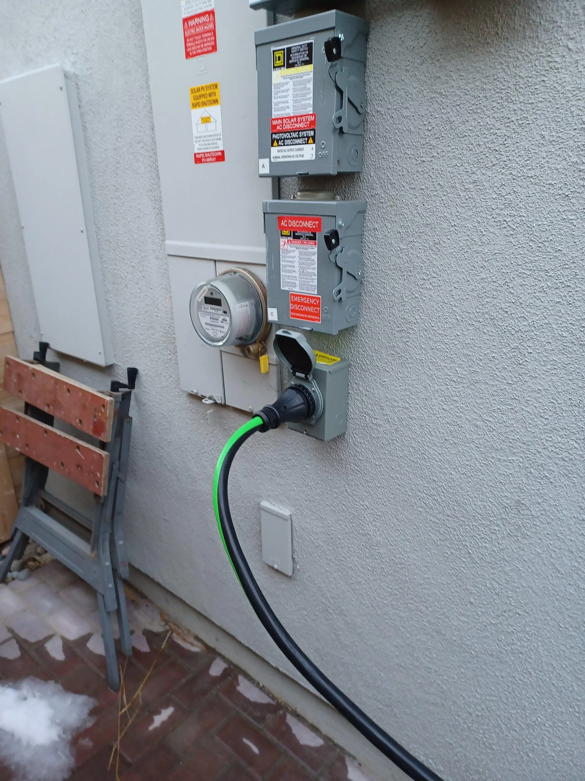

Hi all,
I just successfully tested my new home back up based on F150 Lightning. Works great.
I have a previously installed 19kW PV Solar system, Solaredge Inverters with Backup Interface feeding a whole house main panel that handles all circuits, except EV charging.
I implemented a whole home back up connected to F150 Lightning, based on:
1) external 50A generator input port (ground wire not connected)
2) 40A breaker in main panel, with standard lockout device to main breaker
3) additional 125A subpanel, with 125A breaker used to switch Neutral line from utility side on/off.
Total material cost approx $200, and another $75 for 50A extension cable to the truck.
I realize it may not be as automated as the HIS system or a single transfer switch, but it allows me to back up my whole main panel without moving any circuits, and it is lower overall cost, and no dealing with Sunrun etc...

Im not sure I’m following your whole setup, but you do not want to switch the house neutral AND remove the ground from the truck. You want one neutral-ground bond in your system and you want it to be at the service point ie the truck when in backup mode.

Alright, good point, will look into this. Should be easy to apply

This is not a recommended method of connection {dispensing with the ground between truck and generator input or input to main load center}.
There are other threads which deal with the safer way to implement a generator input to transfer switch that includes neutral switching.

For what it’s worth, I don’t think it’s unsafe to not bring over your equipment ground from the truck. You service doesn’t bring you a ground either, you make the ground at the house and then bond the neutral. Treat your car as the utility and it’s the same thing, and its built in ground loop will clear its faults. This method is not code legal though which is also important.

Thanks guys. really appreciate your perspectives. I can implement either option, always good to stick with the rule book
