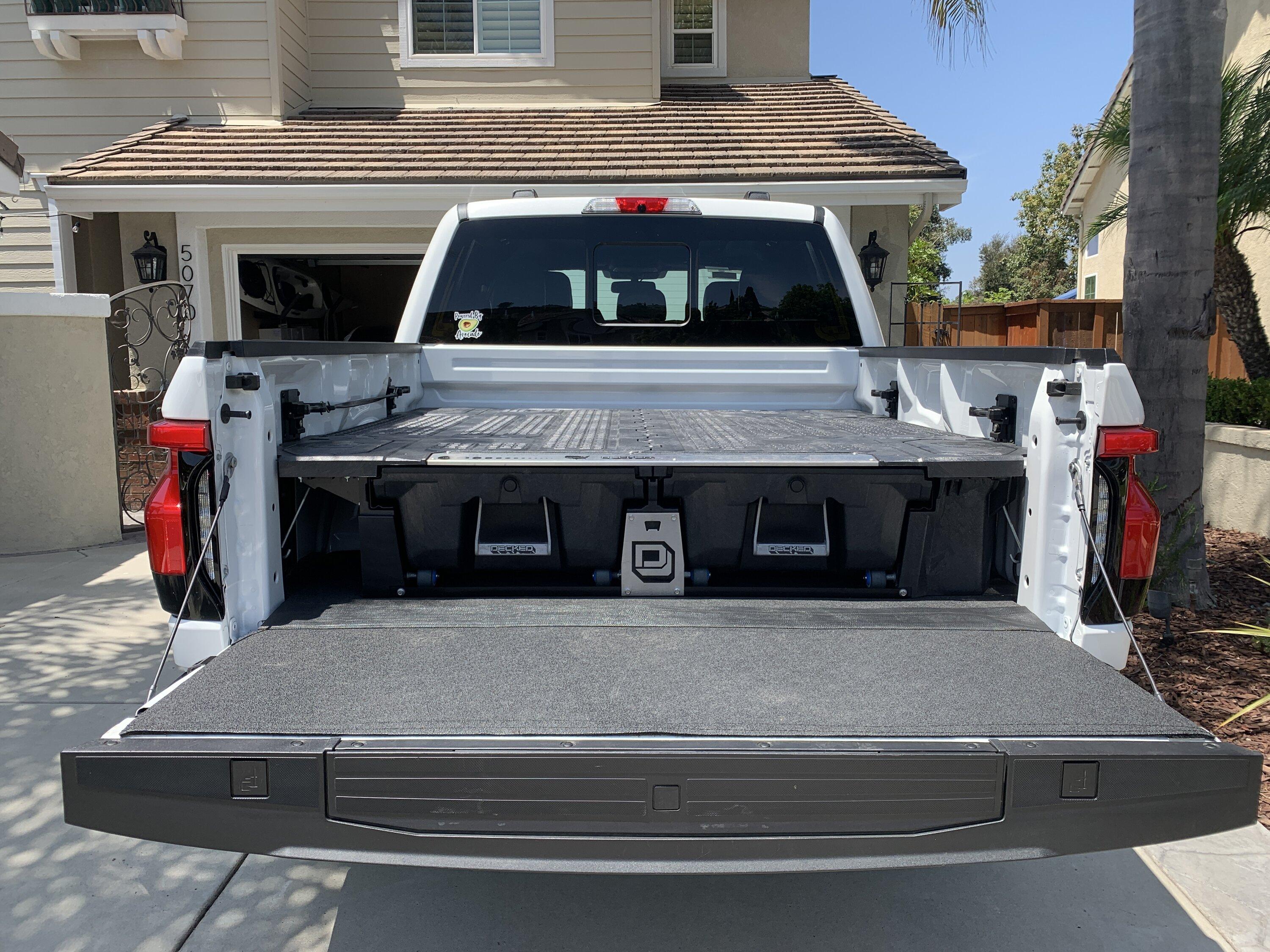

I’ve had these in for a week and am very happy with them.
Ford F-150 Lightning 🙋‍♂️ What Did You Do To Your Lightning Today? F9D9F993-3BAD-4E91-98FD-0FE2CF02DDE9
Ford F-150 Lightning 🙋‍♂️ What Did You Do To Your Lightning Today? FEC8182A-6FA3-4A22-A32B-BF4EC3F412C1
