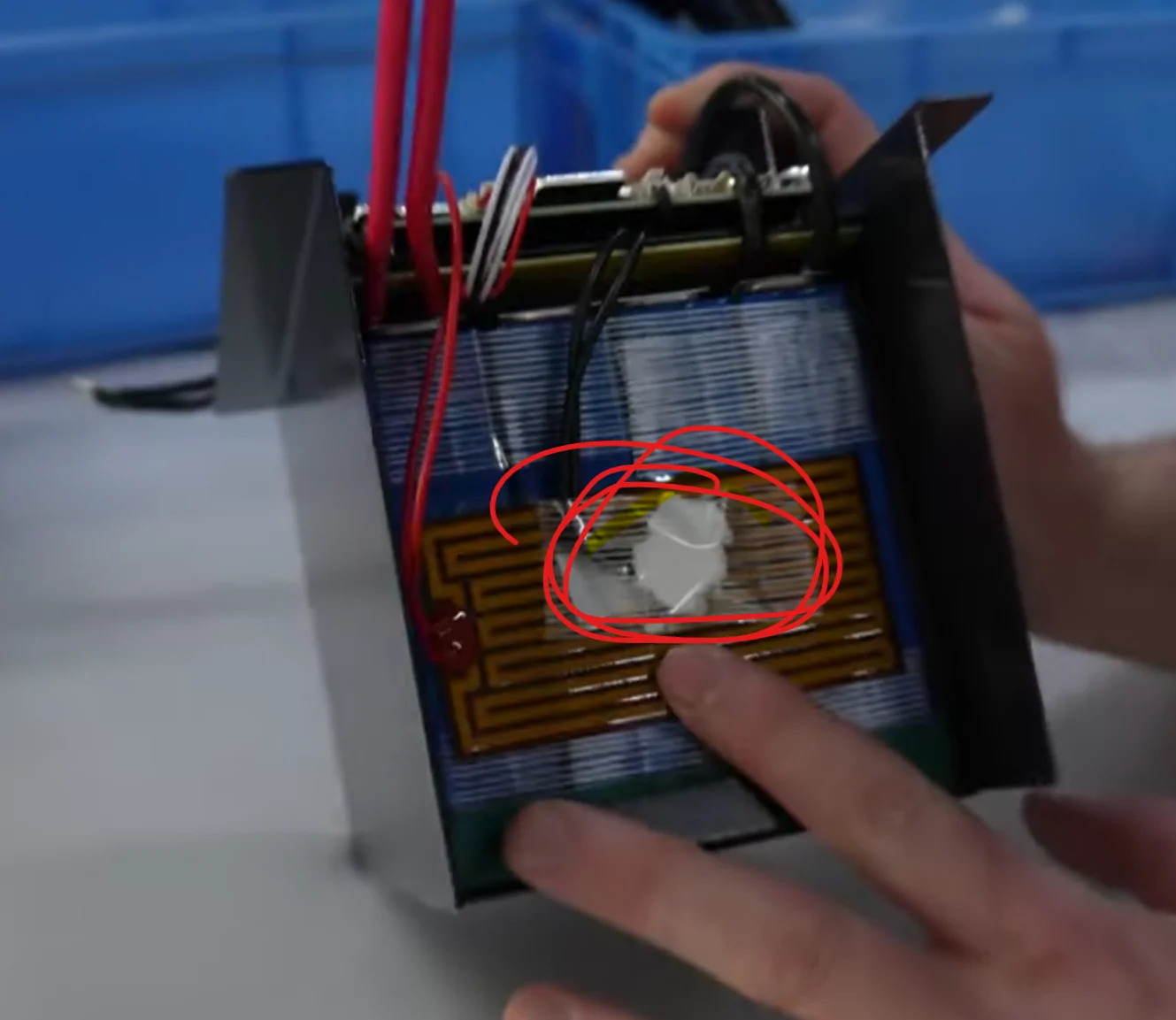

So, I've been sceptical about Ohmmu for a while, primarily because people are "too happy" about it, and everytime there's something negative said about it it's the same people is coming to it's rescue / defences - why ? - I mean, if it works for you, great, but why do you feel the need to defend a company that you're not affilliated with, time and time again ?
Early versions were garbage:
Supposedly they've addressed a lot of the issues, but I just watched the "How Ohmmus are built video" and....
How are they built:
The modules appear to be these:
https://www.lifepo4-battery.com/Products/LiFePO4-Battery-Cell/gotion-40ah-lifepo4-battery-cell.html
The BMS is this:
https://jiabaida-bms.com/products/j...-or-switch-function-support-series-connection
One thing that stands out is that while they're talking about the heater, it seems like they're putting the temperature sensor on the heating element itself which seems pretty darn dumb.
And why is the element at the end and not between the cells / modules.
So, my personal opinion remains, Ohmmu (lithium based) might work in warm(non freezing climates) but I would stay away from them if you live in colder climates.

I'm by no means an expert, all I know is that charging Lithium batteries in cold weather is a big no-no as it can result in lithium plating and will essentially destroy the battery.
So, some manufacturers put a temp sensor on the battery to prevent it from being charged when it's cold out, great, the battery won't be damaged, but it won't charge either, so eventually you'll run out of juice. (This is what Ohmmu did early on)
The next upgrade is to put a heater in/on the battery.
In the Lightning they heat the coolant/fluid that circulates through the pack so the packs are evenly heated (and cooled).
In the case of Ohmmu it looks like they slapped a resistive element on the end, which is bad to begin with as it won't heat it evenly, maybe, just maybe, do they have heating elements on all four sides and inbetween the cells, and in that case I suppose it isn't so bad, but I'm kind of sceptical that they do.
What's worse is that it looks like they placed the temp-probe onto the heater itself, so the sensor will heat up much faster than the actual pack, enabling charging too soon / when the pack is still cold.
This video shows the issue (it's not an Ohmmu battery by the looks of things, but the construction is similar).
