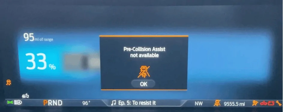

I had a really strange error occur yesterday with my Lightning and was curious if anyone else has run into this.
Prior to leaving work yesterday, I started my truck using the FordPass app about 10-15 minutes ahead of time to pre-condition, which is what I do every day. When I got in the truck and tried to start it, a whole cluster of error messages and pings started going off and the truck would not start. "Stop safely now", "Service AdvanceTrac" & Pre-Collision Assist not available" all flashed on the screen while the truck wasn't moving. The truck would only go into accessory mode.
I turned it off and tried to start the truck again 2-3 more times with the same issue and was convinced I was going to have to call the dealership and get it towed. Fortunately, on my last attempt, the truck started, and no errors or pings.

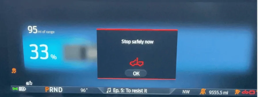

I took a video and recorded the errors because I thought I was going to need to send it to the dealership when they tried to troubleshoot the issue. I provided some screenshots below of the errors that popped up consecutively one after another until eventually, the truck started.

Any chance the truck was in the middle of an OTA?

It wasn't. I have my OTA's scheduled to take place overnight.

Sounds like marginal voltage on the 12 volts battery.....
On my wife's Toyota Highlander hybrid when the 12 volts battery is starting to get weak all sorts of alarms start to show up on the dash like traction control issues, braking and airbag alarm issues; and when the voltage gets around 10.7 volts the entire dash lights up with all the possible alarms...
Temporary solution not to get stranded buy one of the these TYPE S Portable Jump Starter & Power Bank with Emergency Multimode Floodlight to allow a normal start of all the onboard computers and then the internal DC-DC converter for the 12 volts will take over charging the 12 volts battery ( booster pack can be then disconnected); this should allow you to drive home with no issue.
If the 12 volts battery doesn't hold the charge you will have to get a replacement for it.

My truck won’t start. I had the same multiple dash warnings and audio alerts on my truck this am. Dealer told me to try remote start on ford app. 4 times all failed. Sent video of alerts to local dealer and they have not seen this issue. Said to schedule service for next week and will have to flat bed truck to them. Weekend without my truck is unacceptable given it’s a lariat with 11k miles on it!!

I had a similar experience, last September, same multiple dash warnings, would not drive. I turned the car off, left it for a day, next day it was fine. This was after a long road trip where the battery got down to 10% (first time ever for that). Talking to the dealer (after it started again), they indicated to make an appointment, I needed recall stuff done anyway. Then, in early November, a few weeks before my scheduled appointment, it happened again... and the car has been dead to this day. At least I was lucky enough to have it fail at home. I had it towed to the dealer (I had to help arrange the tow, as Ford Roadside was unable to find a towing service for me until I made some calls for them), it has been at the dealer since, and they cannot even connect to the PCM to clear the codes (they said it threw 140 codes). They are waiting to hear from Ford how to proceed. 25 days without a truck, no diagnosis yet, no loaners available, no help on rental cars. I love the truck when it runs, but this is so far the worst vehicle experience I've had in 45 years.

Turned out to be rodent damage for mine. A few wires were chewed through. Took the dealer 3 months to figure it out, the fix was a few hours, no parts. Hope you have a better experience than I did with your dealer! Truck works fine now, fortunately, so I'm enjoying it again. I do wish that a vehicle that is destined to spend a lot of time outside was designed to be more outside-proof.

Well I hooked up my battery charger to the truck and everything came on like it should. SO it definitely a problem with the 12v battery.
