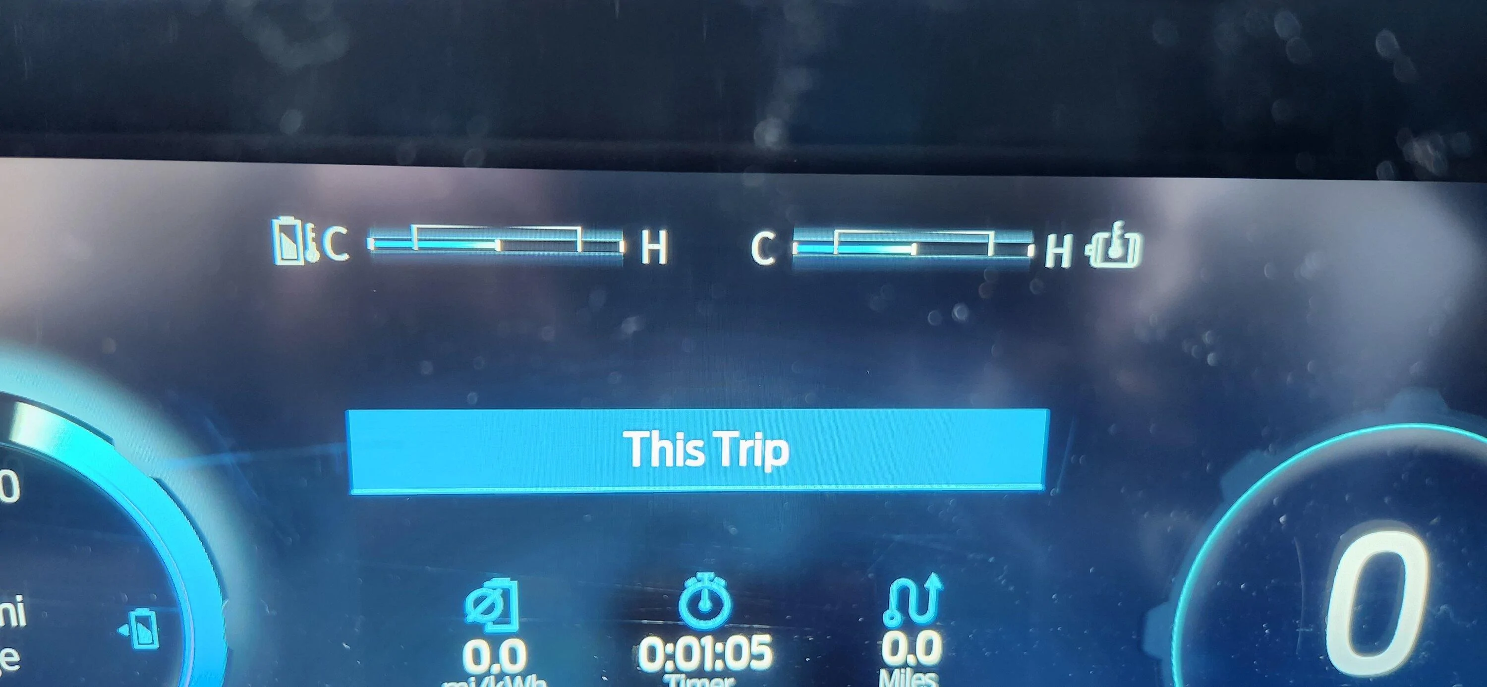

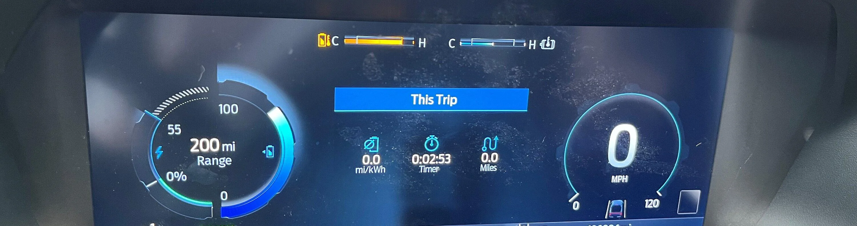

It does indeed move. This was on the return leg of a road trip after the third stop to fast charge and the temperatures that day got into the 80s. It also went up, although not quite as high, after the fourth fast charge that day.
Ford F-150 Lightning Battery and Motor Temperature Dashboard Display Always at Midpoint Lightning Battery Temp (2)

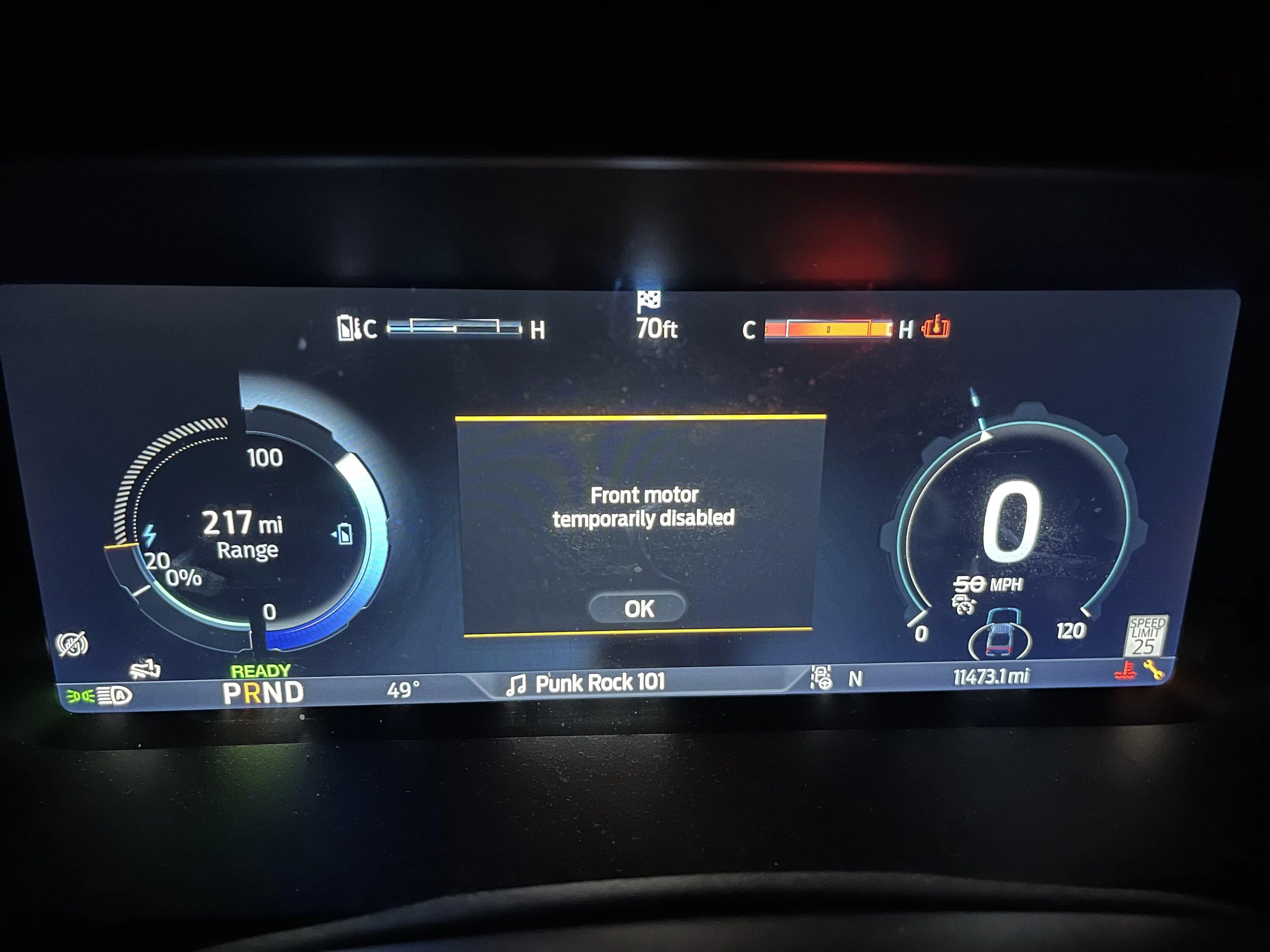

I previously posted a picture with the battery temperature gauge high after a fast charging session. Below is a picture of the motor temperature gauge high due to a leak in the coolant system.
Ford F-150 Lightning Battery and Motor Temperature Dashboard Display Always at Midpoint Image (5)
