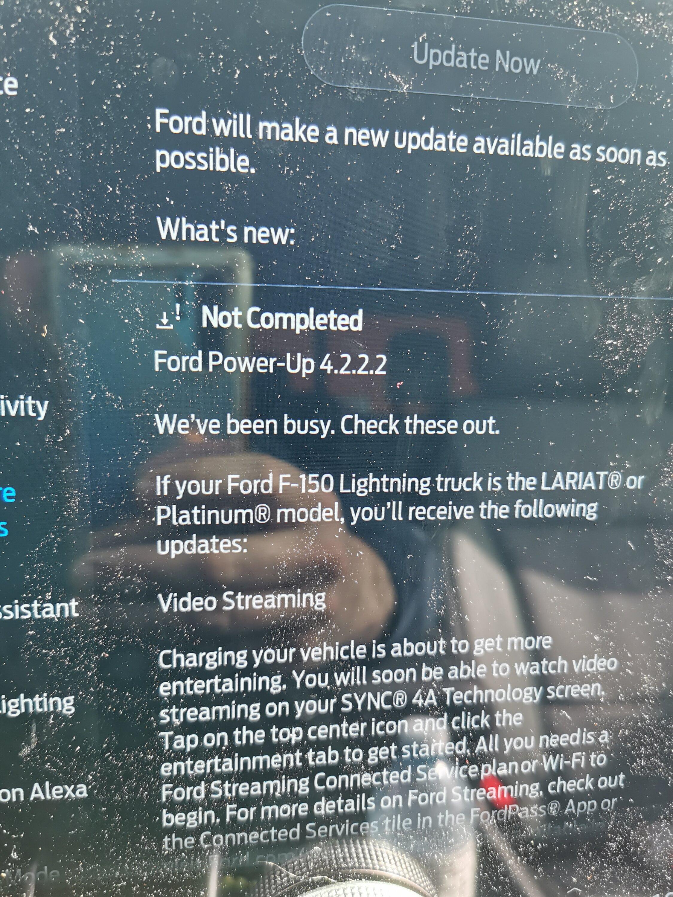

I just received the 4.2.2.2 ui update last week and it was completed. Looked today in the truck and saw this:
Ford F-150 Lightning Bonkers Fordpass charging and precon shenanigans IMG_20230425_101353
But it quickly changed to completed again.
What'd you clean your screen with? Parmesan cheese?
LOL, this is an every day truck. The sand and dust blowing around this time of year is near impossible to stay on top of. The camera makes it look worse than it is though, I detailed on Sunday.
