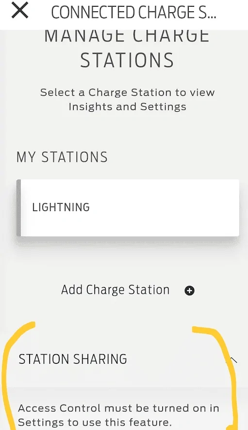

I haven’t completed the installation of my FCSP yet, but can’t it be locked/unlocked in the app? My Ford Connected Charge Station has that capability.
NO, The FP alludes to a SETTINGS feature but it does not exist on that screen.

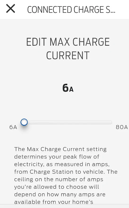

No idea on that charger, but any charger that allows you to set the charge rate would allow you to set it to 0. And track usage.
6 amps is the lowest I can set the FCSP, slow enough to make it a negligible cost even at California rates. In my electric market 25.8c/kWh, it comes to $8.92 a day
Haven't played around with our JuiceBoxes, but I can set the time of charging (as I have) and make it one minute long. That alone would prevent charging.
