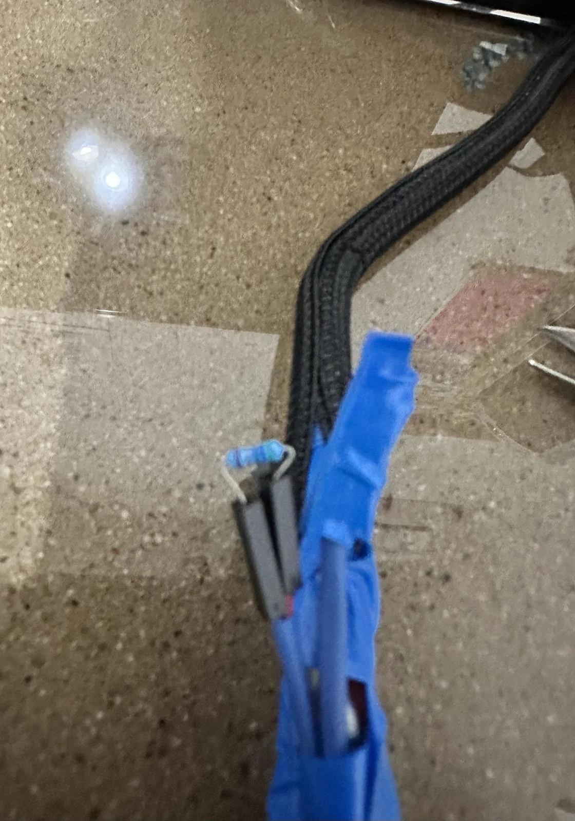

I'm joining the fun. With the current sale ($200 off) I picked up a unit. I'm going to be getting a custom harness made so I don't get any of the error codes.

I'll post the usb cable that worked for me. You also need a 6 inch cat5 patch cable. Any will due. Keep in mind. Once the bugs are worked out with the modified q4 harness we will not need the usb cable. The supplied cables should work. I don't have any idea when but it should be soon.

There is somone on 14gen forum that can make them. I can too as soon as my hand heals

For the harness, @Ajzride from the 14th gen forum is helping.
Comma is currently not modding the harness.
SunnyPilot is the best fork for our vehicles currently.

Not sure if I have an account here, or if it just shares with Gen14 forum.
Attached is the getting started guide for SunnyPilot.
Modifying the harness isn't hard. There are only 12 wires that need to run from the IPMA to the rearview mirror:
Camera CAN0 High
Camera CAN0 Low
Camera CAN1 High
Camera CAN12 Low
Camera Ignition
Camera Ground
Truck CAN0 High
Truck CAN0 Low
Truck CAN1 High
Truck CAN12 Low
Truck Ignition
Truck Ground
All of the other cables need to be cut and jumpered together at the harness.
When you extend the wires for Camera CAN0 H/L, please a 60 ohm resistor across them. Same for Camera CAN1 H/L.
The cabin environment is not as brutal as the engine compartment, so I used solder-seal devices for making the connections between the cut wires and the extenders.
https://www.amazon.com/gp/product/B0BM49F4FQ/ref=ppx_yo_dt_b_asin_title_o02_s02?ie=UTF8&psc=1
