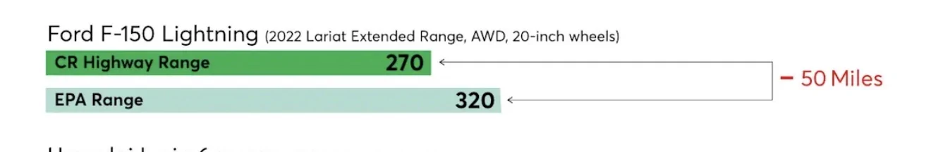

The EPA has a specific test procedure that all manufacturers use to rate mileage. CR uses a completely different method and acts surprised when they get a different result.

Probably not a surprise to anyone here. Consumer Reports finds the Lightning range is 270mi vs the EPA rated 320mi when traveling at highway speeds (70mph, 2022 extended range lariat).
The EPA needs to rethink their test procedures. It doesn't make sense for EVs.
The EPA test cycle works great for ICE cars, because they get better mileage at high speeds. When you average slow-speed and high-speed mileage, you end up with a value that can be beaten by people driving at highway speeds.
For EVs, it's terrible. EVs get worse mileage the faster you go. The EPA test averages in a lot of lower-speed driving in the test cycle, which "inflates" the mileage number, giving people information which isn't very useful when you try to apply it to road trips and highway driving.
The EPA should ditch the "test cycle", and just give a number like "range at 75 mph" (or pick whatever speed you think is useful). Bonus points if you also force each manufacturer to publish a "range vs speed" chart. That would be MUCH more useful than the current test.

My chevy bolt is pretty close to higher than epa. The Lightining is usually lower. I think the difference is how easily you can lower the range with a large vehicle.

Yes, 260-270 coming from 100% is about right in ideal hi way conditions.
But the 320 was a combined hi-way and side streets measure. That is also doable in the right conditions. 70mph hi-way and 50-55 on side roads.

The EPA range tests were of course designed for a paper-based information age. Therefore, the information had to be presented in a static view. Nothing wrong with that... yet today with small computers in every pocket, the EPA and similar objective test bodies can also present a dynamic data "slide Your graph scale" to present the consumer a richer, more meaningful result of the such tests.
