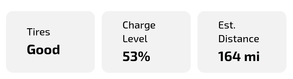

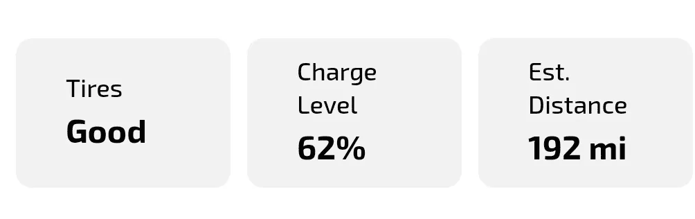

Since the BMS replacement I have taken two ~20 mile errand trips. I found LV SOC at 91% and 90% after trip completion. I have never seen LV SOC that high before. The new BMS is definitely resulting in better LV charging and higher SOC.
Dumb question: are these screenshots table from the FordPass app?

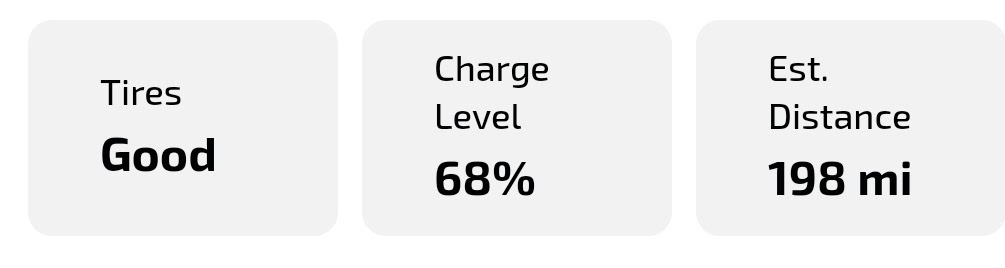

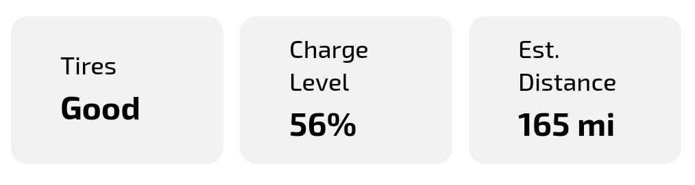

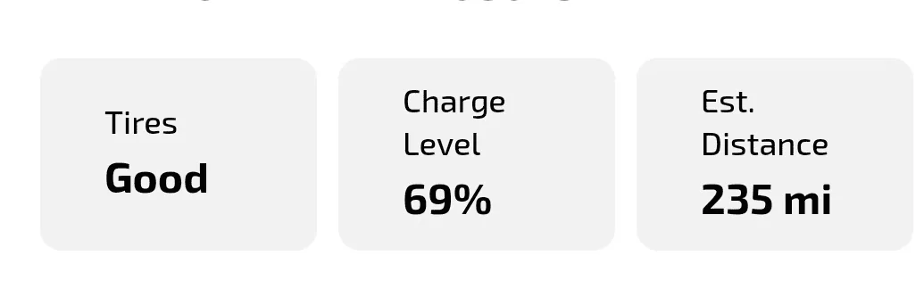

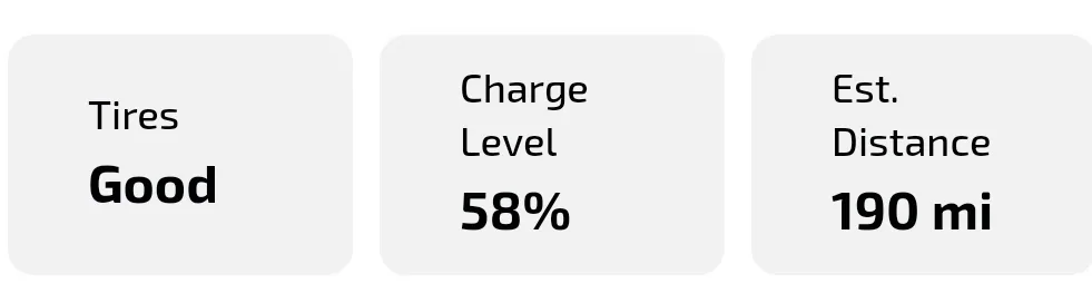

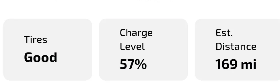

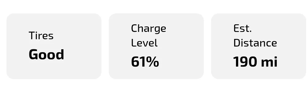

Updates on recent performance, the truck sat for some time Sunday evening through Monday evening ~23 hours
1/21 @8pm
Ford F-150 Lightning CSP-23B70 Certain 2022-23 F-150 Lightnings - BMS Sensor Replacement 1706020600693
1/22 @7am
Ford F-150 Lightning CSP-23B70 Certain 2022-23 F-150 Lightnings - BMS Sensor Replacement 1706020665231
1/22 @ 10am
Ford F-150 Lightning CSP-23B70 Certain 2022-23 F-150 Lightnings - BMS Sensor Replacement 1706020689251
1/22 @ 12pm
Ford F-150 Lightning CSP-23B70 Certain 2022-23 F-150 Lightnings - BMS Sensor Replacement 1706020723569
1/22 @ 7pm
Ford F-150 Lightning CSP-23B70 Certain 2022-23 F-150 Lightnings - BMS Sensor Replacement 1706020760421
1/22 after driving to/from coffee meeting @ 9pm
Ford F-150 Lightning CSP-23B70 Certain 2022-23 F-150 Lightnings - BMS Sensor Replacement 1706020808621
1/23 @ 5:50 am
Ford F-150 Lightning CSP-23B70 Certain 2022-23 F-150 Lightnings - BMS Sensor Replacement 1706020836645
1/23 @ 7:25 am, after completing a HVB 71 to 85% charging session @18KW
Ford F-150 Lightning CSP-23B70 Certain 2022-23 F-150 Lightnings - BMS Sensor Replacement 1706020946300
