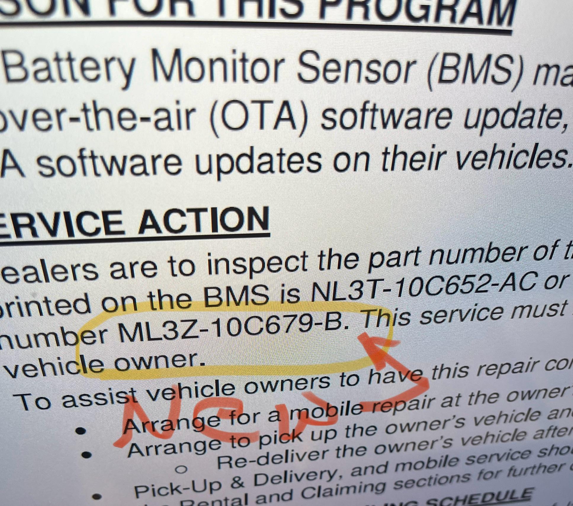

Mobile service came out. Just did both our trucks and done in 10 minutes (y)
Ford F-150 Lightning CSP-23B70 Certain 2022-23 F-150 Lightnings - BMS Sensor Replacement IMG_7076
Ford F-150 Lightning CSP-23B70 Certain 2022-23 F-150 Lightnings - BMS Sensor Replacement IMG_7075
I noticed the part number was slightly different than the paperwork. But the box, that’s a part came in matches exactly. And he said that just has to do with the chipset inside, possibly.

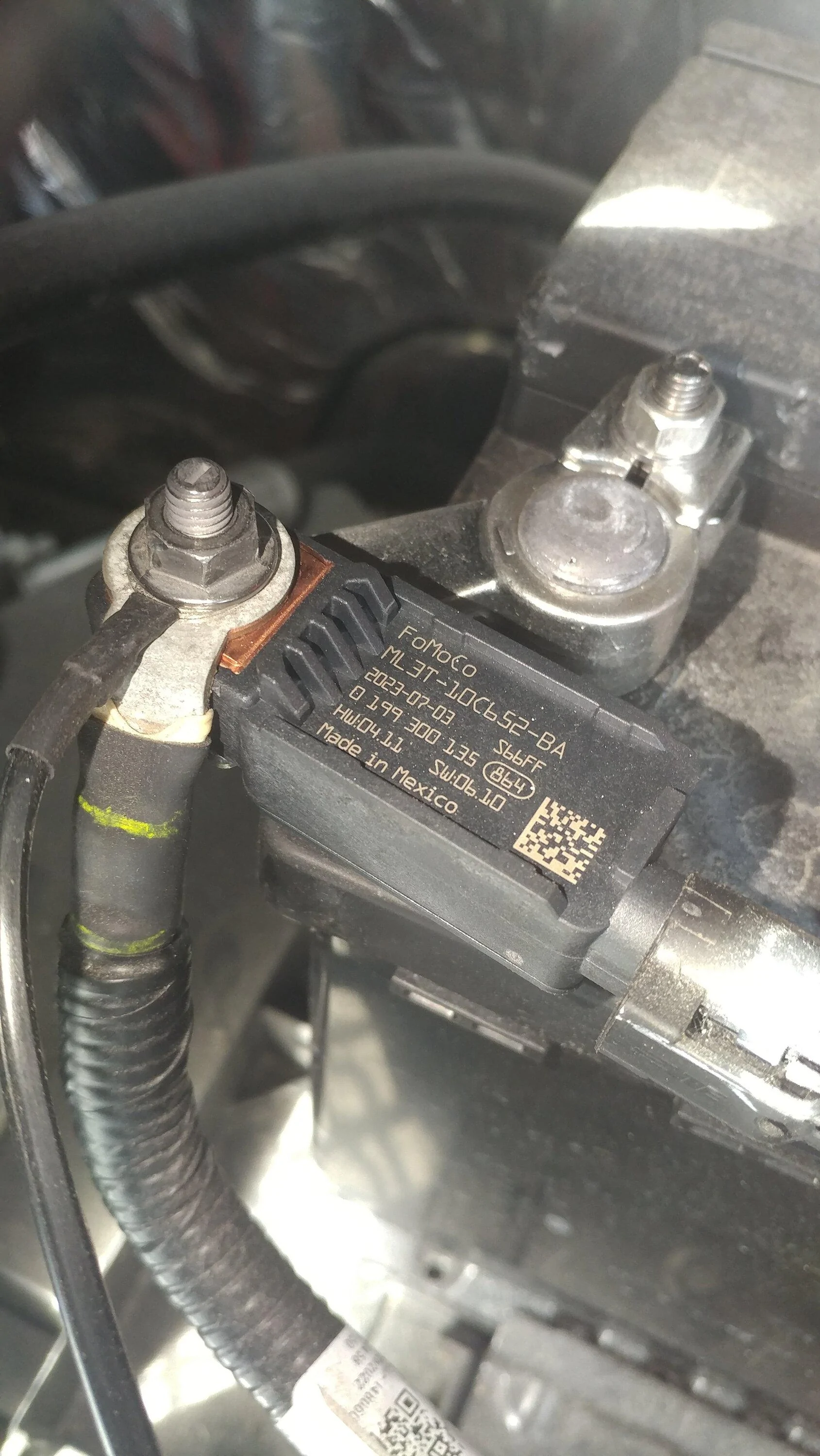

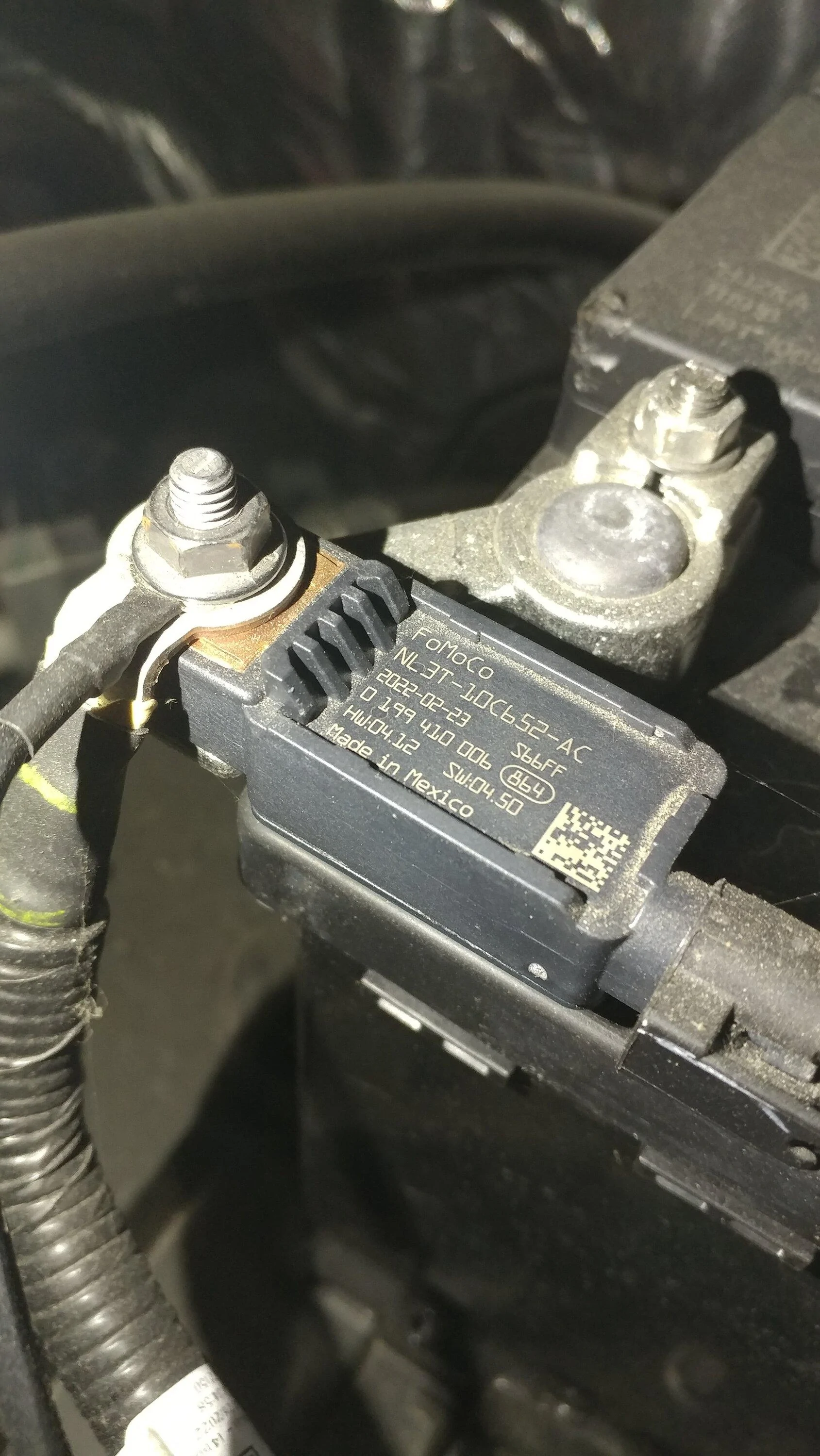

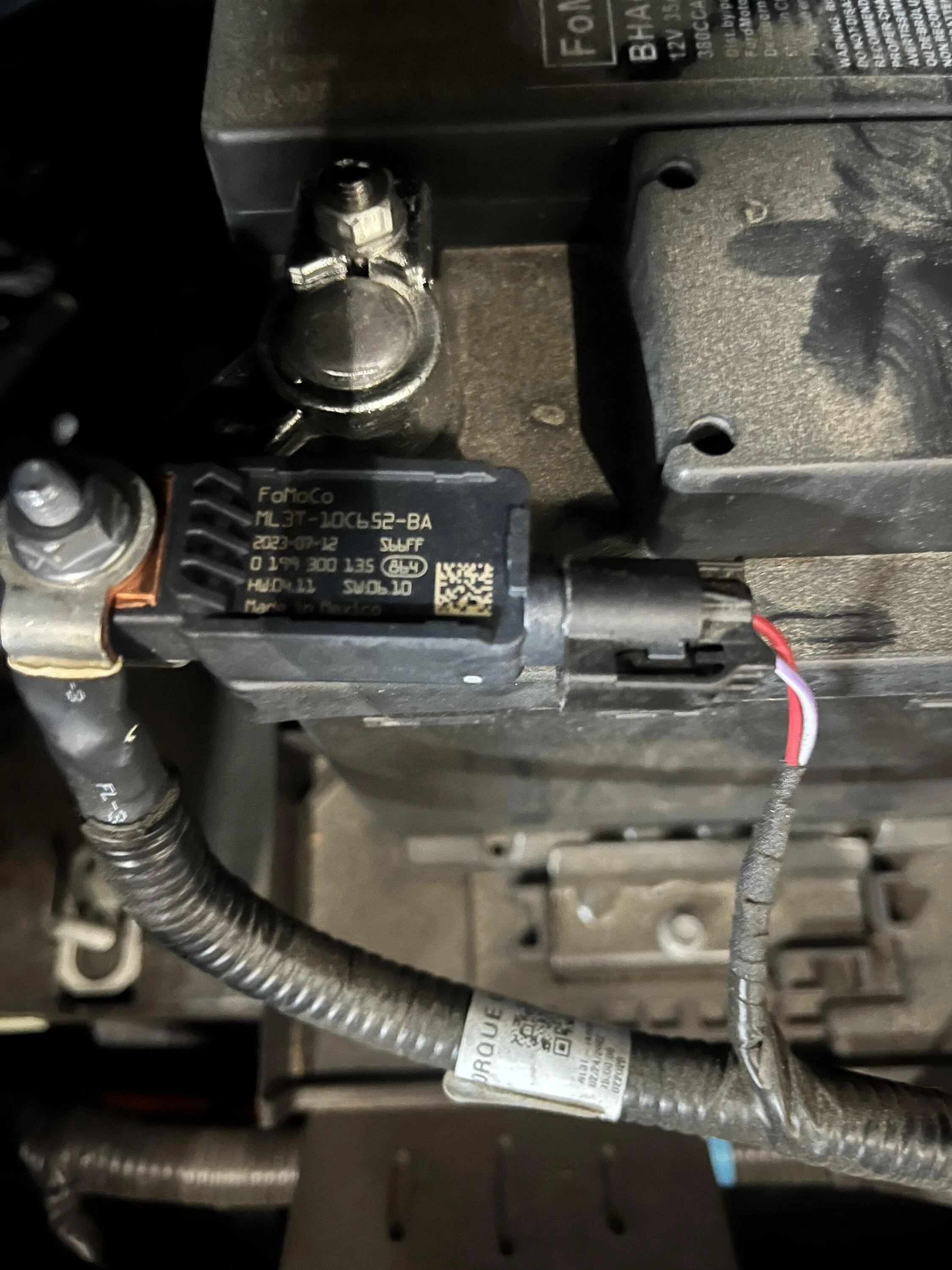

So I ordered part ml3z10c679b from Tasca parts and as others have reported, the part that is in the box labeled that has a different part number because Ford... Mine says ml3t-10c652-ba.
I'm installing it and hoping for the best...
