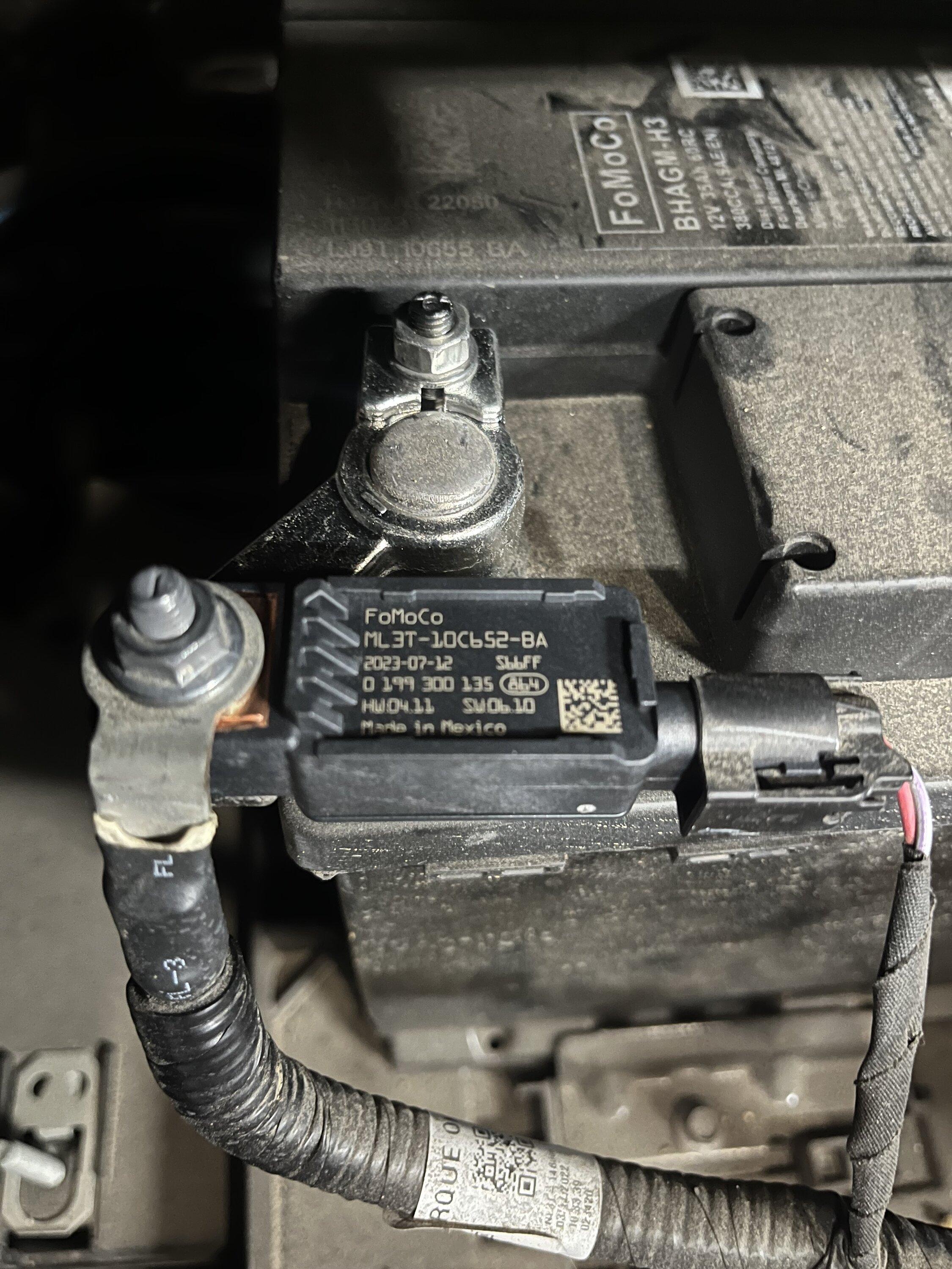

So I took my truck to have this CSP applied. They said they ordered and installed the part, so here's what mine currently looks like in situ:
Ford F-150 Lightning CSP-23B70 Certain 2022-23 F-150 Lightnings - BMS Sensor Replacement 1706125866555
The part number doesn't quite align with the replacement part number of the CSP, but it also isn't one of the AC/AD ones. So is this BMS sensor correct or did the dealer pull one over on me?

Yes, that is the correct new version
Awesome, thank you! I would've been bummed if it is was the wrong one because I actually think this dealership is pretty good. Didn't want to have to find another one. :)

Apparently that new part number is also used on the Bronco.

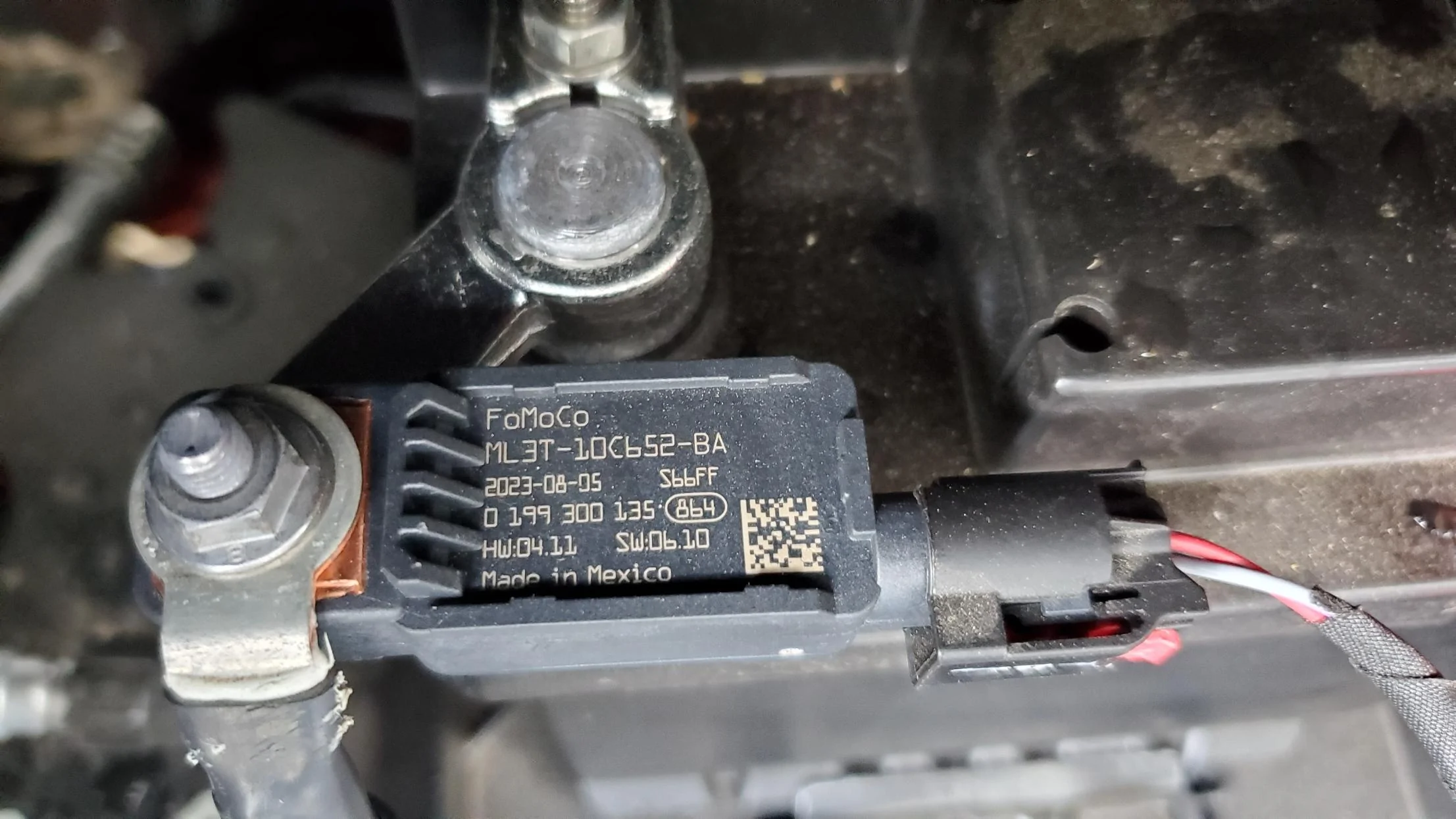

Mobile service came out. Just did both our trucks and done in 10 minutes (y)
I noticed the part number was slightly different than the paperwork. But the box, that’s a part came in matches exactly. And he said that just has to do with the chipset inside, possibly.
