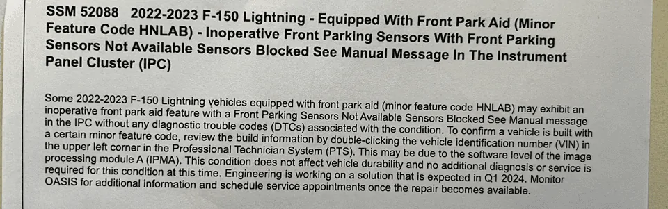

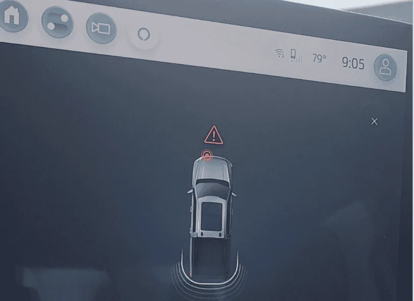

So I've got a new Lightning and I'm already back here asking for info...
I made the trip home from the dealer (3 hous away) with no issues until I pulled into the driveway.
i get the error that the front sensor is unavailable, front sensor blocked. I checked the FB Lightning group and a clear pattern I could see is that a the other members reporting this are new buyers that purchased within the last couple of weeks. Any know of a DIY solution or is the dealer the answer?

Happened last week in mine but hadn’t been thought a car wash since I purchased it on 10/21. I was pulling up to a red light at an intersection and it gave me the proximity warning, cameras came on and then the obstruction warning a little bit later….
hasn’t happened since and I drove it a bunch this past weekend, also went through the car wash and drove a bunch this week…. So hopefully a one time thing!
