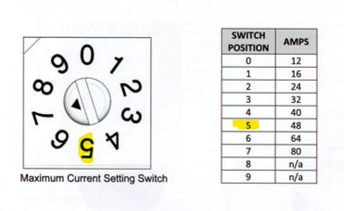

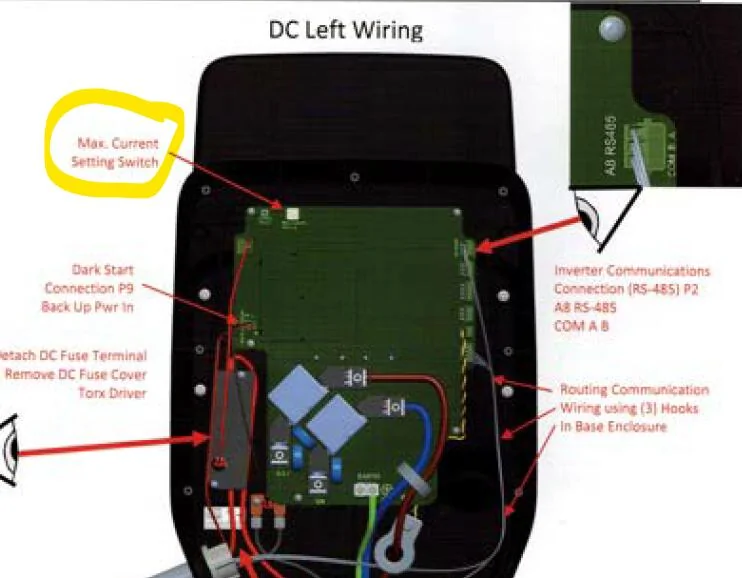

Try opening up the FCSP cabinet and dialing down the hardware switch to #5
The software adjustment is unreliable and might only work in conjunction with the Ford products (not certain)

Physical dial down also didn't work. Called Ford and as usual they are not very helpful. Said 80A may be too much for other vehicles... That's not how it works (or should work) :-(
