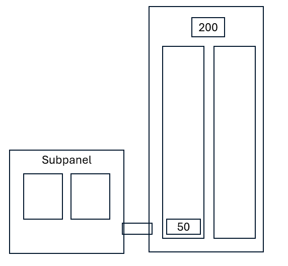

I am considering this option and have a couple questions. My main 200A is absolutely full. So full it has a 50A breaker feeding a small 50A subpanel immediately to the left with (9) 15A circuits.
1. If I install the Generac and move over 8-10 circuits, can the existing breakers for those circuits in the main panel disappear?
2. If yes, then ideally I would replace the 50A sub-panel with the Generac and could use the 50A breaker to power the Generac instead of the sub-panel. Correct?
The sub-panel doesn't have the exact circuits I would want but I could move those back over to the main panel now that breaker space was free.
The sub-panel is right next to the main panel.
If I understand your question correctly…yes, General 6852 Transfer Switch panel could replace your sub panel. It would be the same 50 amp CB powering the Transfer Switch Sub Panel. As you had alluded…you can move circuits between the sub and main panel to give backup power to priority circuits.

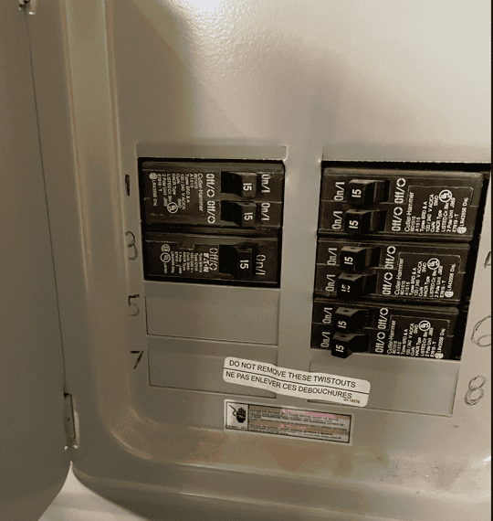

I've never seen so many tandem breakers installed in one panel in my life.
I inherited it from previous owner and said the same thing. Doesn't help that it has (8) 240V breakers (oven, cooktop, dryer, 3 A/C, subpanel, and EVSE (formerly a jacuzzi we had removed). The circuits they put on a single breaker are maddening. There are dedicated circuits for a countertop microwave, an ironing closet in the master BR, a TV cabinet, garbage disposal, a small pantry, etc.

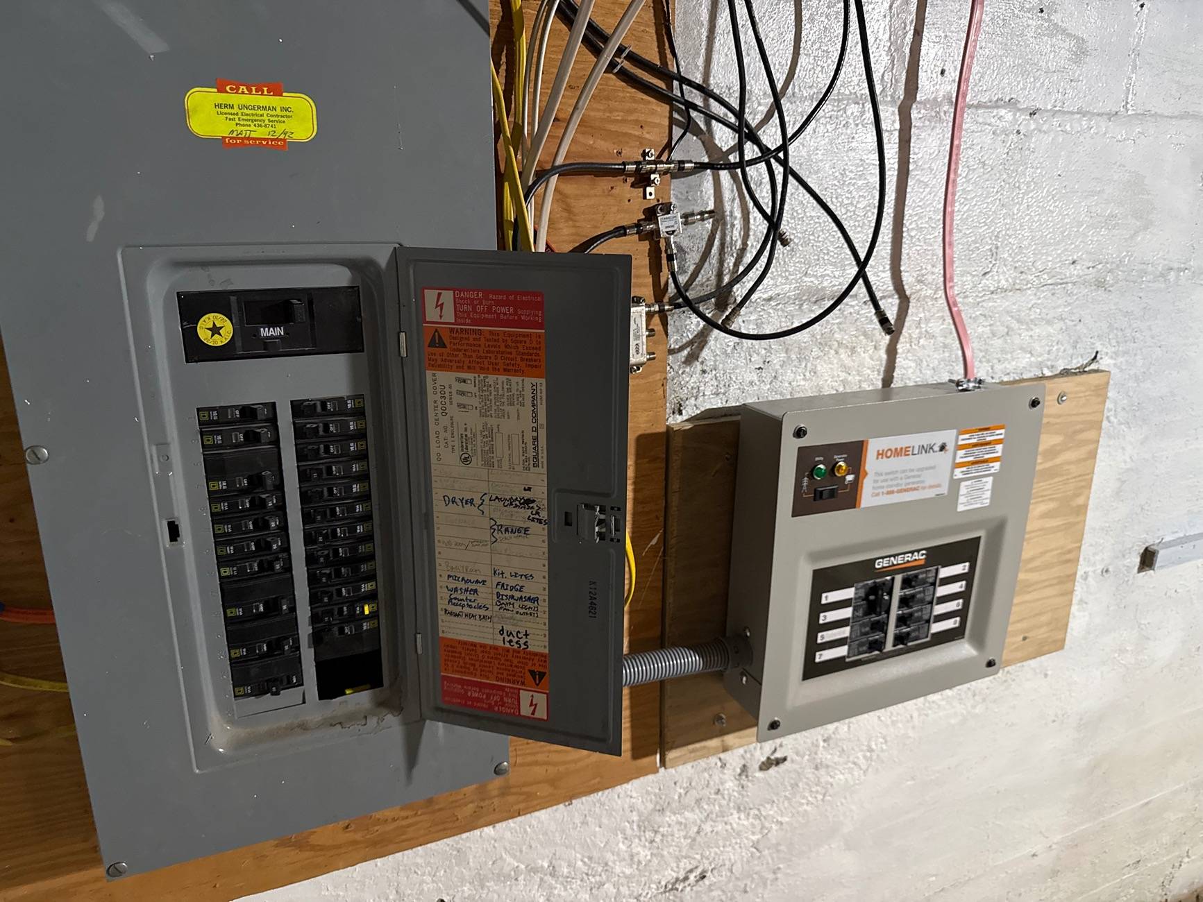

This thread was an inspiration. The selling point of the lightning acting like a portable generator was amazing to me, but the price point of the home integration system was a no go
After reading through all this, had the install done the past two days. Ignore the panel labels; we also freed up a ton of space, identitied a bunch of unused circuits (house was built in the 30s) and cleared a bunch of room to install the FCSP
Love this truck
Love this truck
The cable/satellite guy(s) sure left a mess. ?
