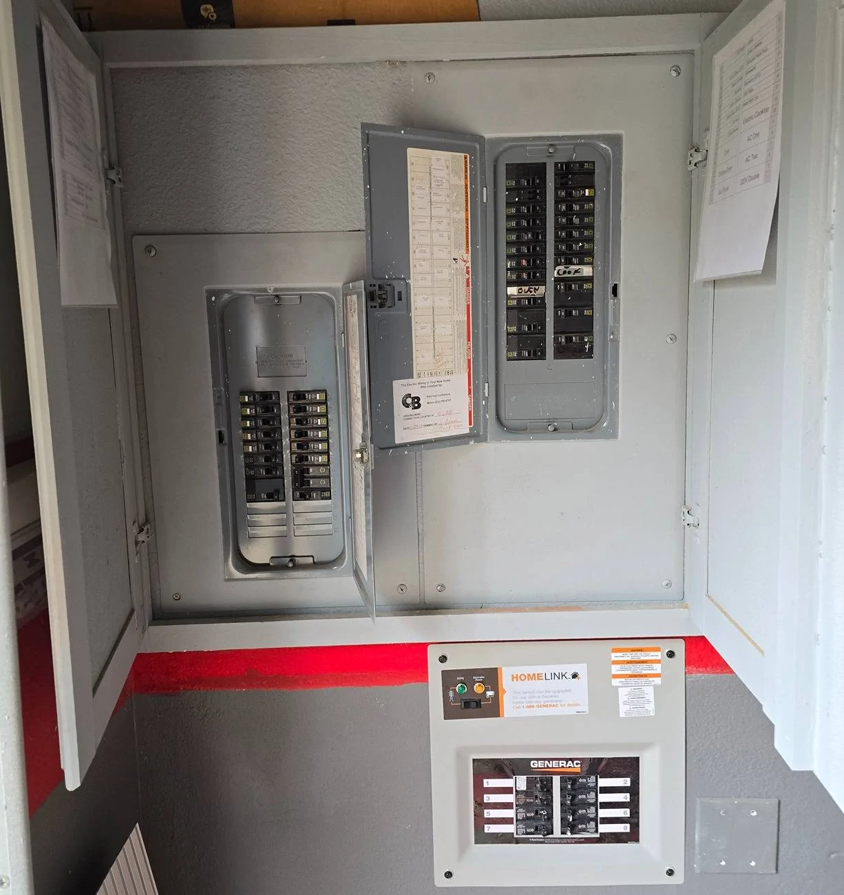

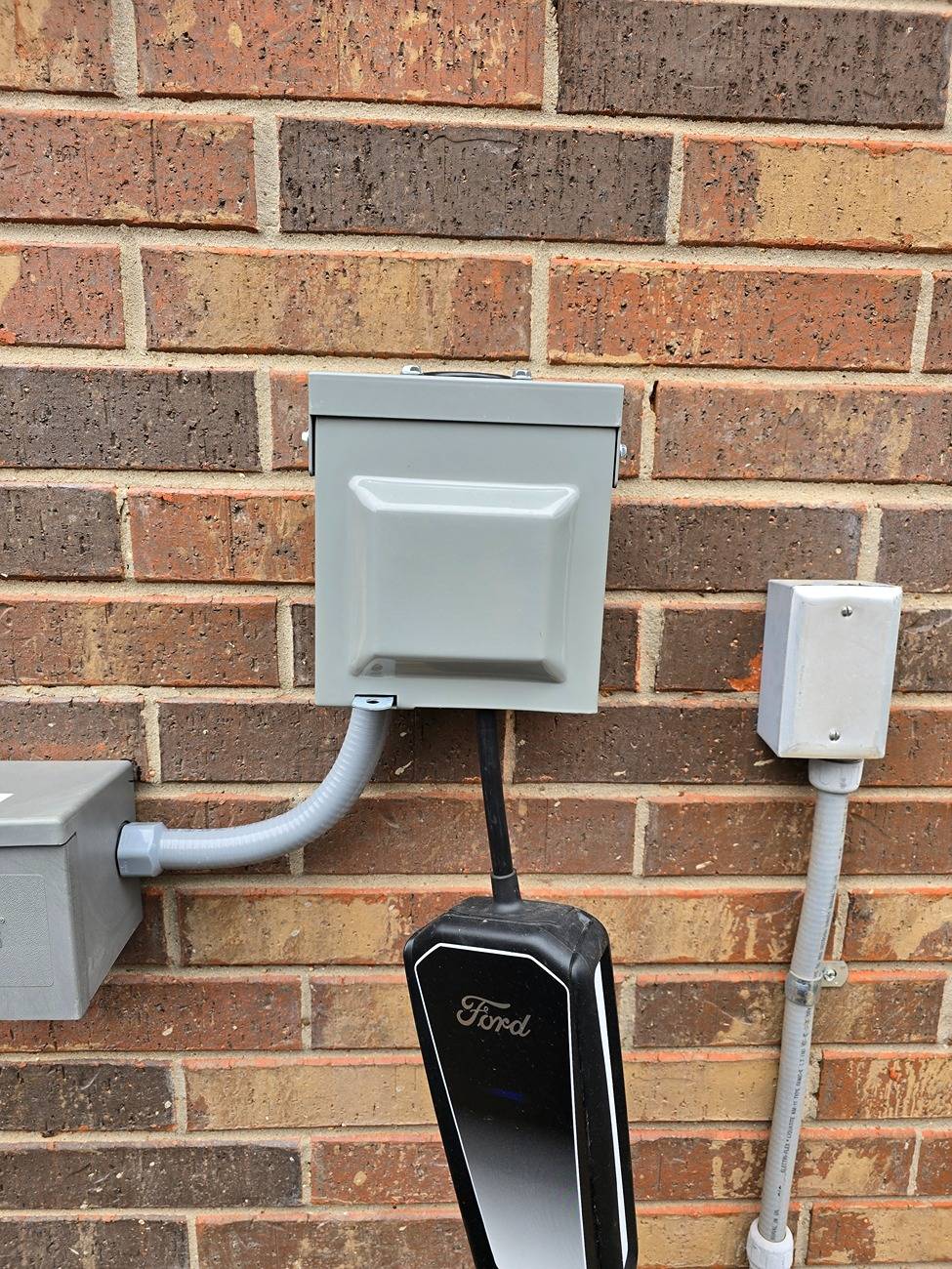

Update - I installed a Generac 6853 last weekend and all works perfectly. Running 10 circuits pulling about 2800 watts. Initially I had one circuit causing the Lightning to fault. I traced it to a light switch box where there were 2 light switches on 2 different circuits. The electrician that wired the house must have not been paying attention as he wired all neutrals to the same lines. once I separated the neutrals in the box, all is good with the Lightning. Great solution for about $500!

Can you send some pics? Would love to see the set up
