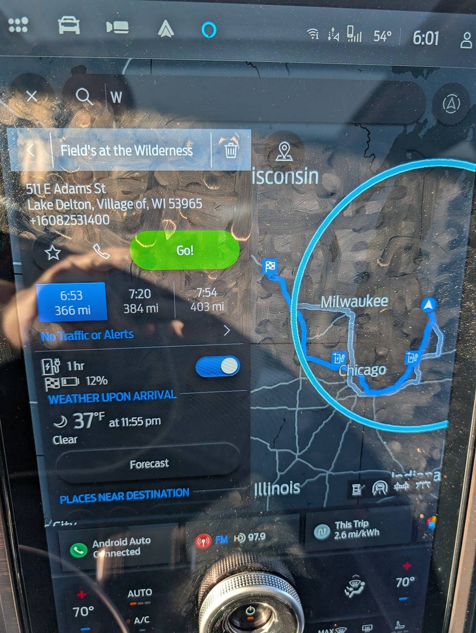

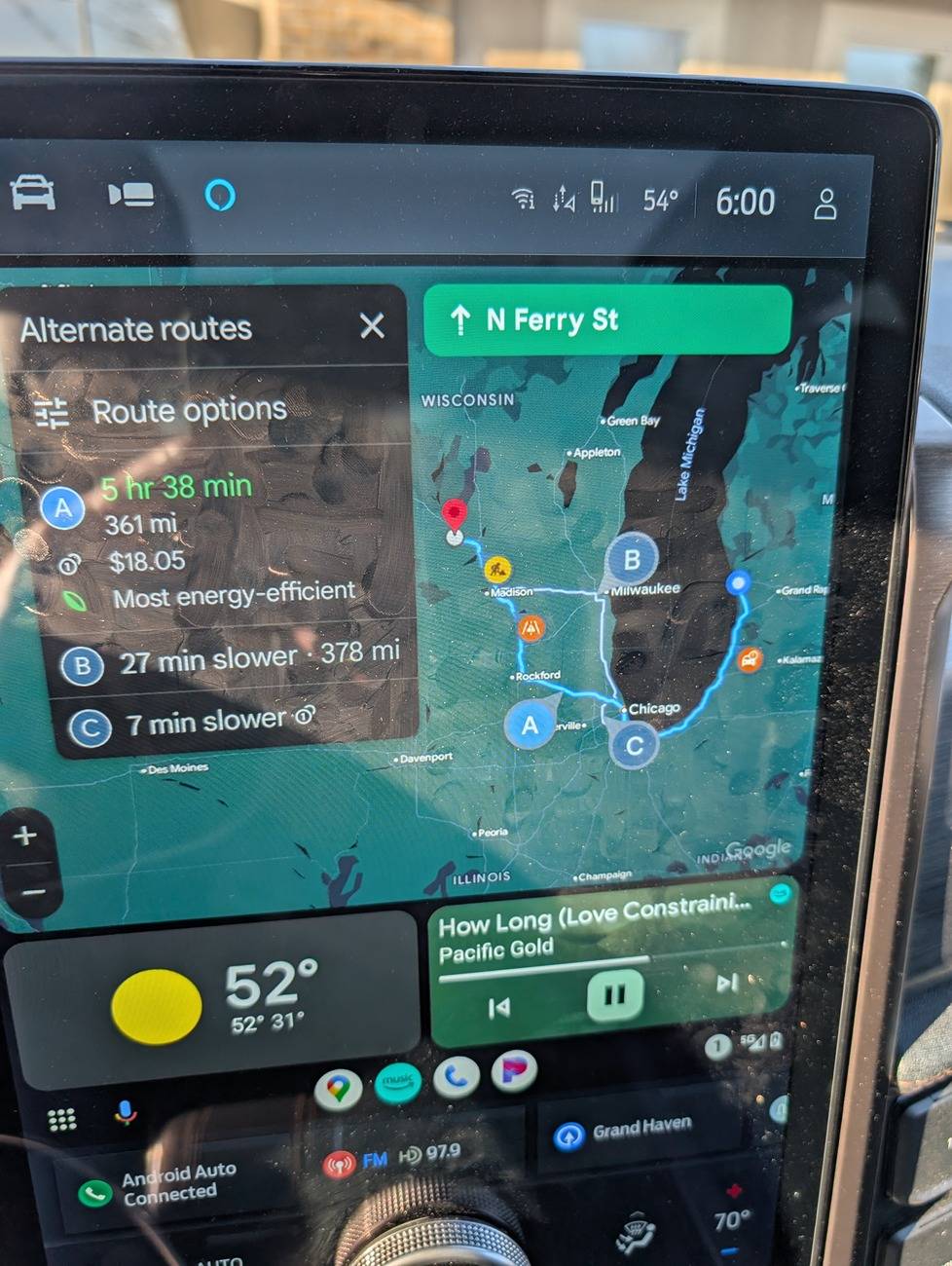

Hi,
I've been struggling to get this to work.
I have a pixel 9 that pairs fine with the truck, no Android Auto issues.
Google maps loads fine and plots directions fine.
But it won't plan stops. I'm entering the destination in the Google maps on the touch screen in the truck and the truck knows the destination is too far away (orange under range remaining)
Ford navigation works fine and plans the stops.
Any suggestions of what to try?
Ford F-150 Lightning Google maps not planning charging stops 1000000328
Ford F-150 Lightning Google maps not planning charging stops 1000000329
Ford F-150 Lightning Google maps not planning charging stops 1000000330
Ford F-150 Lightning Google maps not planning charging stops 1000000331

Route C will have a couple more tolls but will be faster unless you hit downtown Chicago at 2am

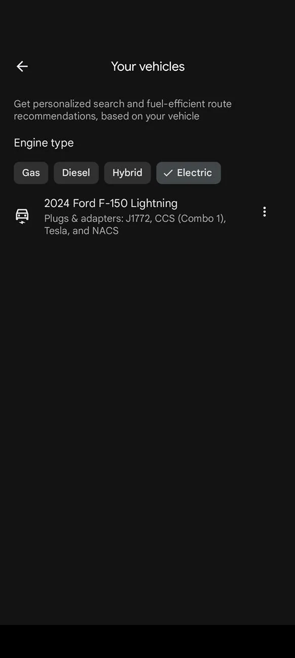

On your phone, set up a drive and check the settings under "your vehicle"
Ford F-150 Lightning Google maps not planning charging stops Screenshot_20250314_132225_edit_2850430990487942

Ok. The truck is set up there
Ford F-150 Lightning Google maps not planning charging stops 1000000345

This is the point I've reached as well. Sync and gmaps software updates confirmed, truck setup in gmaps with connectors added but no EV charging stops or battery percentage. Ford support is blaming Google.
