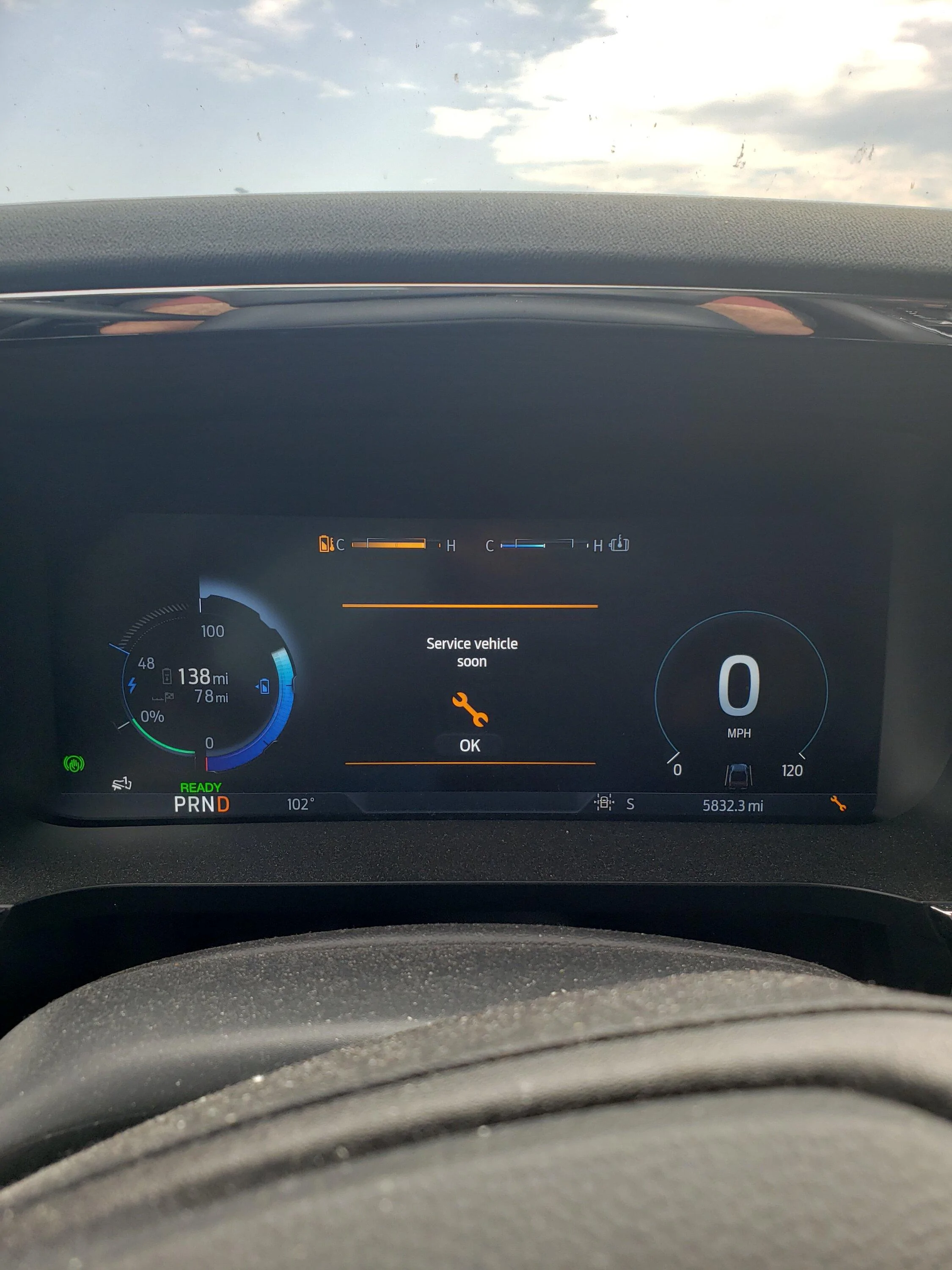

Just came back from a weekend camping trip. On the way up (Friday), I stopped at the EA charger in West Lebanon, NH. It was about 100 degrees outside (car temp gauge read up to 102 sitting in the hot parking lot). I plugged into one of the 350kW stations and it began delivering 155kW. I don't do a lot of fast charging and this was by far the highest charge speed I've ever gotten (barely broke 100kW once). I was pretty happy with that, and decided to pop in to the adjacent Walmart for a quick bathroom break. I checked the app a few times and noticed that the charge rate was getting throttled way down. First to like 60kW and then all the way down to 15kW. When I got back in the truck there was a service warning and the battery gauge showed overheating (see picture below). Power was reduced to 48%. Being that I was so far from home and so close to my destination I decided to proceed with my trip and deal with this after the weekend. Here's a synopsis of what followed:
- During the remainder of the drive the battery temp came down some, and very slowly. The max power climbed up progressively. I think it got all the way to 100% by the time I reached my destination.
- FordPass notified me of "Powertrain Malfunction / Reduced Power", advising me to contact my dealer as soon as possible.
- About an hour after leaving the EA charger I stopped at another DC fast charger and plugged in for about 10 minutes getting 65kW (32% to 40%). It charged without issues. By the time I started the truck, the service light was gone. The battery temp gauge was still above halfway, but did not get any higher as a result of charging.
- By the next morning (saturday) everything was back to normal, and the truck behaved as if nothing had happened. Temp gauge was back to normal.
- Saturday night I went back to that nearby 65kW charger and plugged in for almost an hour (60kWh added - 21% to 81%). No issues, no warnings, no increase in battery temp.
- Today on our drive back to CT I stopped at the EA charger again, charged from 40% to 80% at high rate (160kW peak, 100kW towards the end). The service warning came back, but the battery gauge stayed in the middle, and my max power stayed at 100%. Powertrain malfunction warning on FordPass reappeared. Drove away without issues. Made one final quick charging stop a few hours later (43% to 59% at 100kW). Got a service warning again, but nothing on FordPass. The truck behaved completely normal the rest of the way home and the service light is once again gone. I arrived at home with 20% SoC and the truck is currently sipping on 3.6kW L2.
- Coolant reservoir is slightly above the MIN line.
I will be contacting the dealer and Ford Service first thing in the morning. I can't help but to wonder if this has something to do with the stress of DC fast charging at 150+ kW with 100 degree weather. But then again I had never hit that DC charge rate before in my truck. Are there known issues with fast charging during such heat waves? Not that 100 degrees is extreme.
I don't know what to expect at this point. There is clearly a DC fast charging issue with my battery. Any thoughts and suggestions are appreciated. I'll report back.

Yes, a temperature issue when fast charging and the battery temp is up and the ambient temperature is up.
The active cooling of the battery must have been stressed and unable to cool the battery acceptably during the fast charging.
After driving the battery will be warmer than if it had been sitting idle.
When it is hot outside, over 80 degrees F, the battery will be warmer.
When fast charging the battery will be warmer.
Active cooling can only do so much to dissipate the heat.
Perhaps there was an issue with your active cooling system - mechanical and/or software - and it did not kick in properly?
Or maybe it did kick in but couldn't handle the heat.
Heat is the enemy of Li batteries.
Definitely have Ford check everything.
Yes, the battery cooled down and everything seemed to be back to normal, but your battery's life will be shortened if subject to high temperatures, and worse case scenario, if the cooling system is bad, a fire could result.
It sounds like your charge curve system reduced the power from the Lightning's max 155kw as things heated up which is the proper thing for it to do. But it was too late and overheating occurred.
155kw is the max fast charge rate for the Lightning. Think of red-lining an ICE engine.
Operating at the max capabilities of any system will take its toll.
It will be interesting to see if Ford diagnostics find an issue and a remedy.
Hot climates put a lot of stress on EVs. The early Nissan Leaf's had issue in Phoenix Az with early battery degradation, but the Leaf had no active cooling, it was air cooled.
Good luck.
