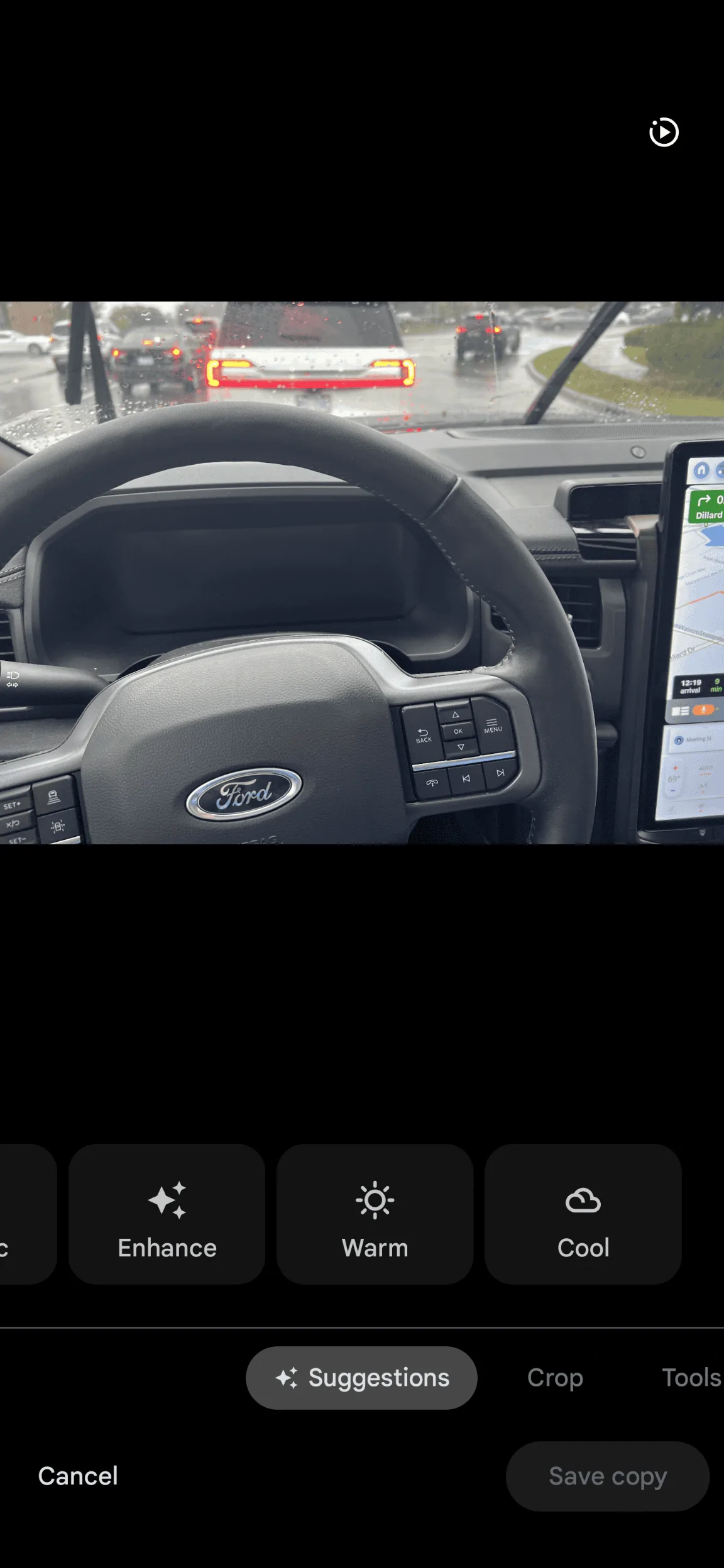

I had the same thing happen a couple of weeks ago. It fixed itself after an hour or so, but same symptoms you had. Immediately after it started turning the vehicle on/off had no affect.
