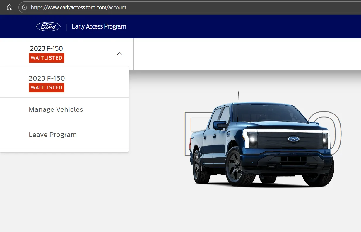

Are you in EAP by chance?
I stopped recieving OTAs and was 9 months behind. I went into the EAP website and saw that in my profile for the field "Vehicle Used For Business Purpose" was set to yes somehow. I changed it to no and BOOM I started getting OTAs the next time I drove it, and then 1-2 a week for the next 2 months.
EAP now has a website?
There is. No real reason to go there other than to verify you are still in EAP. That’s why it took nine months to notice that I was showing as a commercial vehicle.
Yeah, I had forgotten about that site...and in fact I don't think it had the same functionality the last time I was there (long ago). But you're right, it basically says you're in or not....and really that's all the info that's there.
I'm on EAP and I haven't received any OTA updates in a long time either and have relied on occasional FDRS updates. I just checked my EAP profile and the business use had no value in it. Just changed it to "No", so maybe that will do something. Thanks for posting the EAP tip.
