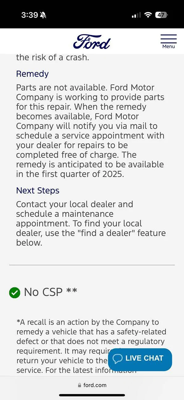

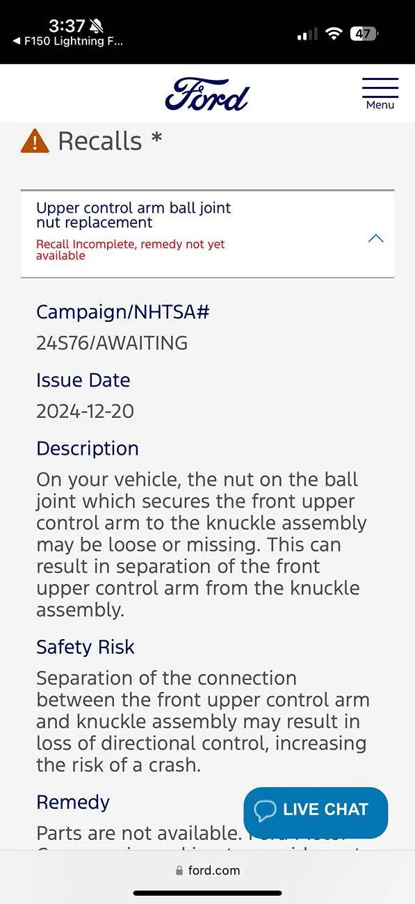

Manufacturer Recall Number24S76
NHTSA Recall NumberAWAITING
Recall Status Recall Incomplete, remedy not yet available
SummaryON YOUR VEHICLE, THE NUT ON THE BALL JOINT WHICH SECURES THE FRONT UPPER CONTROL ARM TO THE KNUCKLE ASSEMBLY MAY BE LOOSE OR MISSING. THIS CAN RESULT IN SEPARATION OF THE FRONT UPPER CONTROL ARM FROM THE KNUCKLE ASSEMBLY.
Safety Risk SEPARATION OF THE CONNECTION BETWEEN THE FRONT UPPER CONTROL ARM AND KNUCKLE ASSEMBLY MAY RESULT IN LOSS OF DIRECTIONAL CONTROL, INCREASING THE RISK OF A CRASH.
Remedy PARTS ARE NOT AVAILABLE. FORD MOTOR COMPANY IS WORKING TO PROVIDE PARTS FOR THIS REPAIR. WHEN THE REMEDY BECOMES AVAILABLE, FORD MOTOR COMPANY WILL NOTIFY YOU VIA MAIL TO SCHEDULE A SERVICE APPOINTMENT WITH YOUR DEALER FOR REPAIRS TO BE COMPLETED FREE OF CHARGE. THE REMEDY IS ANTICIPATED TO BE AVAILABLE IN THE FIRST QUARTER OF 2025.

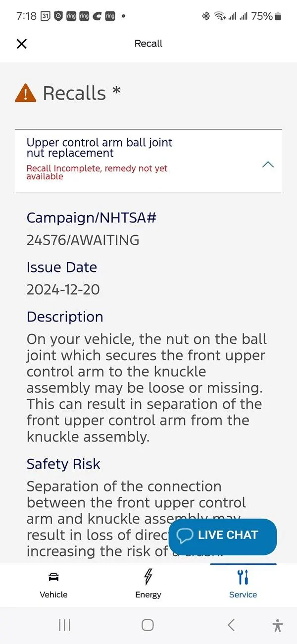

So how difficult is it to tighten my nuts👩🏻‍🔧
Are my nuts so special that the dealer can't tighten them yet? Do my nuts need replacement?
How are your nuts? Has anyone checked theirs lately? What happens if my nuts falloff?
Do I need to hang my truck nuts🔩 off my tow hitch so my Flash can Flash everyone🤔
Now that I have everyone's attention, is this something that went wrong in assembly or manufacturing of the nut.
Is it just torqueing to a specific range add a locknut or locktite. Seems like it's a simple fix , yet nothing is avaliable to schedule an appointment.

Ford F-150 Lightning NHTSA Recall - Loss of Steering from Front Control Arm Separation (Impacting certain 2023 to 2024 builds) Screenshot_20250112_071849_FordPass
