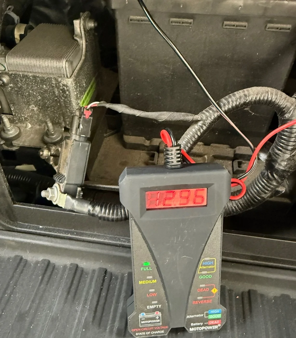

Edit: not a 12v battery issue. I pulled the battery and tested it - it’s fully charged. Taking the truck in for service and will update this thread.

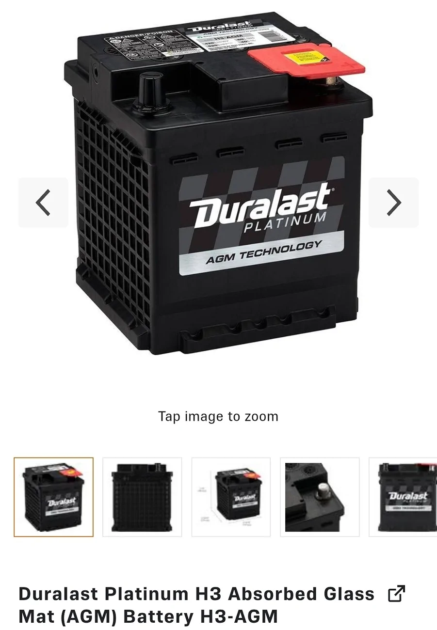

AutoZone is a good place to buy a reasonably priced replacement 12V accessory battery. See my attached pictures. You can buy from their local store for $244.00. There is a $22.00 credit for the core.

It is not my battery. There’s some other issue. I tested my battery - it is fully charged. See picture above.
I stopped by service, and service advisor was able to pull the codes via FordPass. He recommended I take the truck in for service. I scheduled an appointment, will report back in the thread. I haven’t turned in my truck but I already miss it.
