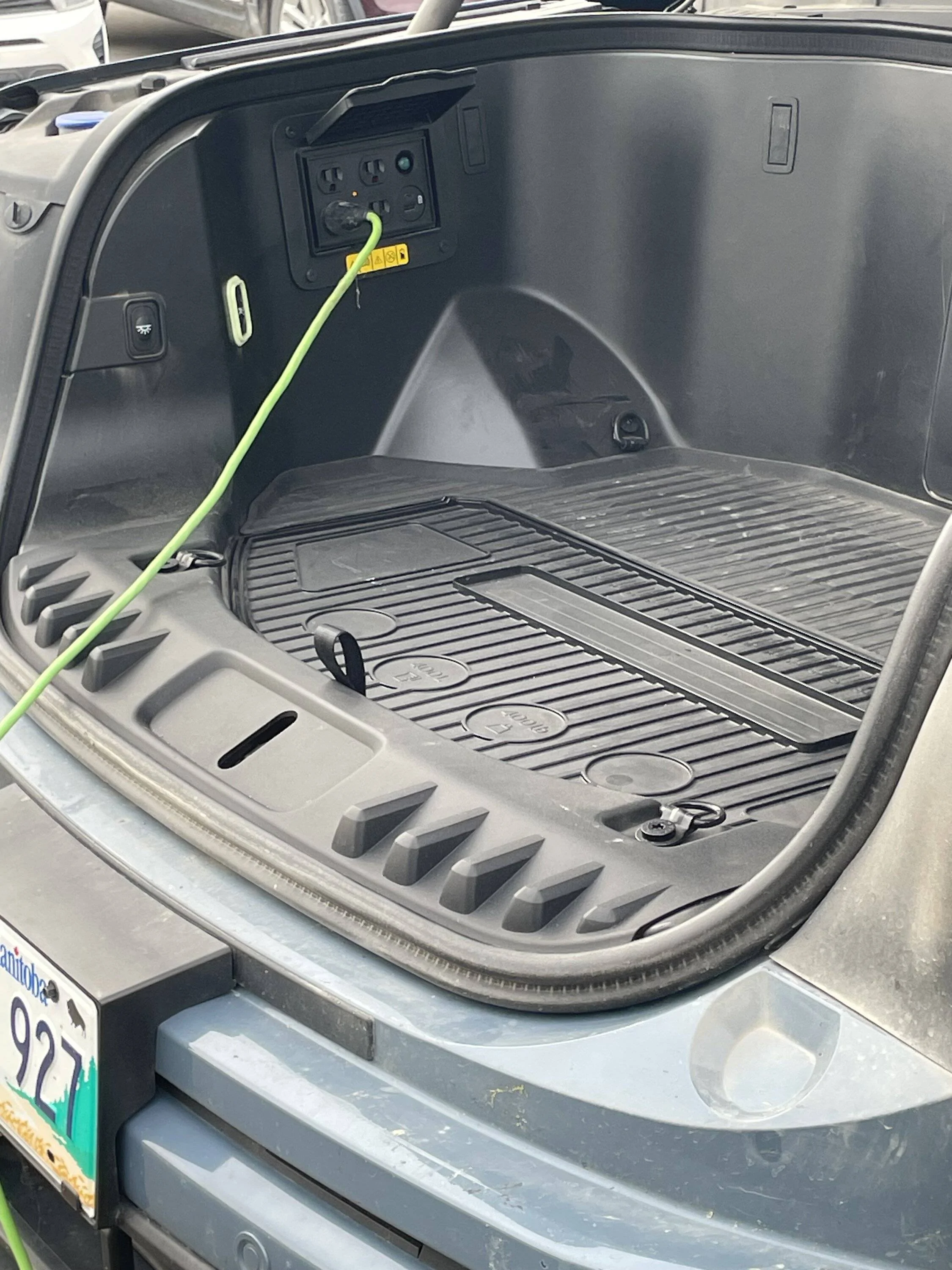

Sorry Ford these 12v issues are becoming a PIA - truck was sitting on charger at 100% state of charge with departure set for 8:20 - at 8:24 truck alarm goes nuts with a frunk opened message in FordPass.
Truck won’t respond to anything and gives every error under sun. Now it’s completely dead…. They should not fail this “hard”.

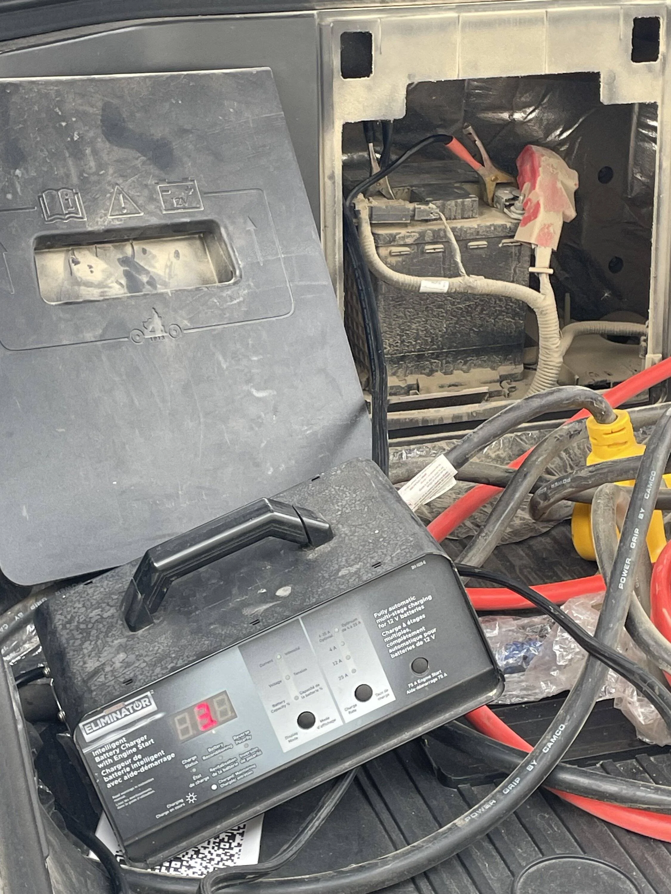

Stuck a 25 amp booster on it, truck goes click and hop in truck powers right up. Disconnect and cycle truck again and no issues starts fine. I did not recharge the battery in 15 seconds on charger.
Change the software…. Recharge at 50% not 30% and get rid of the 48 hour logic…
This is our third truck with 12v issues.

You are not charging that battery properly. You need to put the negative cable on a ground screw or the negative jump post. In fact, put both cables on the jump post.
What you are doing is bypassing the BMS and therefore the truck will not know the proper state of charge of the 12v battery, and will not maintain it properly.

Use the jump posts under the passenger side panel, that's what they are for.

Yep I did catch that and used the posts after taking pictures, interestingly I put it on charger overnight and only showing 60% after 12+ hours at 5 amps. The voltage pre-boosting (dead truck) was 5 volts - immediately after was 14.8 with truck “running” then 13.6 “off w/o charger”.
Tentatively booked into Ford in two weeks to do recall and check battery. All I can find locally are H4 batteries no one stocks the small H3s…
