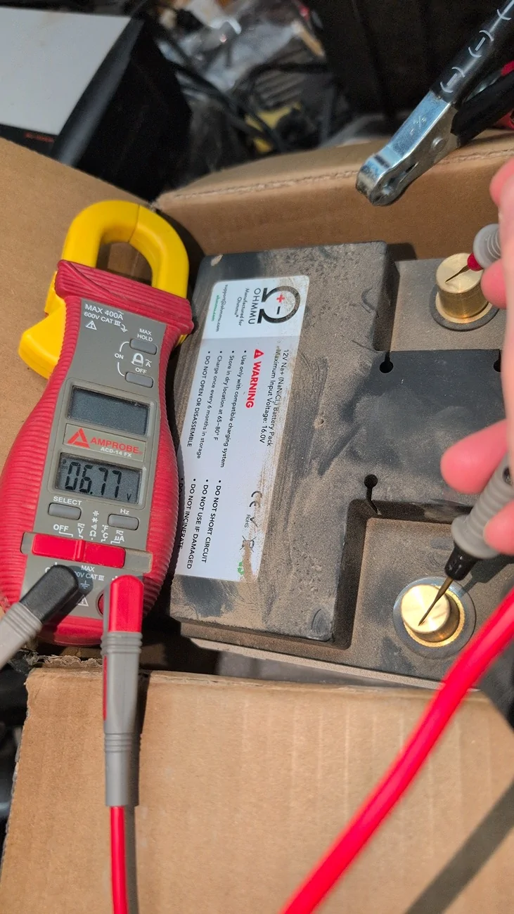

After only 66 days in service, my Ohmmu H3 sized sodium ion (specifically listed on their website for use in the F150L) battery is completely defective. No exterior signs of damage, overheat, fire, etc., and I DID do the 12V BMS reset the moment it was installed. It just will no longer take a charge, at all. I put it on a verified working 12V / 3A battery charger in AGM mode for ~15 hours. I still only have 6.7V across the terminals.
I have put in for a refund from the company. We'll see what they say, but if it is anything other than yep here is your money back, this becomes a credit card dispute.
So glad I kept my old worn OEM H3, so I could at least swap that back in until I can get something else.
You have been warned.

Ohmmu replied. They are denying the return for refund, claiming the battery was damaged due to overdischarge. This is BS for at least two reasons:
1. This battery is advertised as fit to be used with the F150 Lightning, so therefore it should be resilient against normal use / discharge by that platform.
2. If these were authentic sodium ion batteries, they should be able to be discharged safely to 0V and then brought back into service.
So, Ohmmu is fraudulent and not fit for the advertised purpose in multiple ways. Credit card dispute / chargeback in progress.
