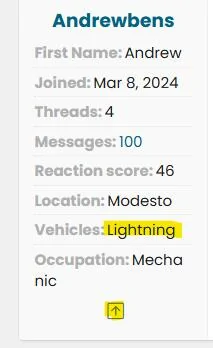

@Ford Motor Company when will you update our navigation to be able to route to Tesla chargers. We all have adapters at this point.
Curious what year is your Lightning, and when did you buy it?
Have you received any OTA's !!!?
