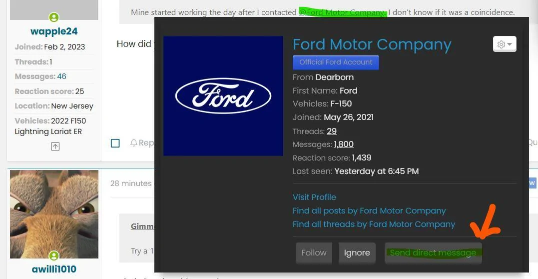

How did you contact them? Mine still need to be set manually every day.
Hover over the hyperlinked name above, the info box should appear select "Send direct message"
How responsive are they typically? I have messaged them multiple times for different things and have never received a response.
You've answered your own question, but I've read a few members post who have received positive interactions, there has been a changing of the guard as to who is monitoring the official account, so maybe it'll get better.
