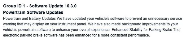

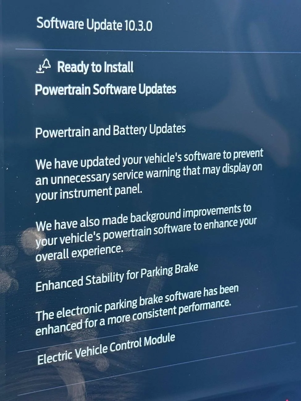

Powertrain Software Updates
Powertrain and Battery Updates
We have updated your vehicle's software to prevent an unnecessary service warning that may display on your instrument panel.
We have also made background improvements to your vehicle's powertrain software to enhance your overall experience.
Enhanced Stability for Parking Brake
The electronic parking brake software has been enhanced for a more consistent performance.
Electric Vehicle Control Module
I thought I was getting BC1.4 ?. Interested to see if parking brake activates more often now and what the powertrain software did.
