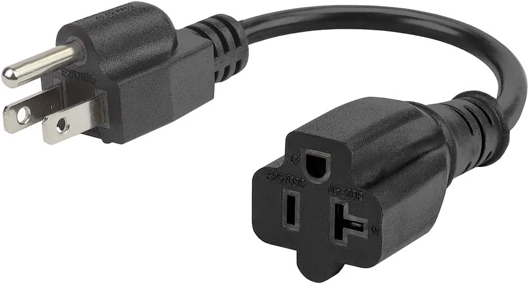

The code addresses cord ampacity, that's not so much of the issue as it's the fact cords get beat up and are subject to damage, which creates higher resistance and heat, plugs pull apart, etc. Then there are the reasons - they get tripped over, doors get slammed on them, etc.Its frowned upon for multiple reasons, but mainly the wrong gauge wire is used for a particular application. For myself, I need to find a middle ground so I can charge this beast.
Nonetheless, frowned upon.
