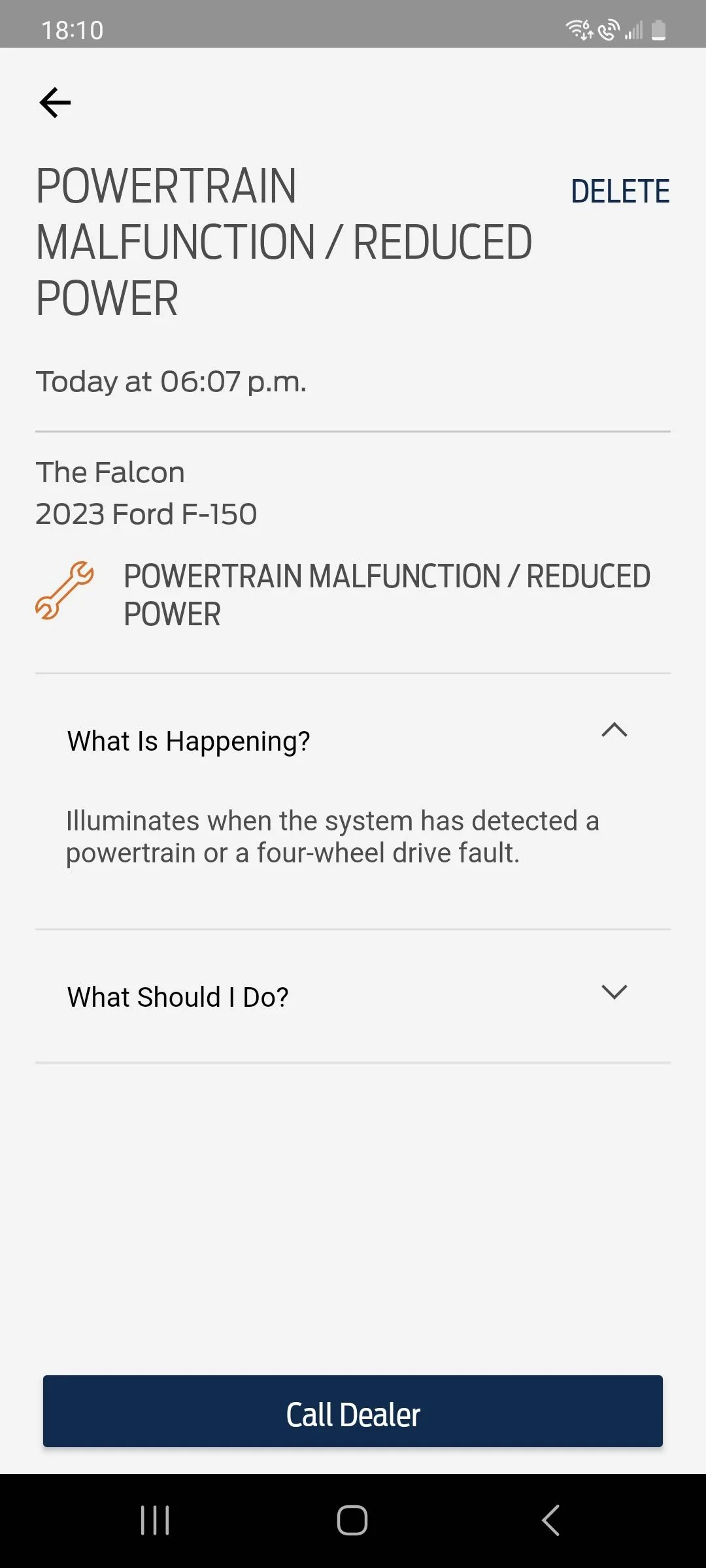

New it was just a matter of time, got the message today. Powertrain malfunction/power reduced..damn it!!!
Ford F-150 Lightning Powertrain Malfunction/ Reduced Power Screenshot_20230921_181002_FordPass
