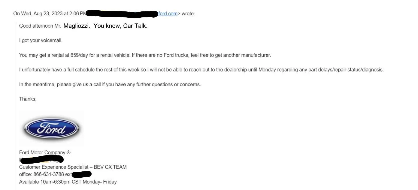

Update: Beware of @Ford BEV Hotline -
Yesterday I traded in one rental car for another because I need a truck to go on vacation with. The new rental reservation was for a F-150 ICE vehicle and I was lucky to get it, rental trucks - cars of any kind actually - are not easy to come by in my town even though there are Enterprise, Hertz, and Budget franchises here. Paid the rental car agency off for the prior rental(+/- $2,300) and got the new vehicle from another agency, but when I went to pick it up it was a Dodge, not an F-150. Rental agency pointed to the language that says "or similar" in my reservation and asked if I still wanted it. Facing the prospect of cancelling my vacation I rented it myself, again, and sent the receipt for the prior rental to the BEV team member assigned to my case, informing them of the swap and confirming that they would cover my new rental. Received an email back this morning from the BEV team member (evidently on their day off ?), saying they would not cover the rental:
"It has to be a Ford rental to be reimbursed. Any model, from any rental agency."
This despite an email from the same team member 6 weeks ago saying:
Ford F-150 Lightning Powertrain Malfunction/ Reduced Power 1696716957998
One would like to give @Ford the benefit of the doubt, that this is all just sloppy administration of a difficult situation, but now I'm out of pocket $2,300 and unsure If I should take my newly rented Dodge truck on vacation starting Monday. Rental agency not open on the weekend, it's a touristy area, that came as a bit of a surprise this morning too.
I'm unsure where/when this is going to end. I've been without my vehicle for almost 7 weeks now, and don't know when I'll see it again, nor if If I can trust it. Was thinking about Lemon law and just getting a new Lighting, now I'm thinking I can't trust @Ford at all and may have to do something else. Did I mention that I sold my 2007 4Runner w/ 372,000 miles on it after I bought the LIghting? Would like a Mulligan on that transaction now. That damn thing is probably still running like a charm, somewhere.

So we’re no Ford vehicles available at the agency or just no F-250’s?
Seems like you have it writing that they will cover you, if no Fords where available.
Initially the dealer set up a rental, because they set it up they were paying for it and it had to be a Ford, fine. They put me in a ICE Mustang convertible. I think the entire interior of that thing could fit in the backseat of my Lightning. No other Ford products were available at the three agencies at that time. Once the initial diagnosis came in a couple of days later, and it was clear that this was going to take a while, I tried getting another, human-sized vehicle but no other Ford products were available. That is when the email above transpired and I got clearance, or so I thought, to get another manufacturer's vehicle. No trucks of any kind were available so I got a small SUV-thing. Six weeks go by and I'm heading out on vacation, the third promise of repair had just fallen through, so I reserved the F-150 with the dealer's PO. I wanted to stay out of the payment food chain if possible. Then it all went South as previously described. I'll call @Ford in the morning, see if I can get them to honor their previous commitment, if they don't then I'm not sure what I'll do. Given the circumstances, I don't think I'll continue the rental on the Dodge, what if the Lightning fandango goes on for another month? Not inconceivable at this point, I'm already at serious risk for a couple of $k, don't want to be at risk for any more.
