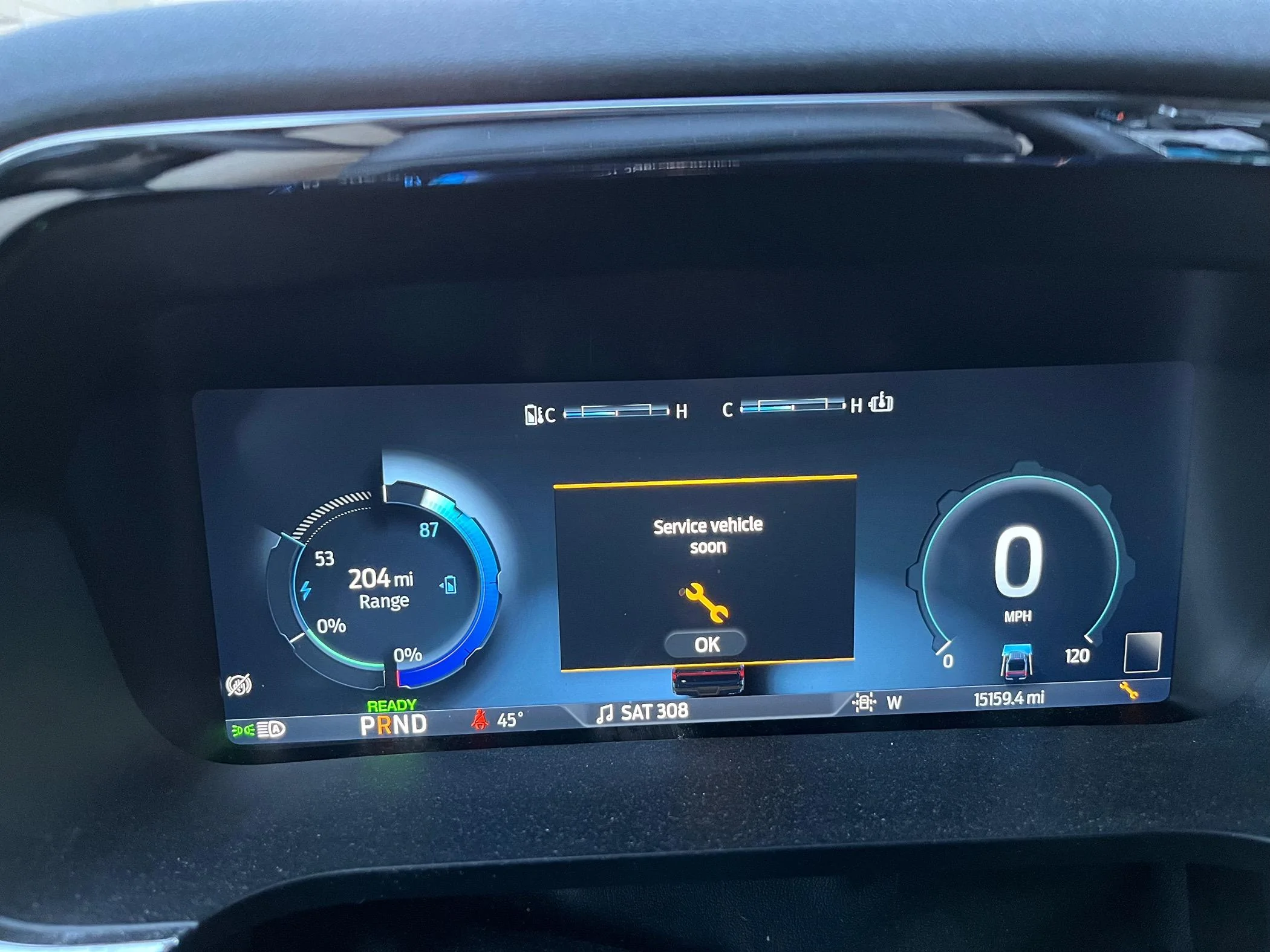

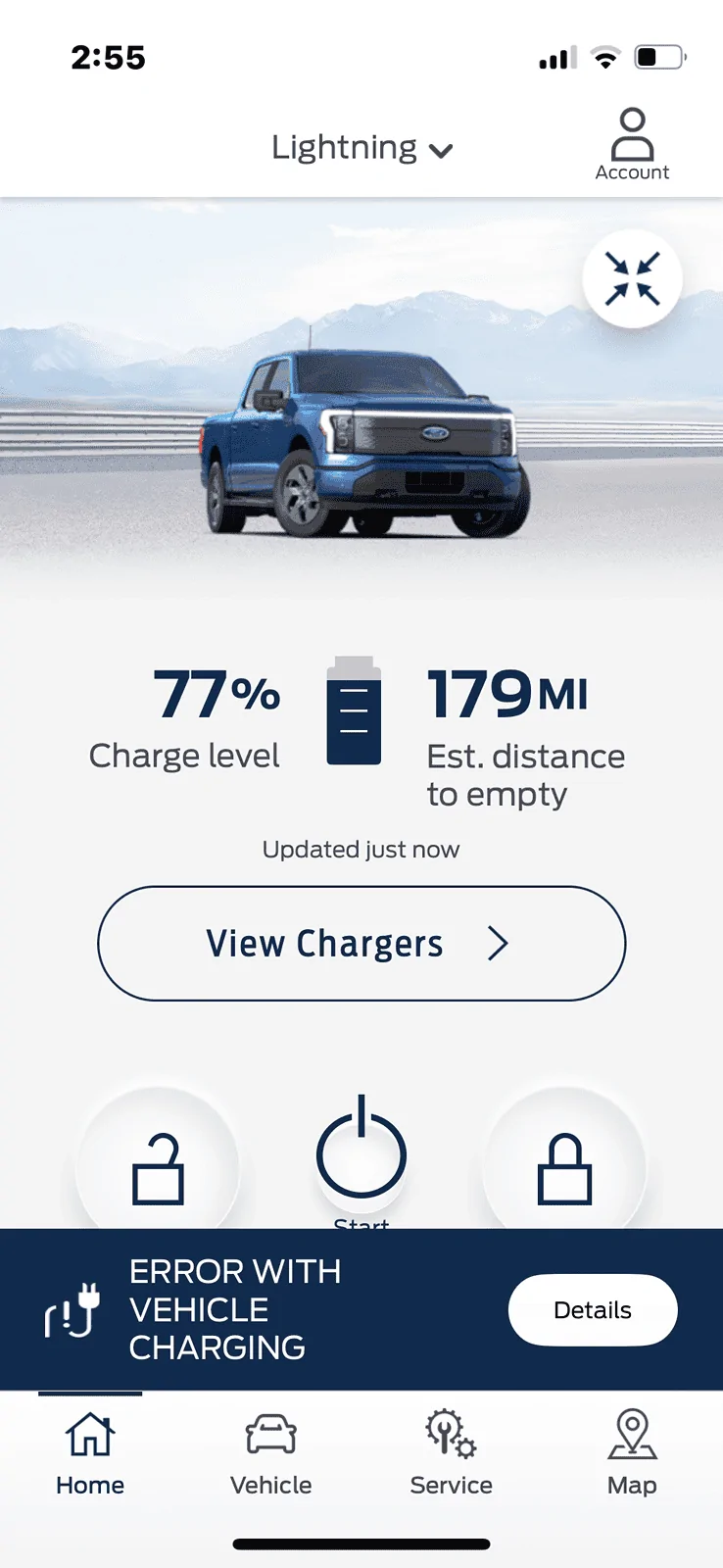

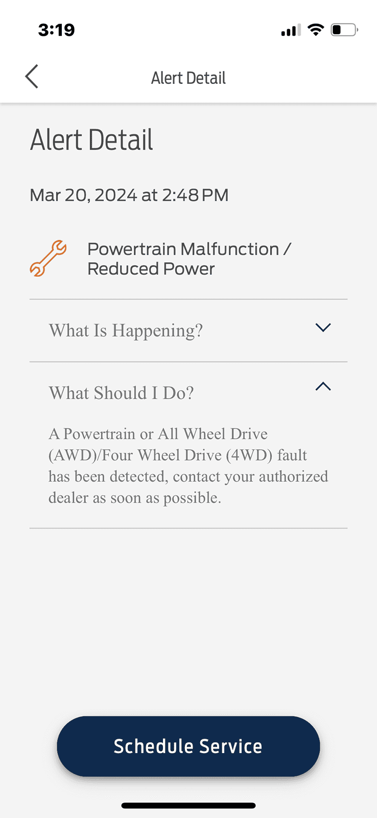

I just got the same warning on the dash, and it also looks like it won't charge. The charge lights turn red. @Ford Motor Company

So, now it won't take a charge, so I'm in limbo until I can get an appointment.

I guess I should clarify that my answer does depend on the exact fault
I was at 80% at the time. I hope your first answer is correct, so I can at least drive it until I get an appointment.
Is it only a specific charger? Have you tried another?
I plugged in at home at 8pm last night and my ChargePoint Flex waits until 12am to start charging and shuts off by 8am, so although I never saw a charging error, I had the same 80% as I did when I plugged in.
Then I decided to try the power at my local mall. It was red. and the App told me there was a problem. Since free mall chargers are not reliable, I decided to plug it in at home again. I plugged in, bypassed the timer and confirmed it didn't work here either.
It sounds more like software issue triggered by the charger rather than the real error.
Of course this is only my guess, but unless Lightning is using very different battery modules, MME has much less issues to my knowledge.
Hope Ford can fix all the issue soon.
