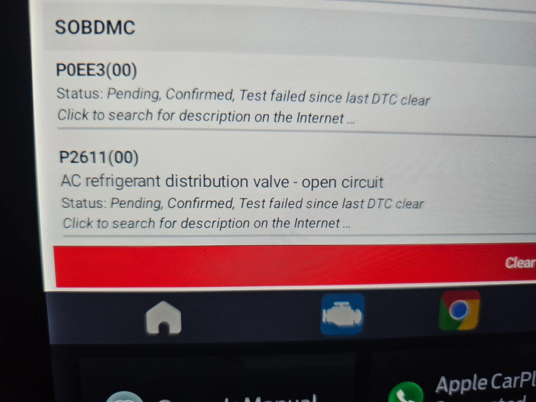

My turn. Pulled the codes on my ODB. This is what I see. What do you think? Bad 12v battery? 39.5k miles on a 2023 Lariat ER.

2023 Lariat ER, Telsa MY, 12 Leaf, 18 Leaf
Also got this on my 2023 Lariat ER on Monday. It's at the dealer, they're replacing the valve.
I also noticed heat wasn't working.
Just drove it 15 miles, heat was working and NO Powertrain message. 🤞🏼

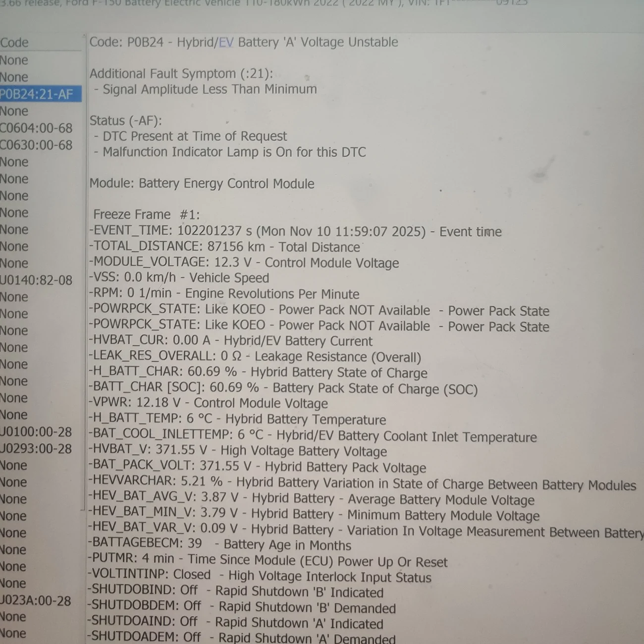

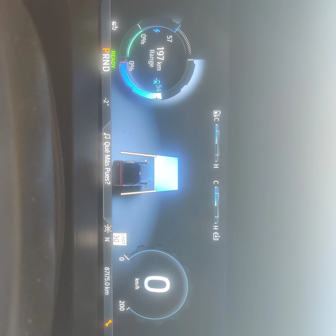

Here is the Dealer joke... Wtf honestly
Got the wrench sign (service) with powertrain malfunction P0B24 code
Took it to the Weston Ford at Toronto
They said.. u need an update for the Battery module, 75 dollars for it. I said isn't that cover? because there was a CSP-23B57 recall about same issue. They said.. no!, Powertrain/Battery warranty doesn't cover it..
Called Ford Canada, they said they don't cover updates.. what a joke
Then I said ok 75 is ok I will pay for it..
Today I am going to pickup the truck and Weston ford said..
"Ups Mr,, the service representative you spoke with made a mistake. It is not 75 dollars is 645 for updates. Is that ok for u?" WTF Weston ford and ford service sucks
I will just take it to another dealer
Ford service is a complete 🤡🤡🤡

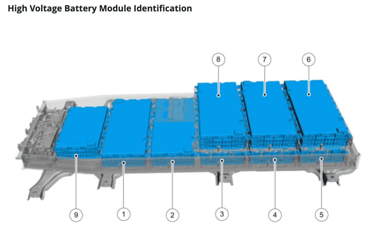

That code usually means a bad cell in one of the 9 HV battery modules. And you are limited in power (left gauge) to 57% which is usually another confirmation of a bad cell. Find a Ford dealer with good EV tech(s)...good luck. Your 8yr 100kmile (150k km?) warranty will cover. Call Ford BEV customer service. Arrange for Ford rental so that BEV will cover what dealer will not.

Thank you @GoodSam
module #7 problem for my 2022 lariat truck
1FT6W1EV3NWGxxxxx
Error P0B24 and 57% power
They told me they r waiting for parts 😞
What the percentage of fail after 1st fail?? Is it likely?
