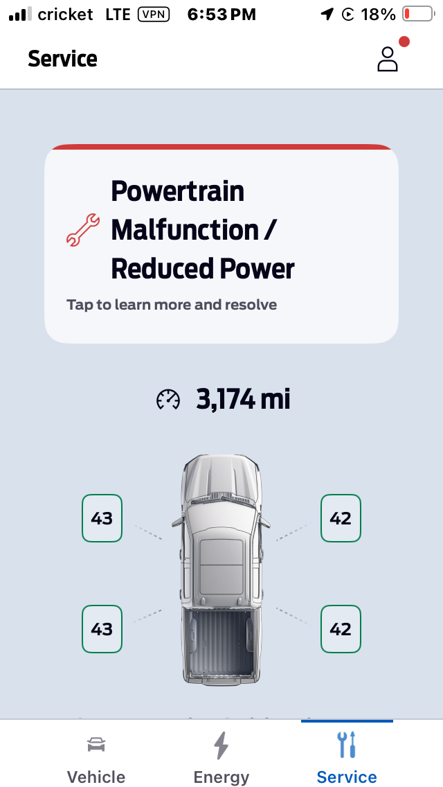

Just got this.
23 Lariat SR.
7/23 manufacture date.
29,000 miles
No recall or CSP for battery issues
Got the orange wrench at ~56% battery level and after a 20 mile drive. Had not charged since Saturday afternoon.
Dismissed the warning and I only had 57% power. Went to get a haircut and when I came out I only had 53% power. ?
Made it home and plugged in. Charged up to 62% battery level and it errored out. Orange ring on the charge port now. ?
Called my local dealer and the soonest they can get me in is next Monday. ?
What should my next steps be? Guessing charging is out? I commute 60 miles a day and need to be in the office tomorrow for a meeting. Would I be ok to make that drive or should I make other arrangements?

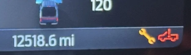

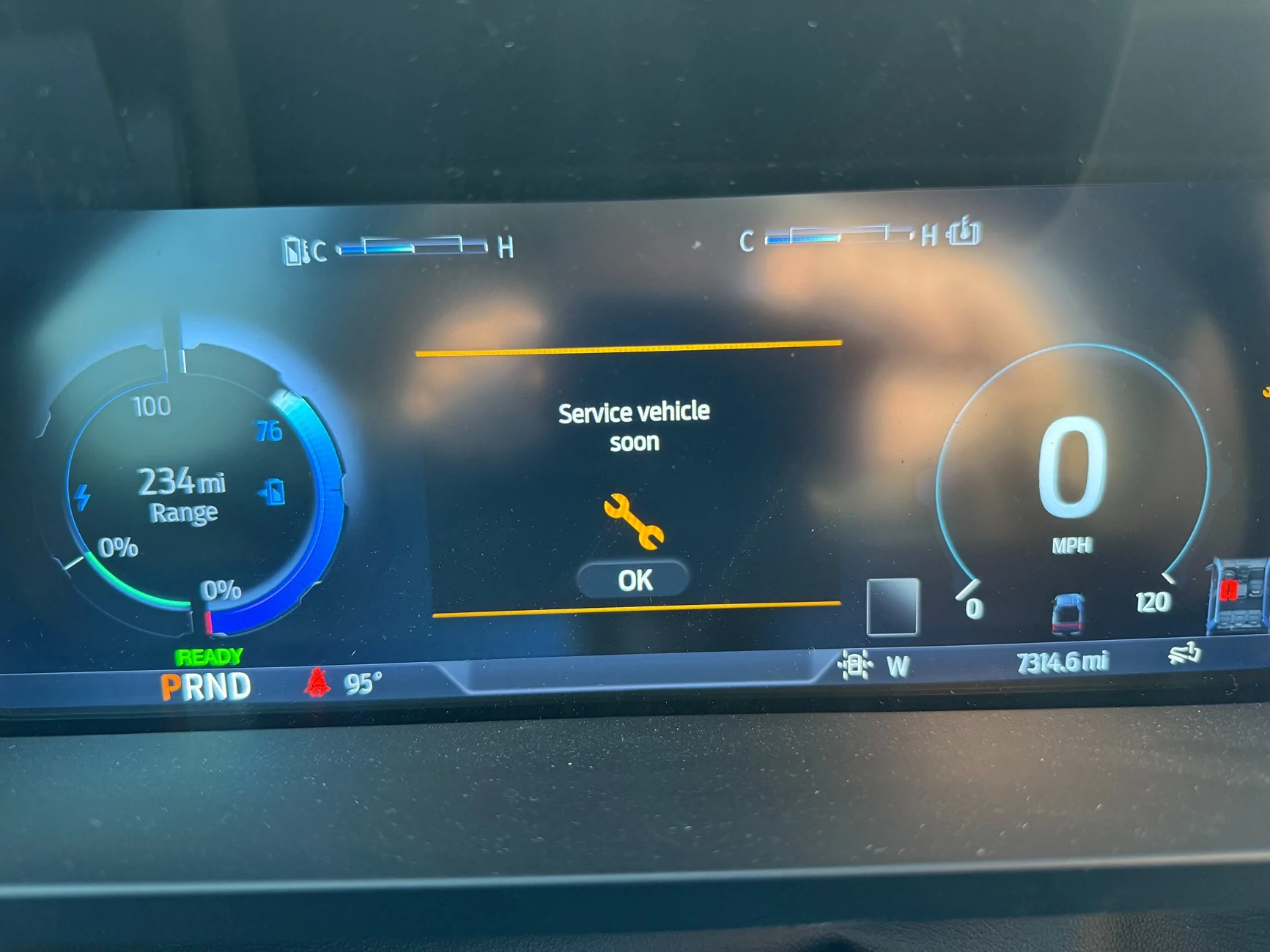

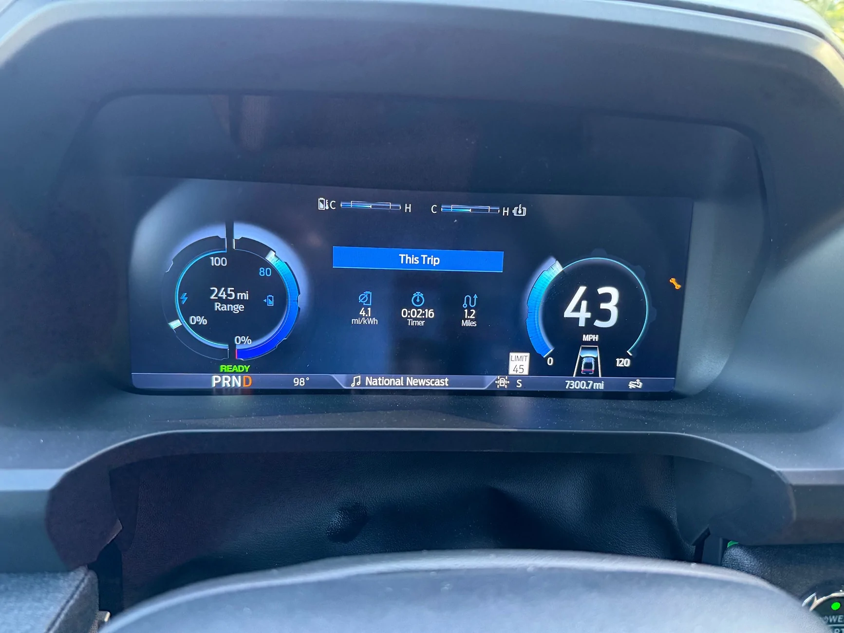

Service vehicle soon Orange Wrench on dash display 7314.6 miles on a late year 2024
Ford App says Powertrain Malfunction / Reduced Power but dash display reads 100% power available no noticeable decrease in power, but not pushed hard.

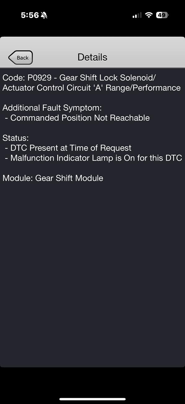

Forscan picks up a Code:
P0929 – Gear Shift Lock Solenoid/Actuator Control Circuit ā€˜A’ Range/Performance
Additional Fault Symptom:
- Commanded Position Not Reachable
Status:
- DTC Present at Time of Request
- Malfunction Indicator Lamp is On for this DTC
Module: Gear Shift Module
This is probably the third or fourth time this ā€œService vehicle soonā€ has popped up starting in June. This last time after I stopped the truck, turned it off, plugged in the OBDII reader, turned the truck back on, the orange wrench was still on, took a reading in Forscan, found the shift lock error. Then I pushed the Shifter fold down button and like magic the error cleared. Seems like some kind of bad motivator in that Shifter thingamajig, I distinctly told the dealer when I spontaneously purchased the truck I thought that shifter was not a good idea and some buttons, or a spinner would be less likely to break. Ford if you are reading this, why don’t you make a spinner replacement kit available with a new tray, so I don’t have to 3D print my own and hack a $80,000 truck… Just asking, no I did not pay that much but that was list at the time.

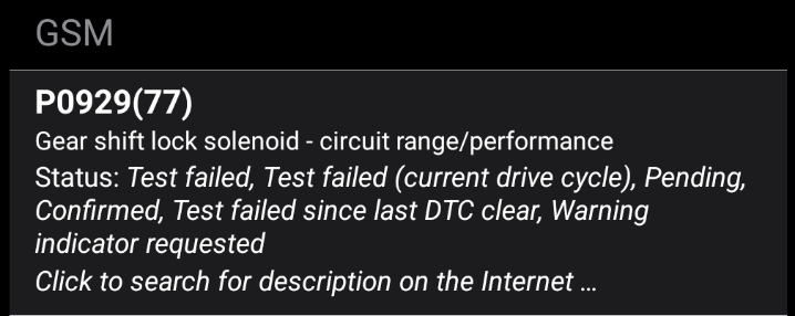

Ugh, got these this am..!! Dealership can’t see me until the 31st to diagnose and order likely battery modules.
Reduced power to 20% and Powertrain malfunction with high voltage battery warning.
POB24(21)
Hybrid battery A - voltage unstable
Status: Test failed, Test failed (current drive cycle), Pending, Confirmed, Test failed since last DTC clear,
Warning indicator requested
This looks like a repeat of my first truck that I lemoned back to Ford back in March 2024 and bought this one.
My luck..!!….Bad luck

Got the Powertrain Malfunction/ Reduced Power message in FordPass and the SVS alert on the dash. Pulled the P0929 code with CarScanner.

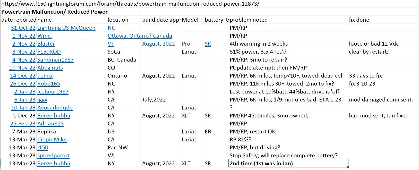

These are the folks mentioned in this thread so far with problems, a couple seem to have self corrected. Who is missing here if someone knows of 33 reports in the forum? Wish folks would put more in their signatures of build date, model detail, and battery type. Maybe @Ford Motor Company would give us a complete list!
230313 Power Malfunction Reduced Power F150Lilghting Forum list of people Screenshot 2023-03-...webp
Let us know of any missing details and outcomes of HV battery problems and I will try to update the spreadsheet:
Here is link to an extended Google Sheet, including another forum battery problems threads:
230313 Powertrain Malfunction - Reduced Power forum track list - Google Sheets
Am I missing anyone?

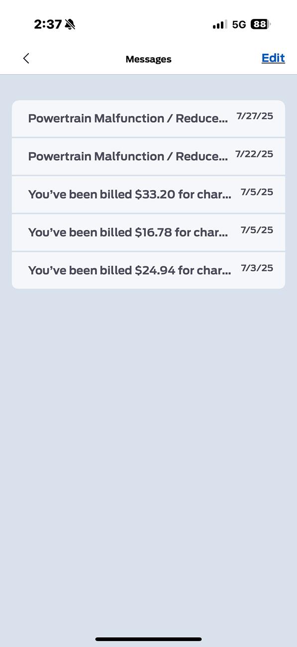

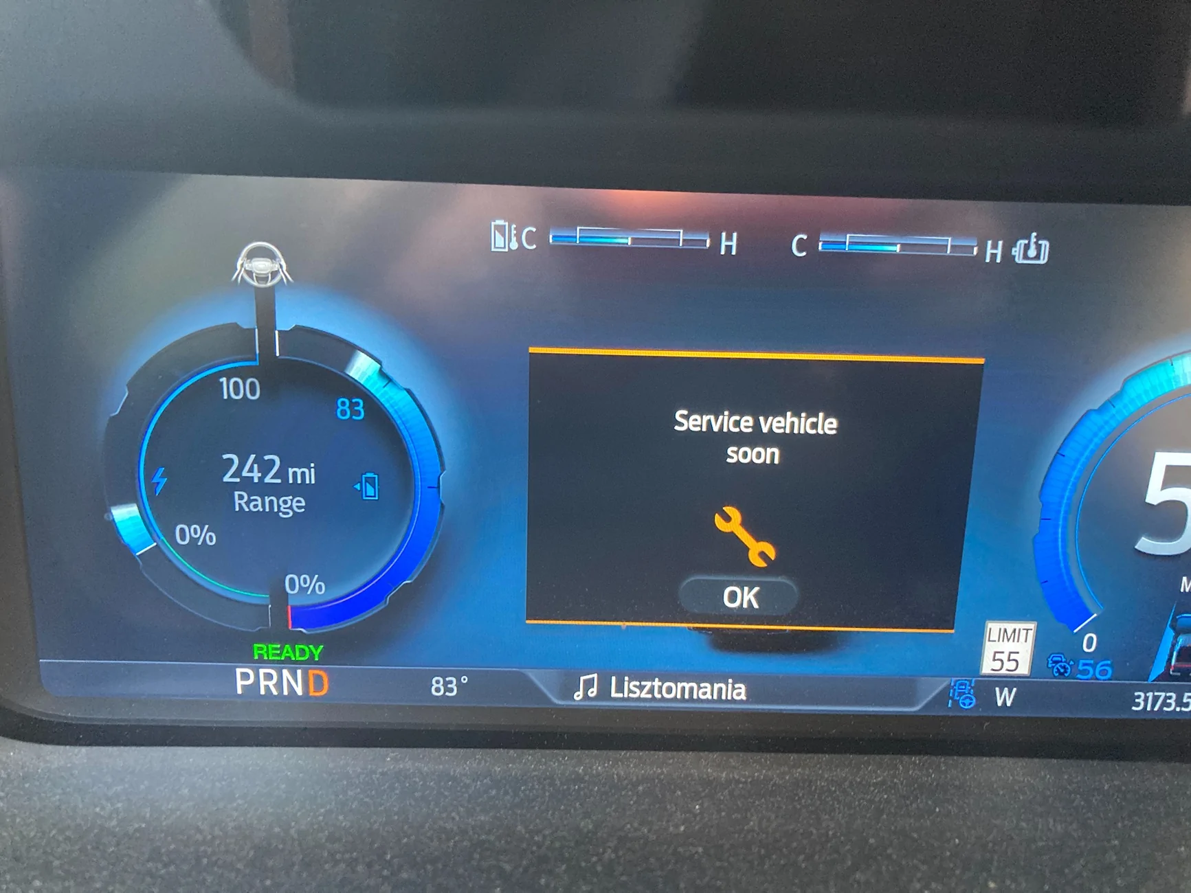

Yep. As of today you can add me: 2024 Flash ER build date 10/24 3K miles Service Vehicle Soon, Wrench Icon, Powetrain Malfunction/Reduced Power. "what should I do?" A pwertrain or AWD fault has been detected, contact your authorized daler as soo as possible. Truck seemed to drive fine. Power was equal Front/Rear and not reduced. Made it home (10 miles) without problem. Wrench now gone and no warning except in history.
Edit: Took it to the dealer. They said no error codes in history. I swear I wasn't hallucination (took a pic). Come pick it up it's ready to go. Making me a bit nervous. Should I use Car Scanner or something to check battery health?
Edit: Flash ER, build date 10/10/24
