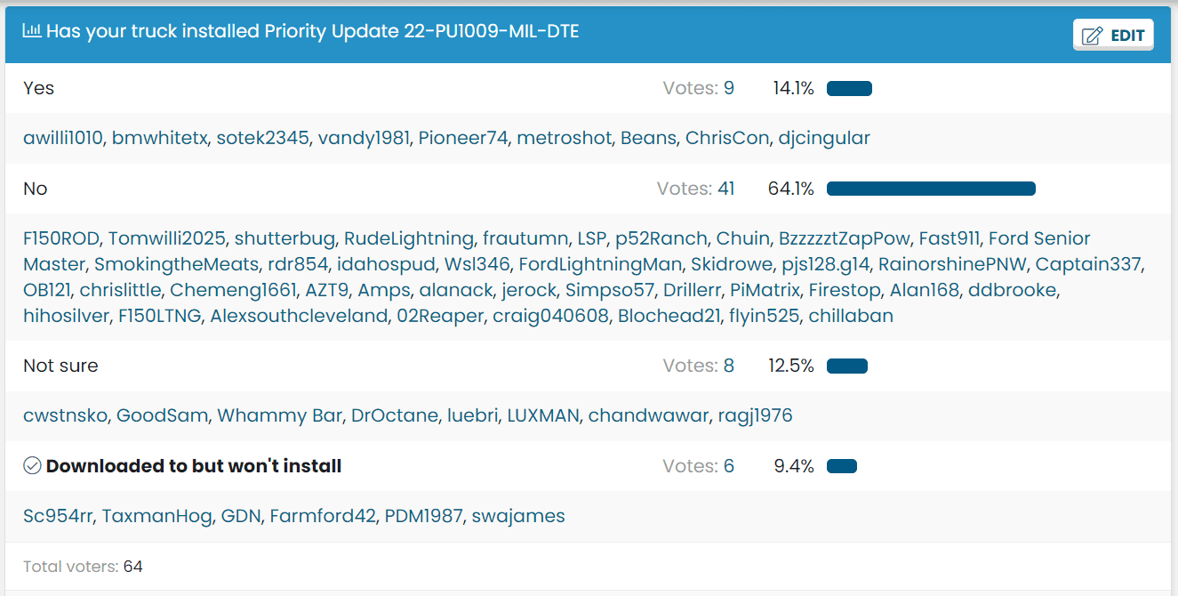

BTW, remember to update your vote when the blessed event happens on your Lightning.
Snap shot of the update progress so far....

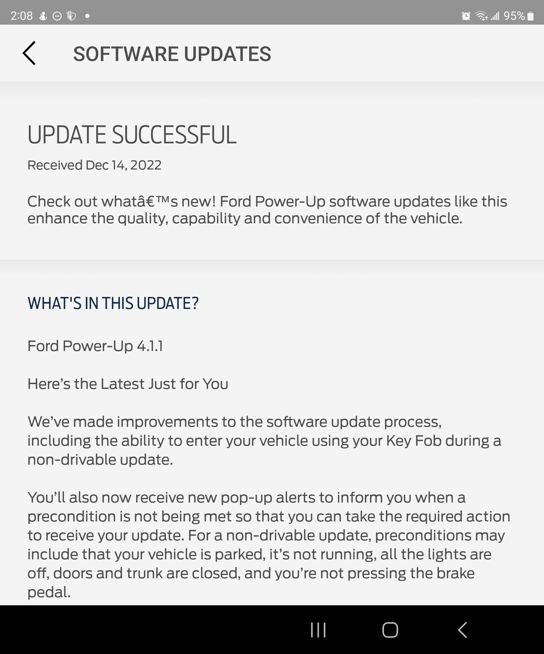

DTE Update installed this afternoon.
Hope to get the camera button update soon.
3,791
4,895
Also it looks like 4.1.1 just installed tonight.
