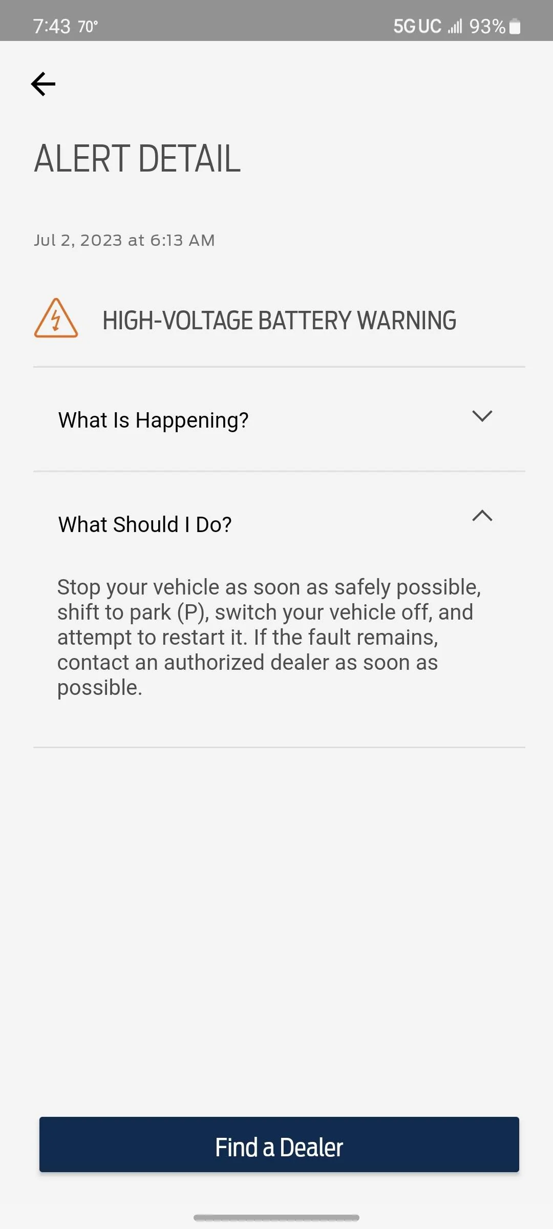

I received a two-for-one this morning; DCFC update and High Voltage Battery Warning. Tried a few power cycles with no luck then drove it 62 miles to work. I'm assuming it will fix itself by the time I get back to it.?
Update: it seems to have fixed itself. Hopefully it fixed the glitch.
