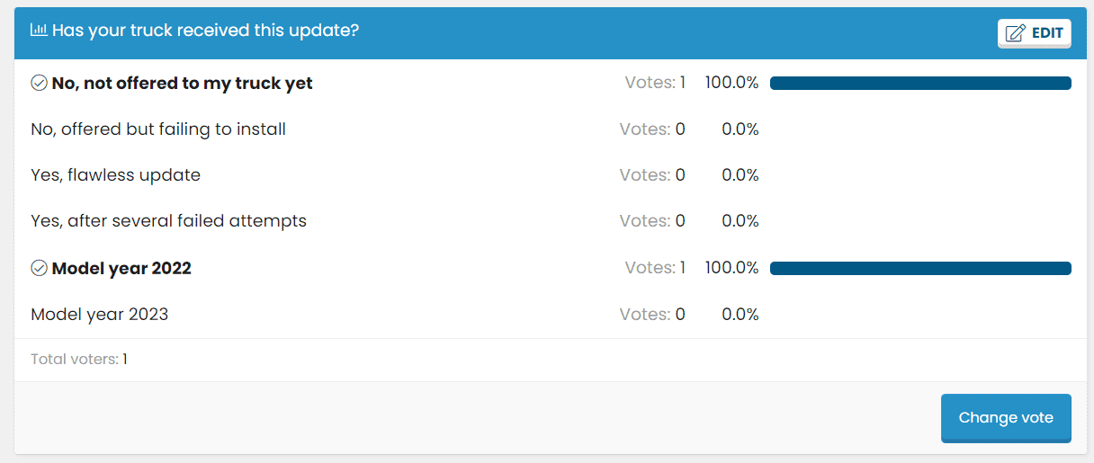

Created poll, pick a model year and an experience.
Amend/Edit your responses as needed
