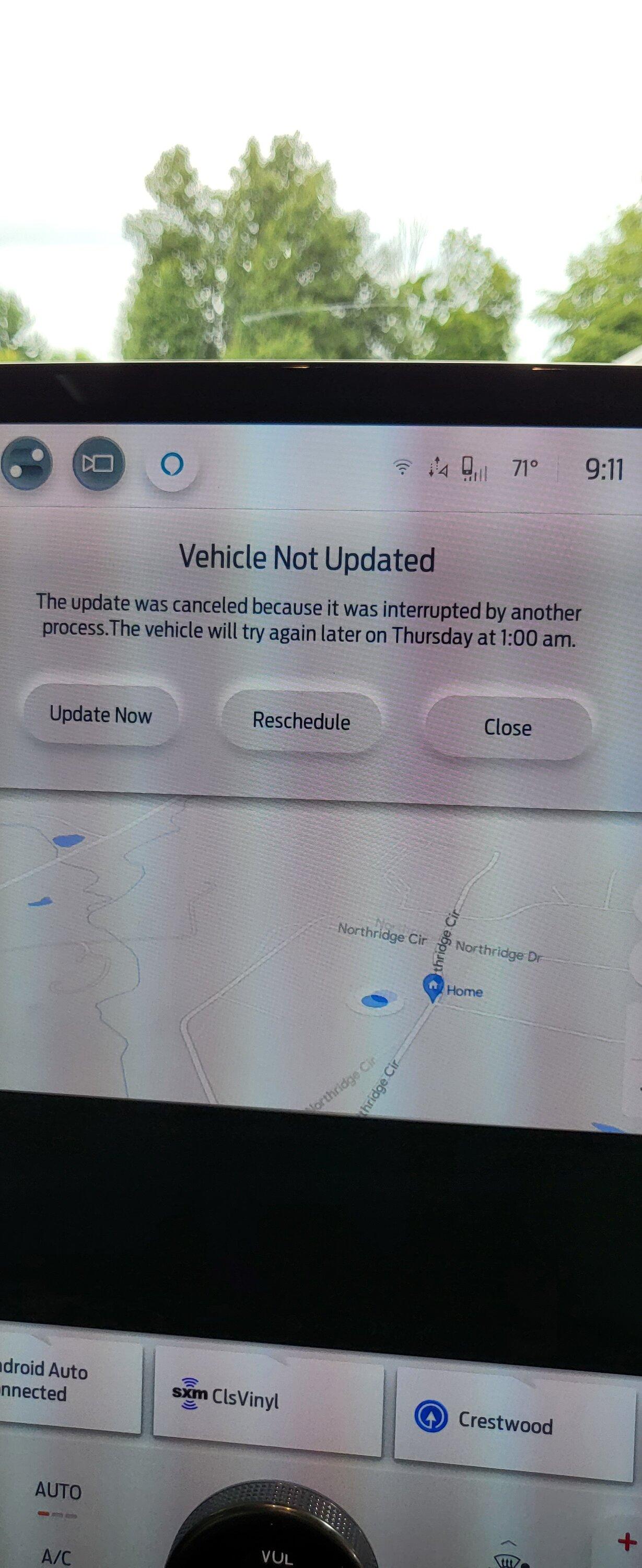

My truck has been trying to perform this latest update for the past three days to no avail. It comes back saying that it was cancelled because it was interrupted by another process. I have tried to force the update instead of waiting for the next scheduled time but still does not work. Has anyone else seen this issue or know what I should do to get the update to go through?

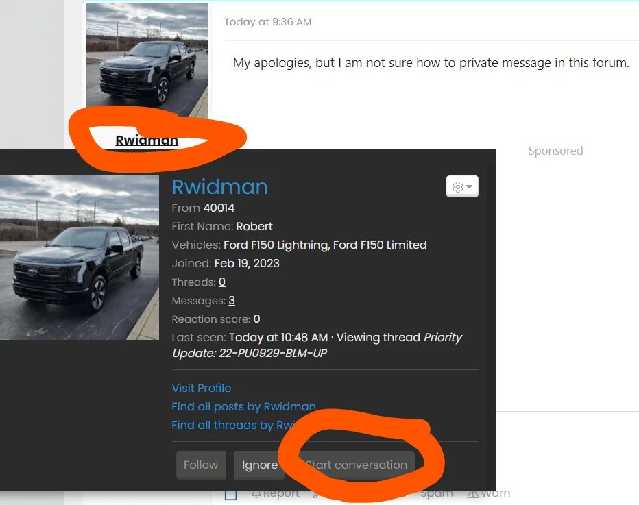

My apologies, but I am not sure how to private message in this forum.
Hover over or click the user avatar, wait for a popup you will see several options:

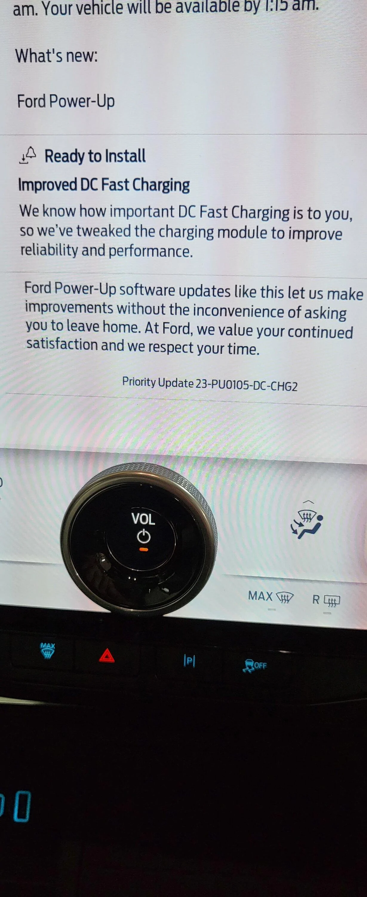

Ford F-150 Lightning Priority Update: 23-PU0105-DC-CHG2: Improved DC Fast Charging 1687449252136

I had it fail three times on Friday. I knew it was coming so I charged the 12V all night Thursday and verified it was over 80% before the first attempt. I got the same error you did but suspected I caused it by walking past the truck with the fob in my pocket. I verified the battery was still over 80%, kicked off the update again, turned off the headlights, locked the doors, and wrapped the fobs in aluminum foil and put them at the opposite end of the house. It failed again so I drove for 30 minutes and repeated the second attempt and got a third failure. I chatted with Ford and they had me do a connected services reset and told me it would update 15 minutes later. I left it for a couple of hours and then came back and this is the message on my screen now. I’ve only gotten two normal OTA updates, every other time it has failed or I’ve had to charge the 12V with and external charger. It seems like the OTA process is getting worse instead of better.
PAAK is a new problem for me... My PAAK started to actually work with a recent update, but now I've been fighting with the truck not updating. It's because our bedroom is above the garage and the truck sees my phone in range. So now this latest update I had to manually start it and have my phone further away. So far I'm not liking Ford's PAAK setup now that it works. I'll stick with it as it's nice to have, but I don't trust it enough to not have the fob with me (I know there's the code to start and drive, but..). The phone as a key thing was pretty quirky at first with Tesla too, but they eventually got it sorted and it's mostly flawless now. I'm sure Ford will figure it out eventually.

I must have a dozen messages now with failed attempts. My fobs are close to the truck in the mudroom, could it be that silly? I'm going to move them to living room and turn off bluetooth on my iphone. iphone short cut for 12v status reports 13v
two of my three failures happened with my fobs wrapped in aluminum foil away from the garage. I talked to someone at Ford and the response was that the precondition were not met and it would be pushed again. They would not give me further details on what precondition was not met.

I am in the same boat. Mine has failed more than a dozen times so far. I have tried charging it then doing it, driving for 30 minutes and trying, remote starting it and moving it and trying. Having no luck at all. Extremely frustrating.
