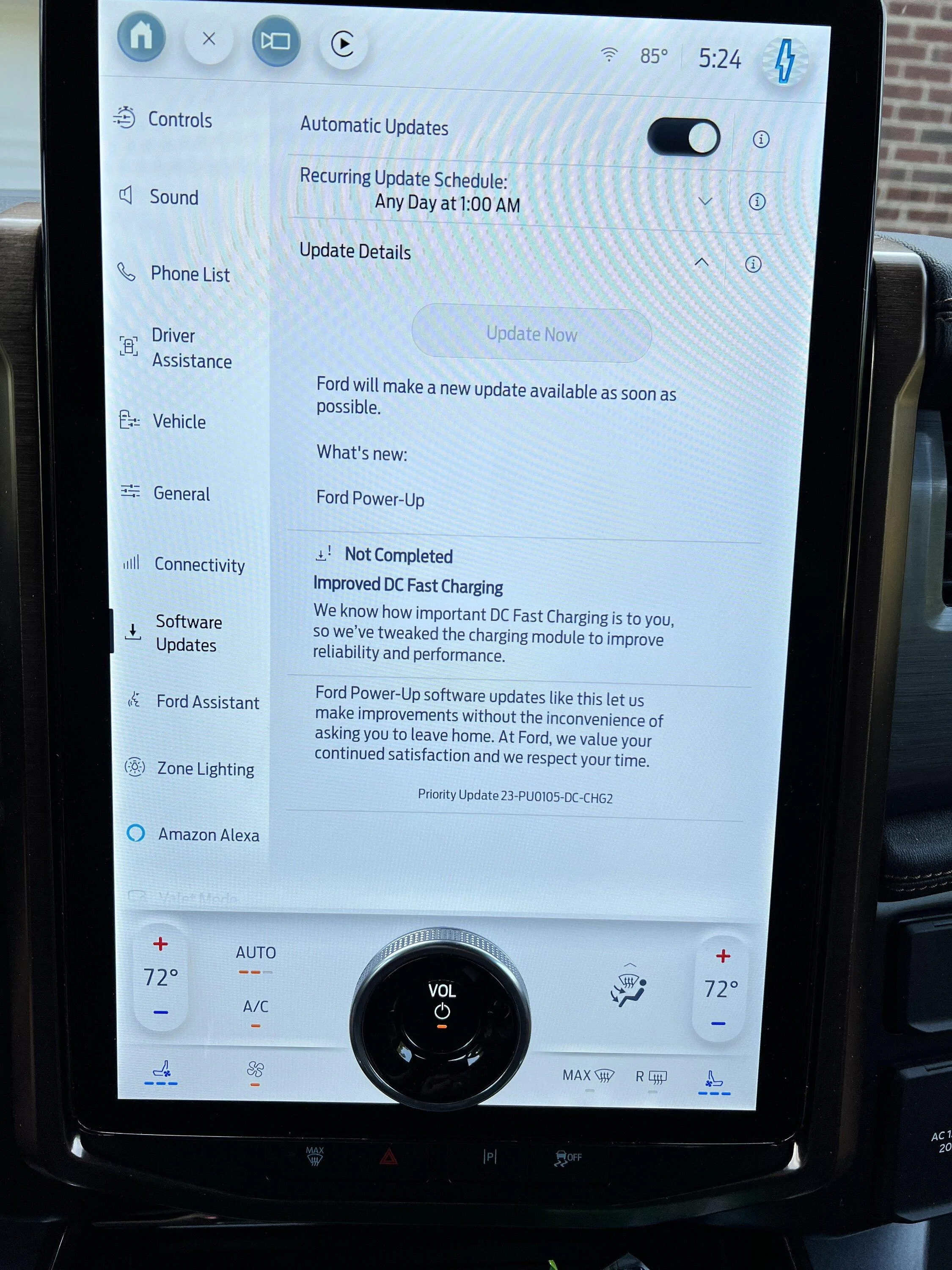

I had it fail three times on Friday. I knew it was coming so I charged the 12V all night Thursday and verified it was over 80% before the first attempt. I got the same error you did but suspected I caused it by walking past the truck with the fob in my pocket. I verified the battery was still over 80%, kicked off the update again, turned off the headlights, locked the doors, and wrapped the fobs in aluminum foil and put them at the opposite end of the house. It failed again so I drove for 30 minutes and repeated the second attempt and got a third failure. I chatted with Ford and they had me do a connected services reset and told me it would update 15 minutes later. I left it for a couple of hours and then came back and this is the message on my screen now. I’ve only gotten two normal OTA updates, every other time it has failed or I’ve had to charge the 12V with and external charger. It seems like the OTA process is getting worse instead of better.
Ford F-150 Lightning Priority Update: 23-PU0105-DC-CHG2: Improved DC Fast Charging IMG_0242
