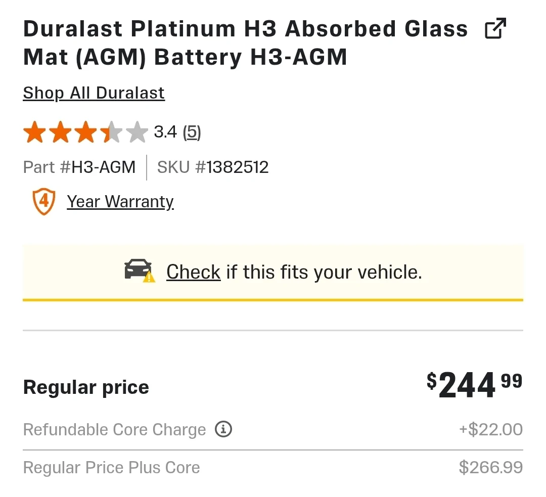

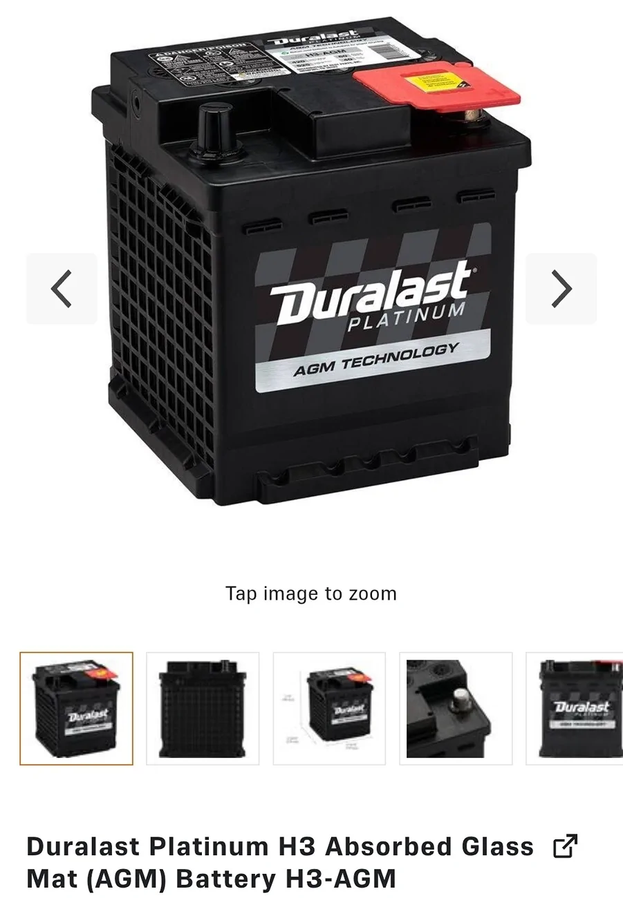

AutoZone sells a replacement.
Ford F-150 Lightning Size H3 starting battery replacements? Screenshot_20250923_175343_DuckDuckGo
Ford F-150 Lightning Size H3 starting battery replacements? Screenshot_20250923_175358_DuckDuckGo
