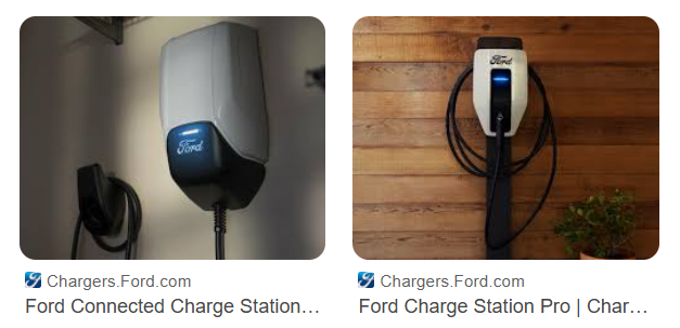

Is your electric vehicle service equipment [EVSE] a Ford Charge Station Pro or a Ford Connected Charge Station ?
Ford F-150 Lightning Suddenly charging at 3.3kw and not at 9.6kw 1757170816441-ez
Charge Station Pro

Charge Station Pro
OK, make sure to check what I pointed out in post #3, we've had a few folks, SELF INCLUDED find the setting derated for unknown reasons, make sure it's set to maximum value.
