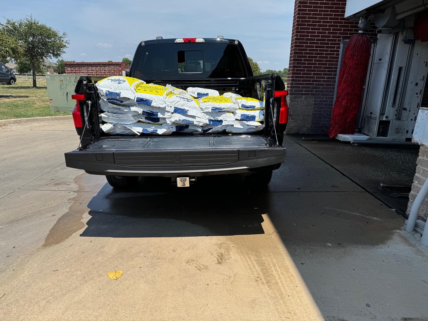

As somewhat stated before the main question as far as it being right for you is how far, how often and how much weight do you tow! First off, I will say that the lightning is a absolute beast when it comes to hauling. (I have not towed a trailer yet.) You barely even know you have anything in the bed and you have all the torque and power from zero(You can tell the truck is heavier, It seems to float a little more but you can still accelerate almost like you have nothing in it)
One major difference in these trucks and the ICE trucks is the independent rear suspension.
You are going to take a range hit with the bigger tires for sure and possibly a little with a lift.
It is almost the opposite of an ICE vehicle. As far as range is concerned, places where you have a lot of stop and go it regenerates and gives you a little extra juice but when you are on the highway, you get much less range because you are not getting any regeneration where in an ice vehicle you get less range in the stop and go driving and better range when you can just let it go down the road.

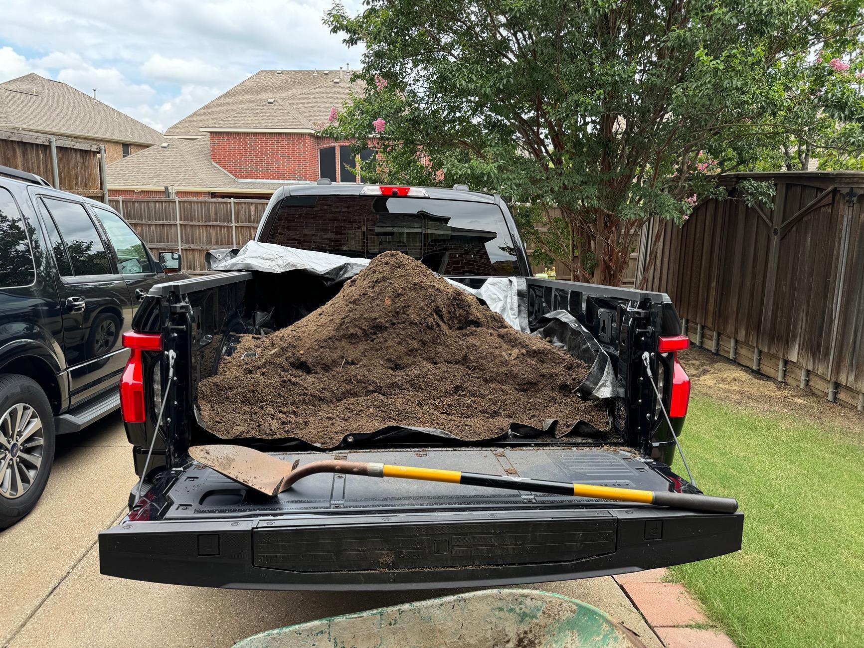

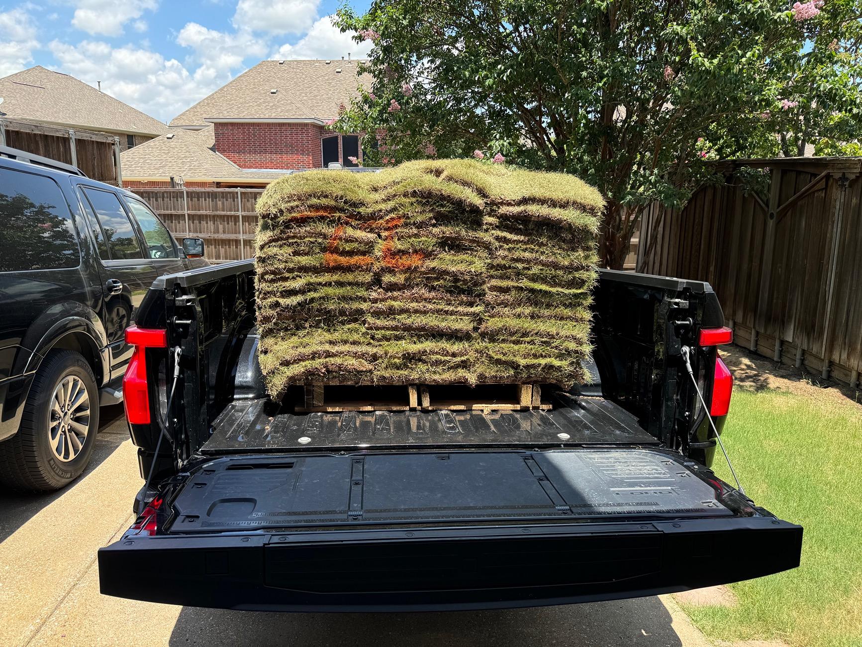

I don't haul bales, but I tow and haul other stuff all the time. I picked up about 7-8k lbs of flagstone yesterday in my dump trailer an hour and a half away and made it home with charge to spare... and only had 75% when I left home (I have a Lariat and an XLT, both ER, this was the XLTs day). It honestly tows better than any truck I've ever had, like there's nothing back there. We camp a lot and absolutely load the bed from the bottom to the top of the canopy (on the Lariat, SmartCap) and there is still plenty of suspension travel. I put burly tires (Mickey Thompsons) on the Lariat and did lose some efficiency, hard to say how much but I'd guess 8-10%. The XLT has the stock 'smooth' road tires and definitely outperforms the guess-o-meter regularly. We have 2 properties, one of which is down a gravel road, up a mountain, and all 'off-road'; we raise sheep, goats and alpacas, and this is a truck like any other truck, capable of doing things any other truck in its class can do, and mine are dirty and offroad more than they are clean and at the mall, that's for sure! I bet you'd love the truck, and I'm sure it'd work for you, although as others suggest, you may want to consider a trailer for those bales rather than tossing them on the power tailgate...
Cheers, good luck, no regrets.
