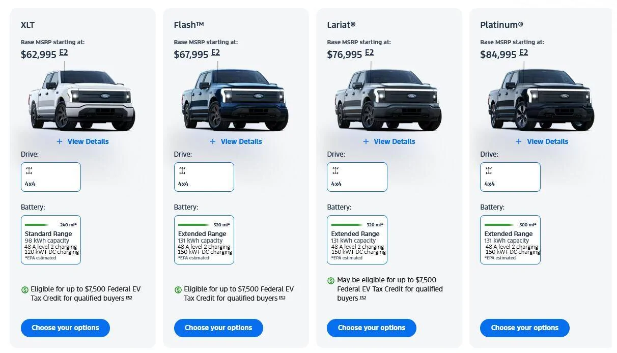

To me the problem is the information out there very boldly proclaim 80A as a feature (as it is beefy and industry leading when it was released) and most people are still actively out there talking about the older trucks and trying to figure out if they need/want 80A or less.
I can point to two specific places it needs to be if I were in charge, representing due diligence on top of press releases:
This:
Ford F-150 Lightning Ford Charge Station Pro -- only 10KW 1726579482313-if
Should be this:
Ford F-150 Lightning Ford Charge Station Pro -- only 10KW 1726580444408-co
