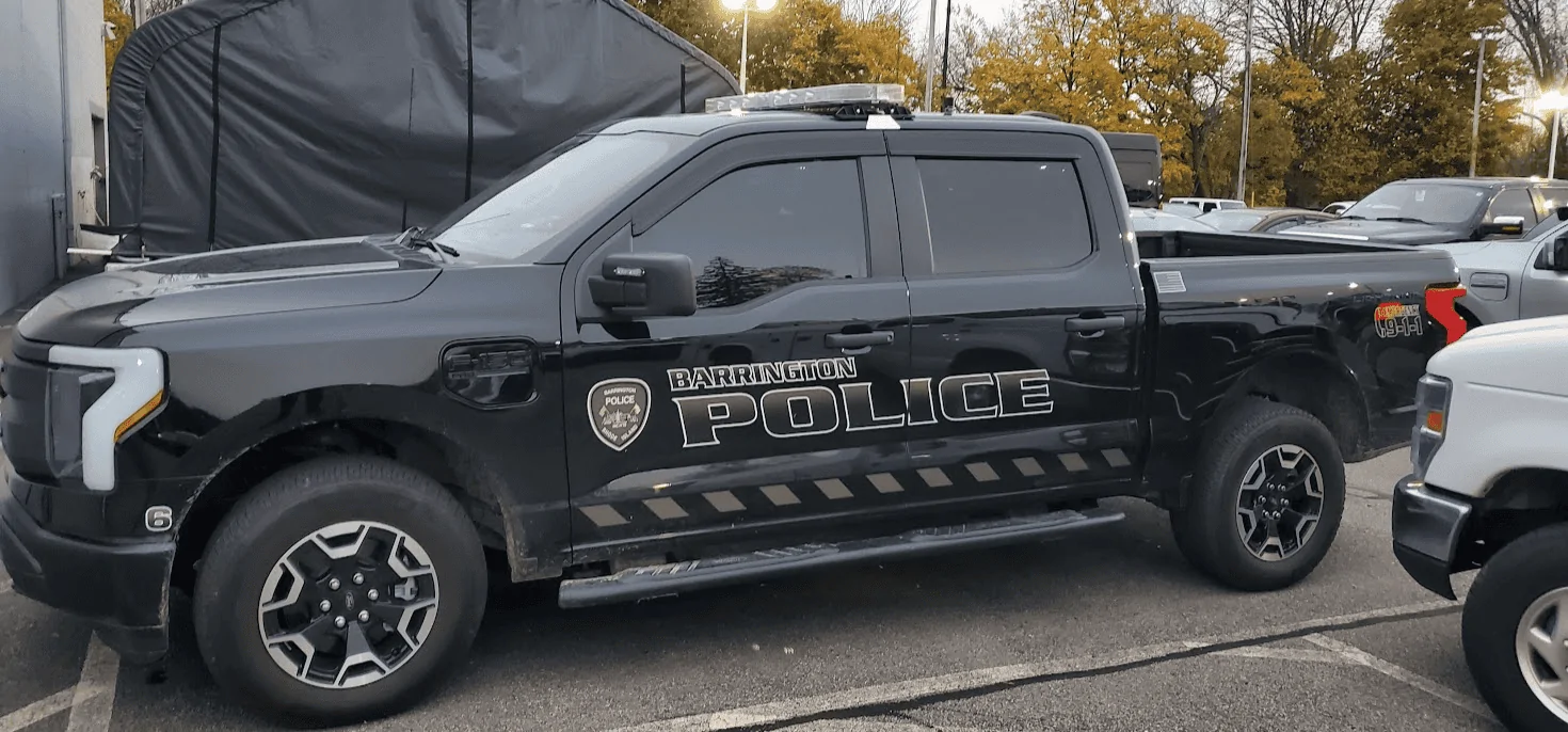

My Lightning is in now, noticed this Pro Police Edition also in for service, I'm parked right behind it.
My Truck location signal shows they moved it into the workshop already!
Here's hoping everything is smooth and quick!
