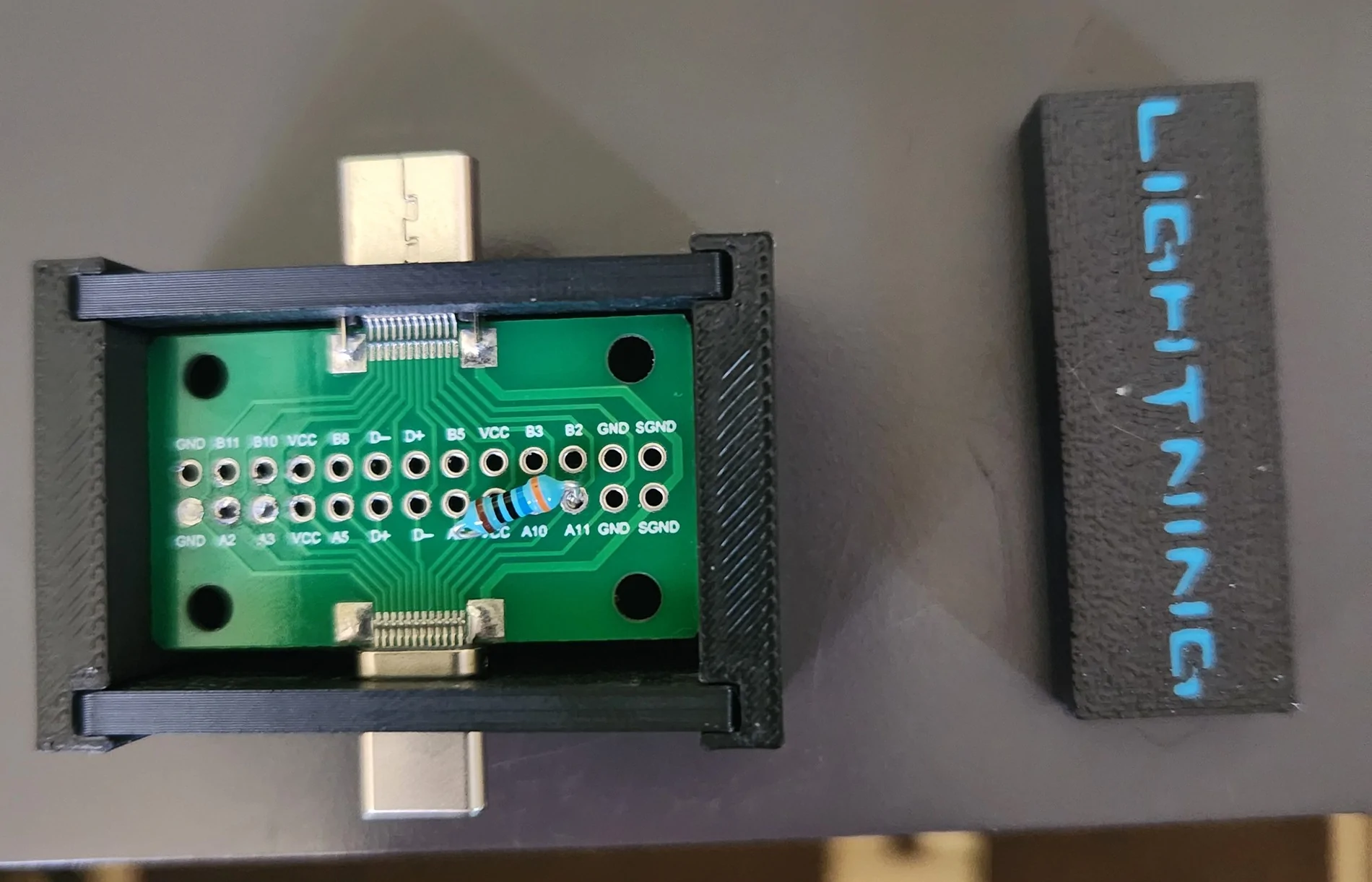

yeah just one 360 ohm resistor soldered on the board between A10/A11. Resistor side goes toward the comma when hooking it up. I'd just mail you the one I was using but I'm 2 hours away from it and won't be back there for a week or two.

If you have a soldering iron, you can create a temporary board to stop the startup errors while you wait. Left is the temprary one I was using in a 3d printed case and right is @UncleTony's.
board- https://www.amazon.com/dp/B0BWXKV8DB
resistors- https://www.amazon.com/dp/B08QR3GDPC
You can add a touch of glue to the inside male side to keep it from pushing into the case. You can also heat the top side wire of that resistor to get the solder to flow into the hole. You may end up with a weak solder joint if its only holding the resistor in on the bottom.
ha. I had planned on adding more solder after I made sure it worked but got lazy and didn't feel like unhooking it. And I knew I had your fancy one coming so didn't need to last long. 😁
