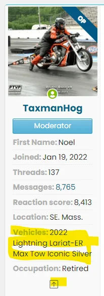

I would help if we standardize how we describe our lightnings on the profile vehicle data fields and / or the signature.
