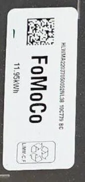

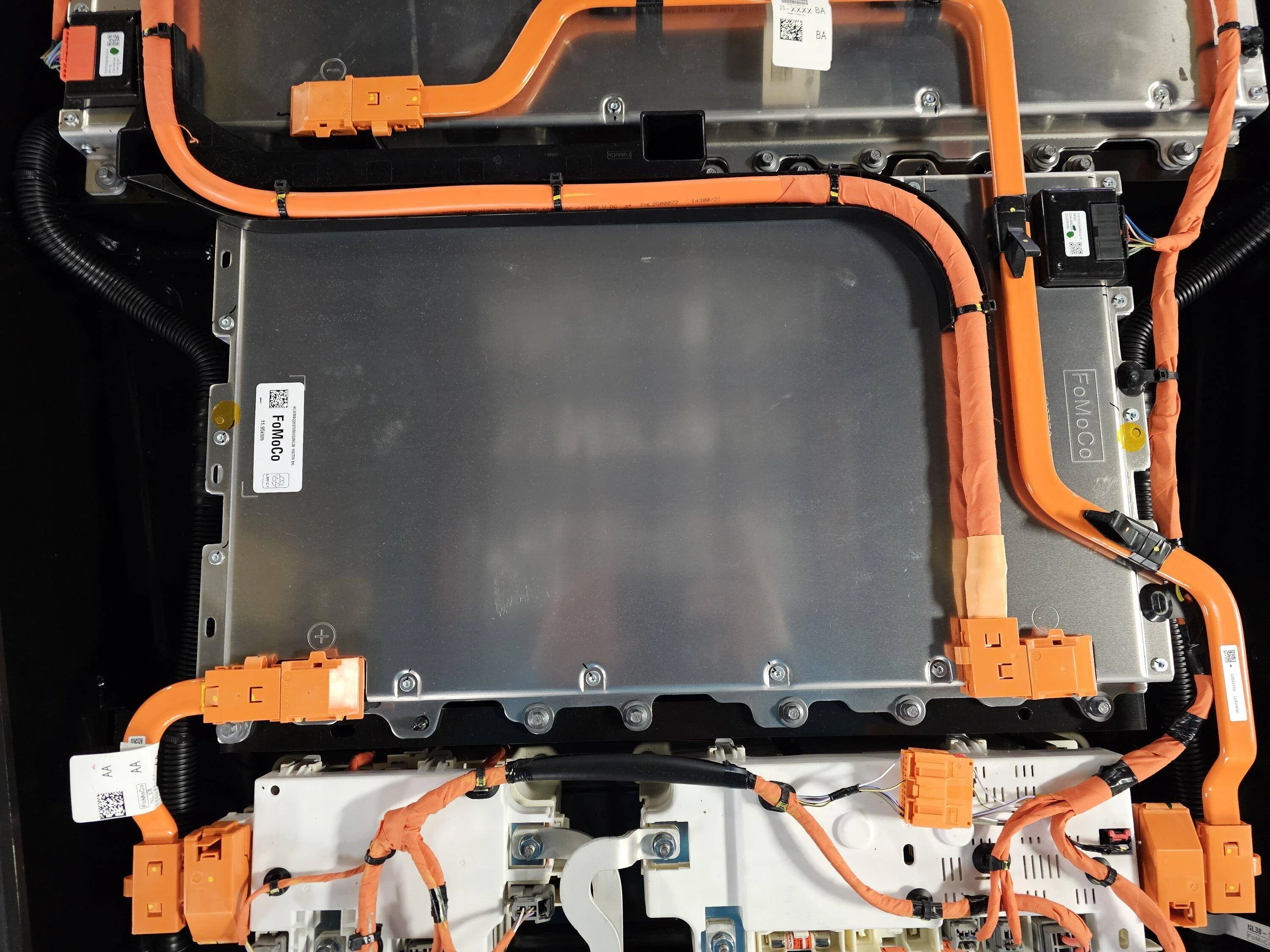

Module 9 is ~10 kWh {net}, it's likely the module they eliminated, leaving the other 8 large modules at ~15.25 kWh.
Note from the link above the photo of module 9 shows the gross capacity of 11.95 kWh, but that's NOT available due to BMS limitations.

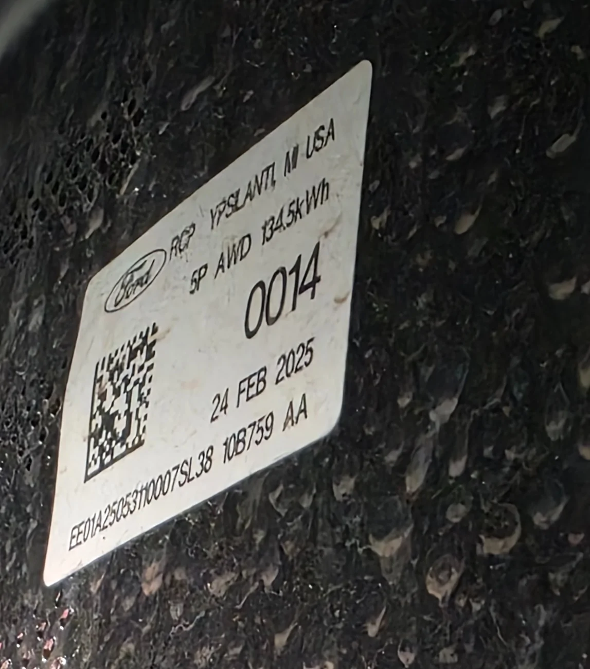

The 25 Flash has a 123kWh battery advertised, the real size is shown on this sticker from my truck, also a 25 Flash.
