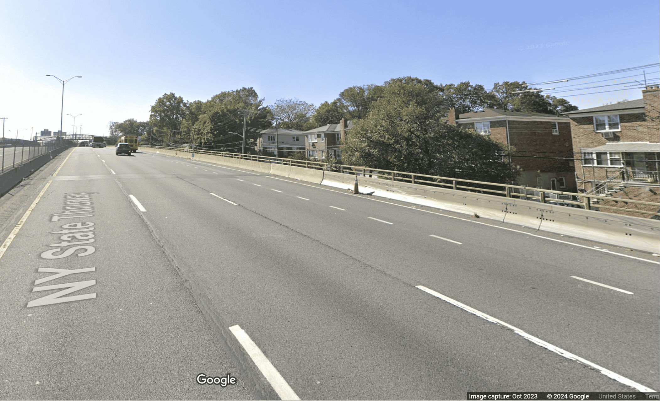

On the safety, I think my late message was not very clear. I see how it came off that I drove a smoking vehicle until I found a "good spot". To clarify, that was NOT the case and I did what was best in the situation. I always like to be prepared, work in an industry where we have to deal with crises (not physical), and have practice dealing in vehicle emergencies (from track days and having had cars with failed brakes too many times :)). I pulled over as soon as it was even remotely safe to do so. I know how these things go and its why the second I was stopped, I grabbed the dogs and ran 100 feet away. At the time, my assumption was this was an EV fire and those can turn from smoke to full on blaze in seconds.

Also, here is a shot of where I was and the "breakdown lane" and lack of ability to get off the active highway.
