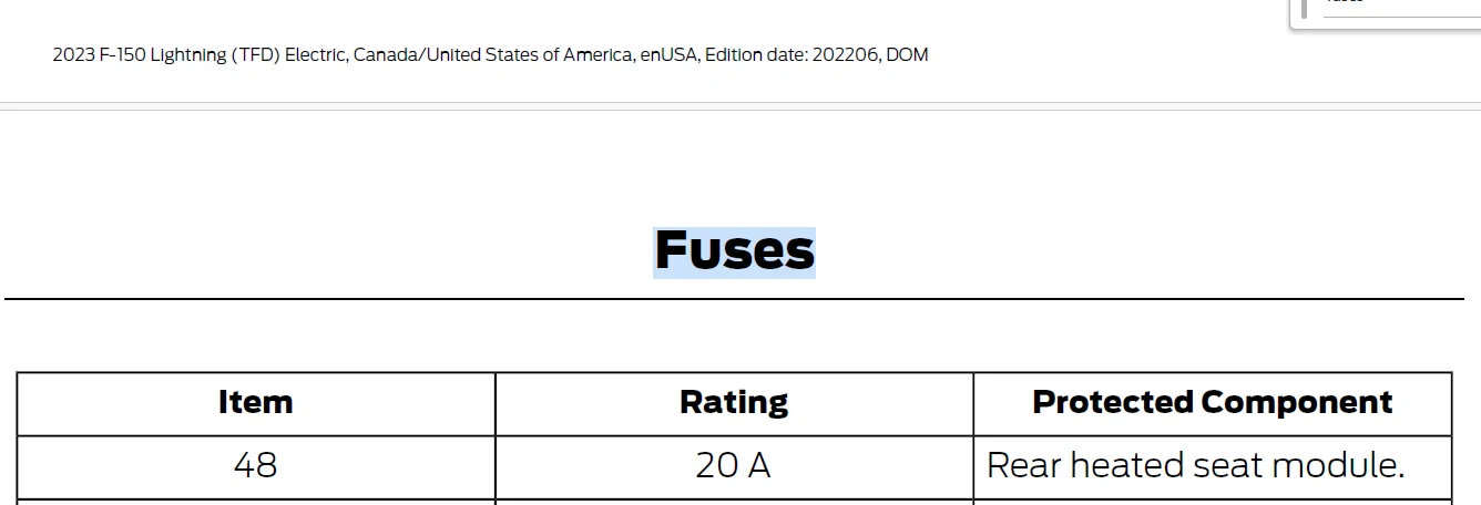

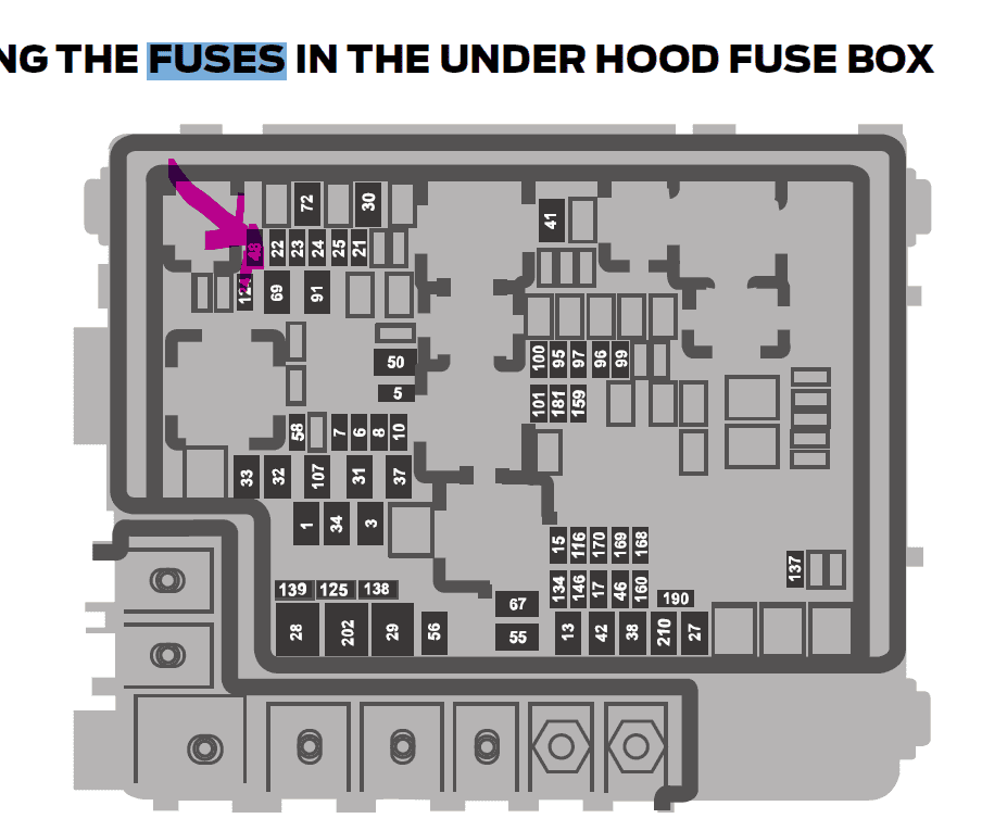

Man I hope you, your wife and the dogs recover physically and psychologically. Dogs can suffer emotionally. Our dog was reluctant to get into a car after we were t-boned by a meth head a few years ago. My wife and I had to go to the hospital in an ambulance and we left the dog with a stranger until a friend could come and pick her up.
Last week I pulled my back out, I took a Tizanidine muscle relaxant pill prescribed by the doctor. One hour later I pulled over and told my wife I didn’t feel alert enough to drive. She got into the driver seat and I got in back with the dogs In the seat behind the Drivers side. Immediately I said holy poop this seat is so hot. I looked and one of the dogs seemed to have hit the seat heater button with her paw.
Now after reading your saga I want to find a way to safely remove power to the rear seat heaters To prevent unanticipated activation. Here in Florida rear seat heaters aren't necessary. Hopefully a single fuse or relay that powers the heaters. .

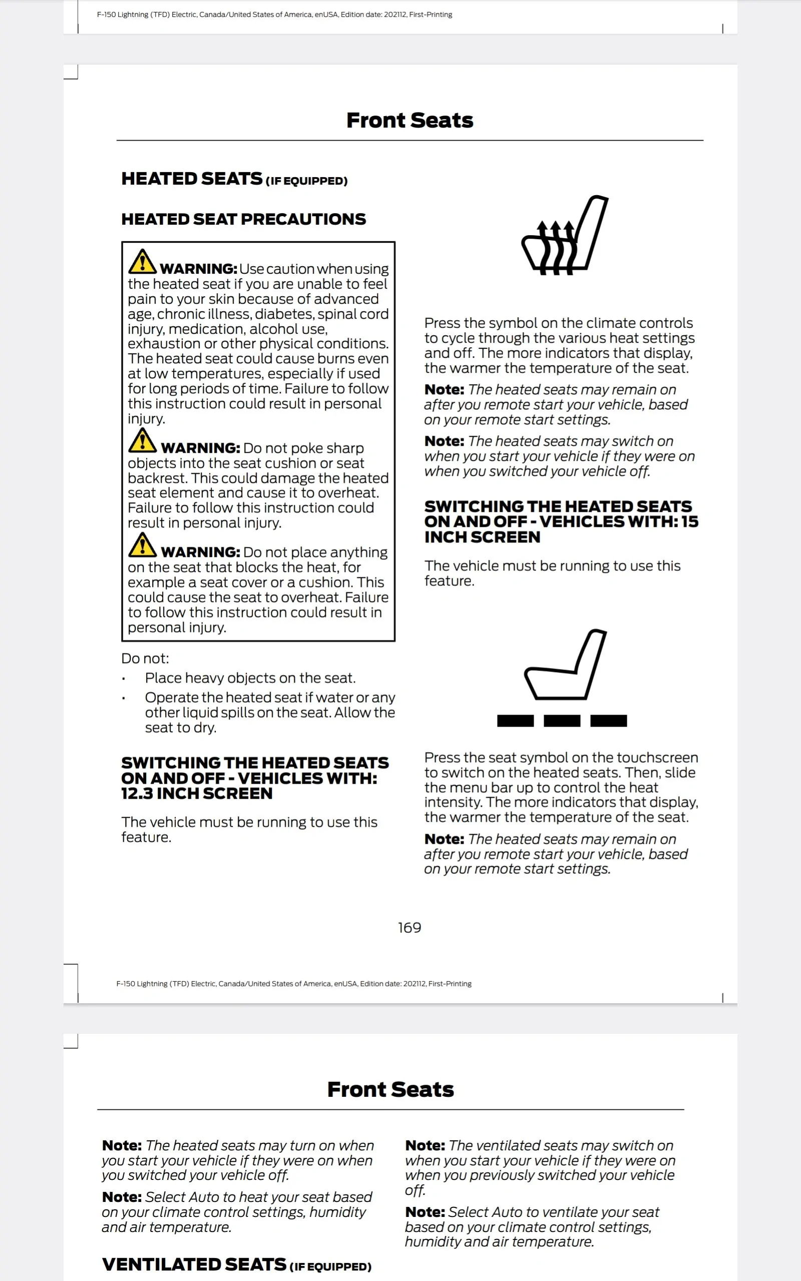

Note the following warnings in the manual. Any apply?
Ford F-150 Lightning Caution using heated seats, rear heated seat fire, [Not an EV Fire] 1000003053
