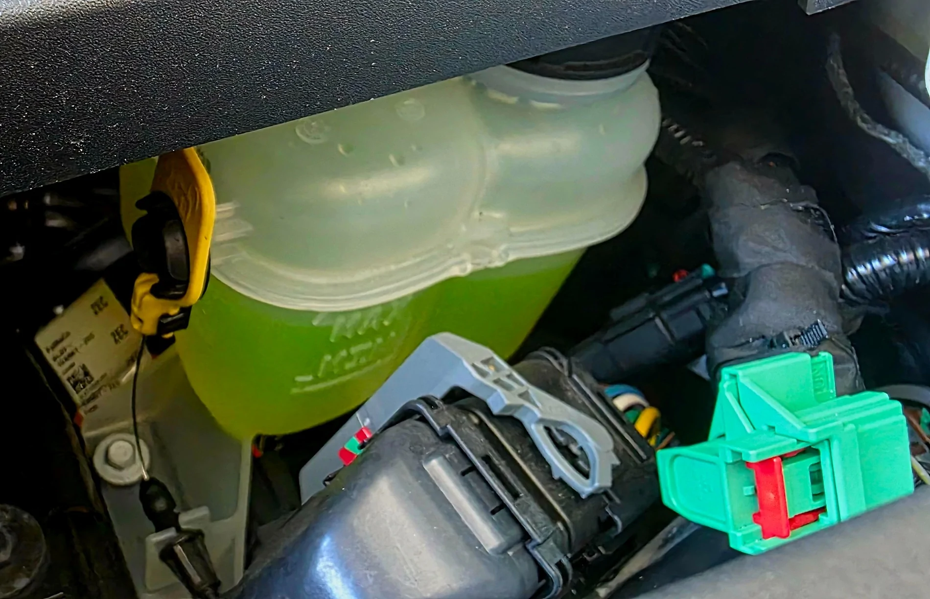

Thanks to a previous post here about low coolant, it was on my mind. So when I heard the coolant pump sounding a little funny upon starting a charge, I decided to go and check mine. 2024 Lariat with 10k miles. Well, it was incredibly low. With Ford’s love of dings, you’d think at this level I’d get a persistent ding… but nothing. No ding, no yellow light, no error code at all. Maybe there’s not a sensor in the coolant tank?
Went by my dealer and picked up some coolant. Topped it off, and now I just hope it was trapped air. I’ll keep an eye on it and maybe even schedule a service just in case.
Even with a new Lightning, it’s a good idea to check the coolant to protect your precious battery!

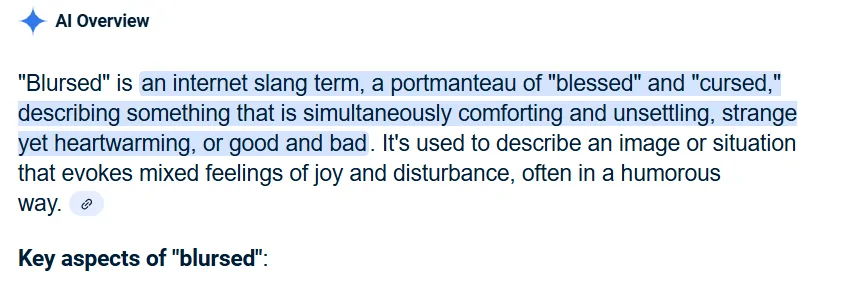

I call the stuff blursed Mountain Dew.

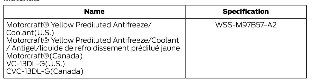

Is this a special coolant or something that can be picked up at any auto parts store?
The Motorcraft coolant or a compatible equivalent:
"The correct coolant for a Ford F-150 Lightning is the Motorcraft Yellow Prediluted Antifreeze/Coolant (part # VC-13DL-G for the U.S.) or a compatible equivalent that meets the Ford specification WSS-M97B57-A2. This is a yellow, Phosphated Hybrid OAT (P-HOAT) type of coolant."
Prestone says/guarantees their universal/all vehicles yellow coolant is compatible with all types, for what that's worth.
And Ford says "WSS-M97B57-A2 (Prestone YA992) is yellow coolant. Yellow coolant may appear fluorescent green in some cooling systems which is a normal characteristic."
https://www.fordservicecontent.com/...F&div=f&vFilteringEnabled=False&buildtype=web
AI says that: YA992 is a part number for a 55 gallon drum of their all vehicle/universal coolant.

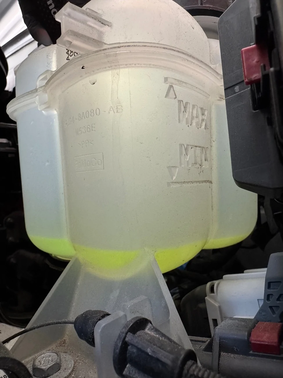

Looks like my dealership took care of any fluid concerns.
